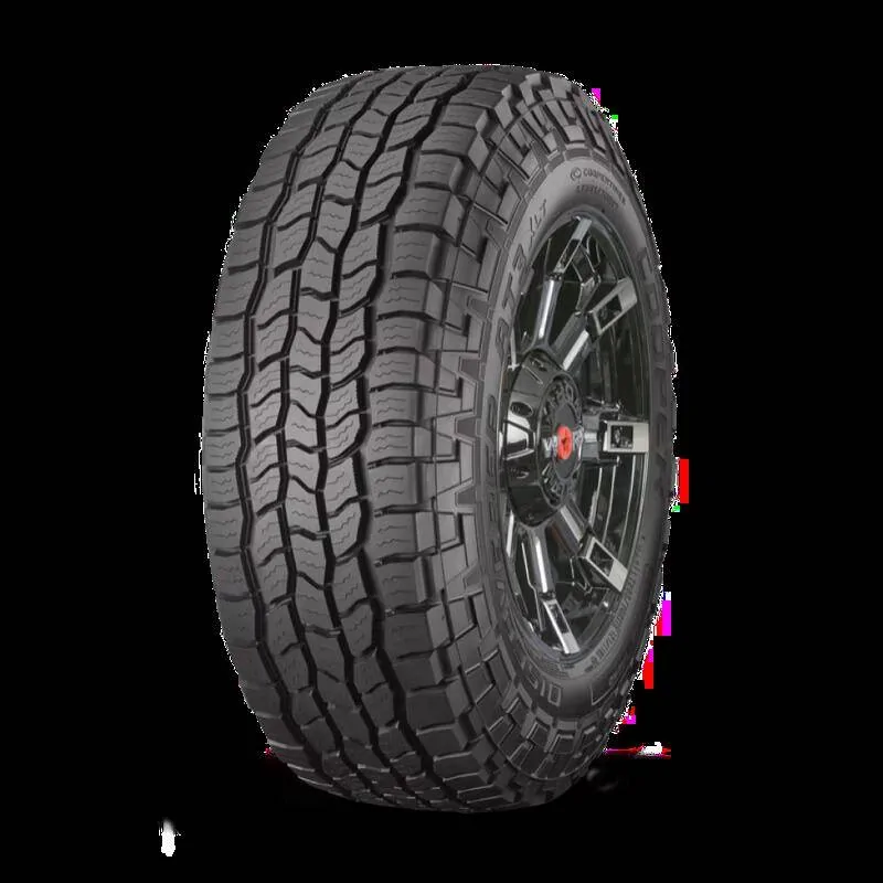

take a look at cooper tires Discoverer® AT3 XLT™ i had them on my 1996 ford Bronco for 12 years. never had a problem on my bronco. had them on my jeep overland for 25,000 miles with no problem. they are great on road because of the tread design, works great for wet roads and is pretty good off road.

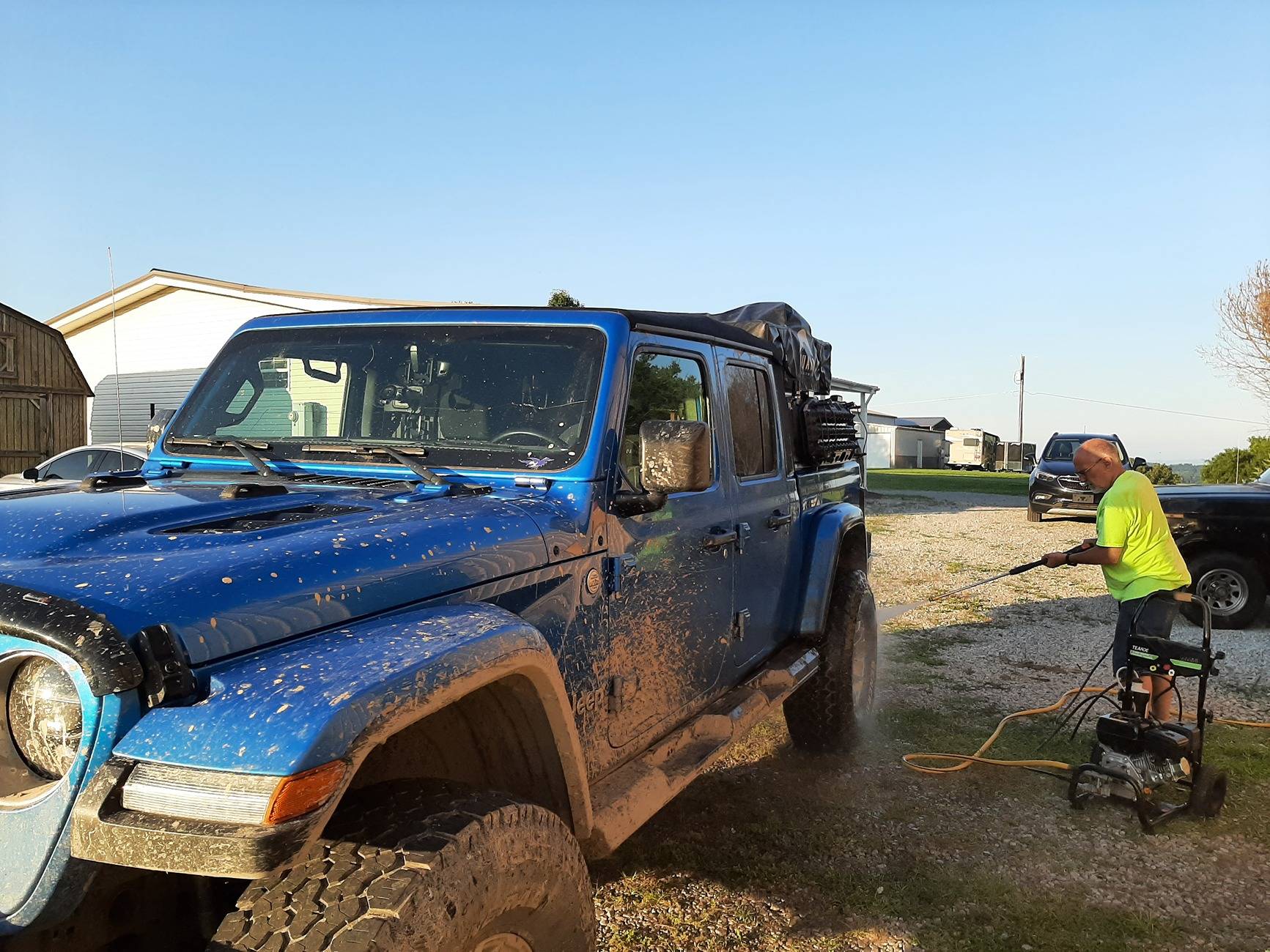

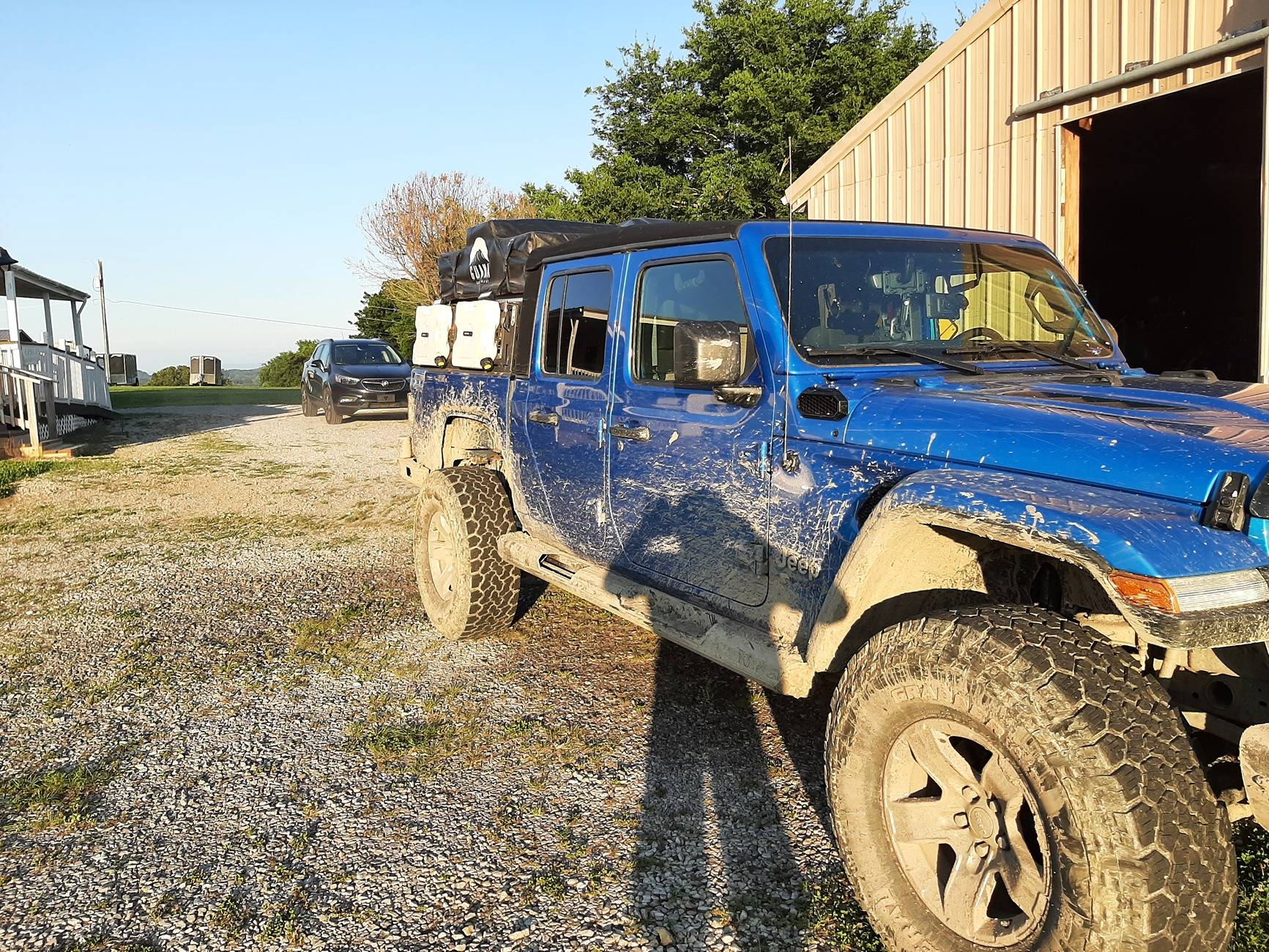

i will politely disagree with you. I am running General tires ATx on my jeep and this is what the tires did for me in the middle of Tennessee, lost in the middle of Windrock Park during June of 23 and my uncle was loving every bit of what we had to go thru. unfortunately, my uncle lost all of the pictures of me that he took after I stuck the jeep and had to winch it out as I did, I fell into the mud. is it not what this is all about is the fun.
