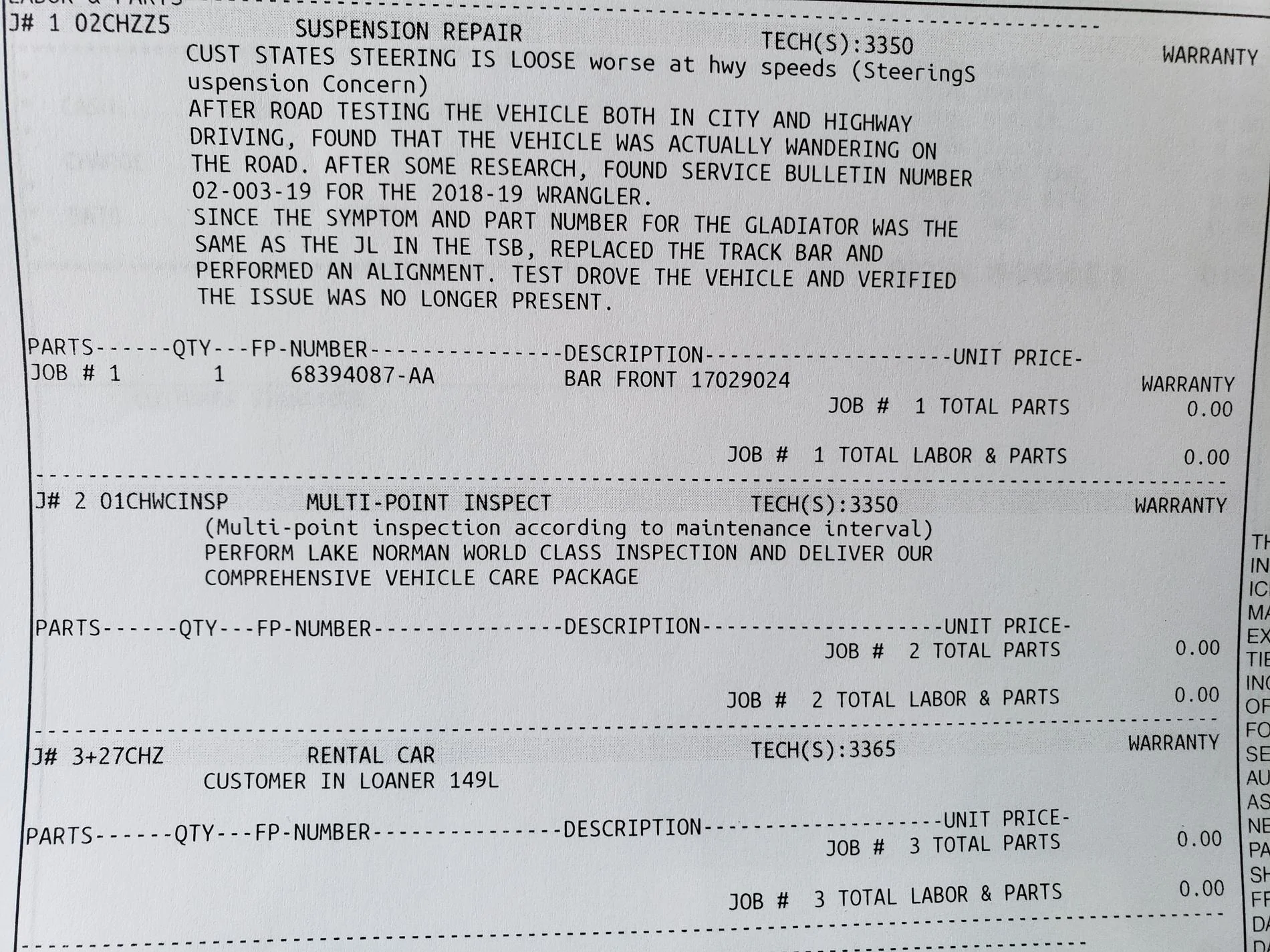

My second dealer trip has resulted in a track bar replacement. I will be picking it up this afternoon and will report back. Wonder if this goes along with the track bar bolt that has been previously mentioned as well as the housing that bolt would screw into. Hopefully once I drive it, there will be some more good news headed this way!
I mentioned to them on their test drive of my JT that I thought it might be the steering box. They definitely agreed that there was a lot of play in the steering. I then drove another one from their lot and it had much tighter steering. Not perfect, but much better than mine. They said that they could use that one to compare with mine. And the conclusion from them was the track bar needed to be replaced. Mine is the Overland and the other one that I drove was a Sport.

So it seems the track bar fixed it to about 90 percent. It steers muuuuuuch better than before. They used a service bulletin for the wrangler. I am now pretty happy! It could be a little better, but like I said muuuuuuch better!

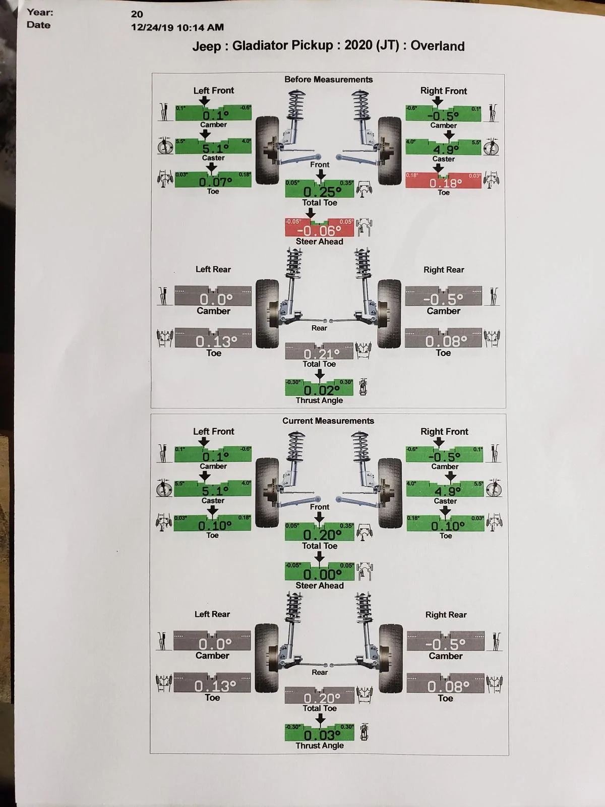

Do you have the pre and post alignment sheet? I would be interested in those numbers, wandering if that also helped you issue. Glad you have a resolution!
40,500
54,020
Camber is set in stone and caster as well as caster difference between sides is also set in stone.
Toe is all that can be set.
Track bar changes won't impact any alignment other than toe.
That's required after any track bar changes. (because it may shift the axle to one side or the other from where it was impacting the steering linkage.)
