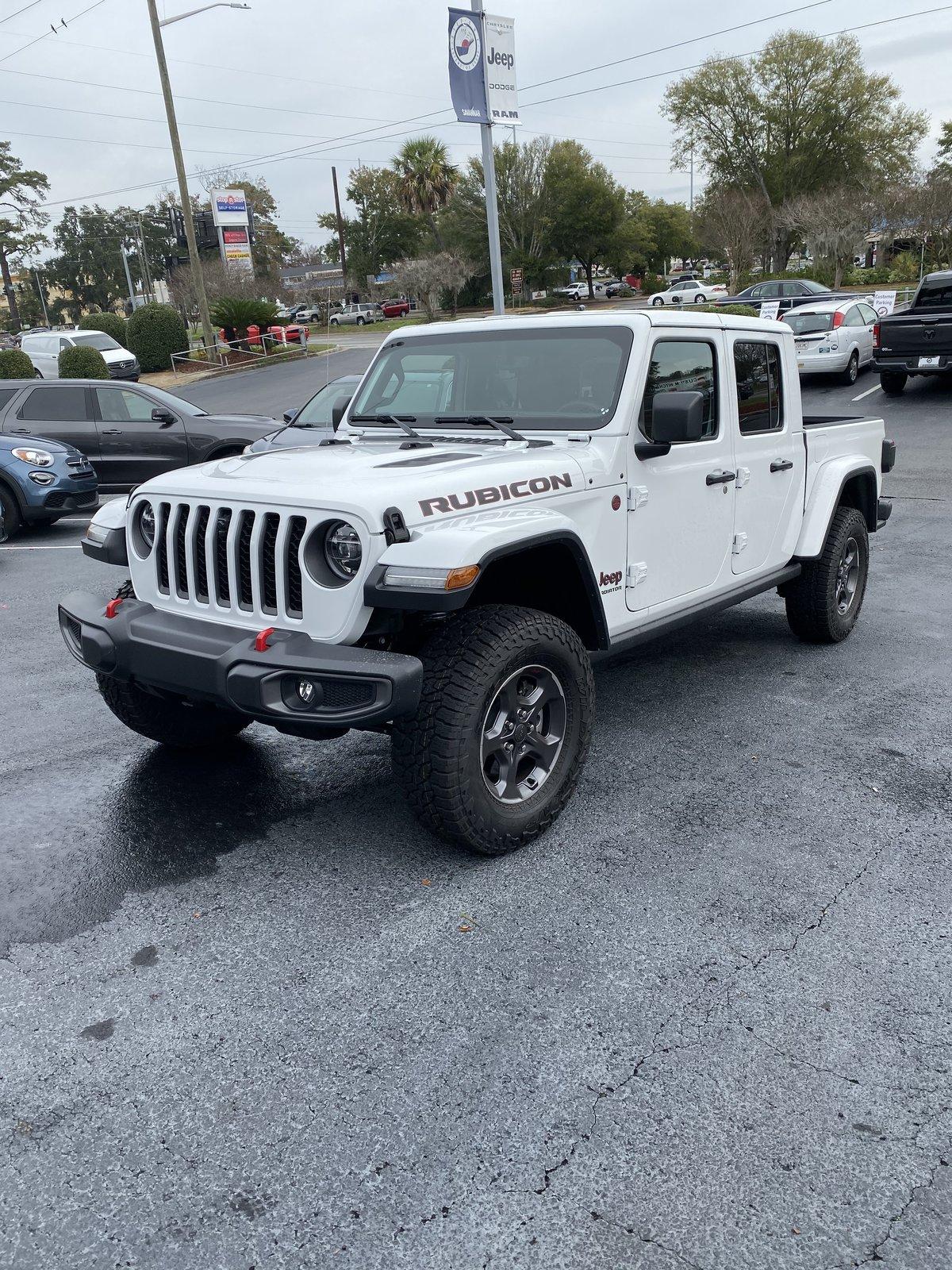

Just picked up a Gladiator Rubicon today.
Build date 10-19
I noticed some play in the steering on the test drive at low speed but thought it was just me since my DD is a Porsche.
Then my wife took the truck for a drive and she comes home and immediately complained about the steering..so here I am on this thread. Only on page 5 catching up so just me reinforcing that Jeep needs to find a fix.
Not the ownership experience I was hoping for on day one JEEP. BTW traded a 2005 Wrangler for the Gladiator so not my first Jeep, in fact my 4th.
