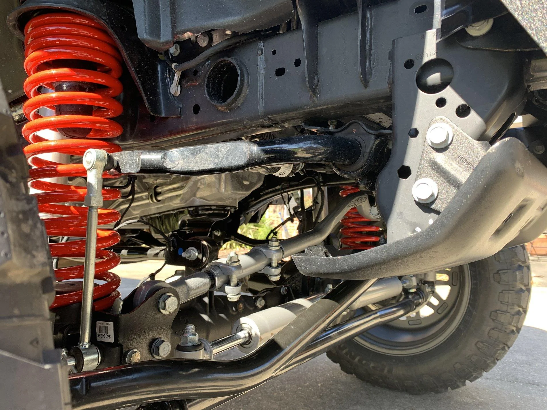

I am also FED up with my 2020 JT, will be making a trip to my local dealer Monday to beg for some help. I’m to the point of going trade this death trap in.
Let us know how it goes, I'm in the same boat as you. I'm ready to move on to something else also. Plan on taking mine back next week again, still think it needs a steering box without all the play.
let me get this straight... did it drive like crap before you did the RC lift or after??? If it’s after, your cause is the lift and need to get all the parts to make it better. If it was before, a bad lift will make it a ā€œdeath trapā€. IMO
I’m surprised that more owners have not taken this issue to the. Consumer advocate reporter at their local newspaper and TV station, along with reporting it to the federal safety board as suggested elsewhere in this thread. Having an aftermarket lift will probably be a factor that works against the owner as it is just an easy scape goat for manufacturing issues. But if you have the mopar lift installed by your dealer and it has the issue it at least keeps the focus on the dealer and FCA to address the problem. There is plenty of anecdotal evidence in this forum and I have heard from friends who have rented JTs with horrible steering so it shouldn’t be hard to put together a good story that will garner plenty of attention when it goes to press.
