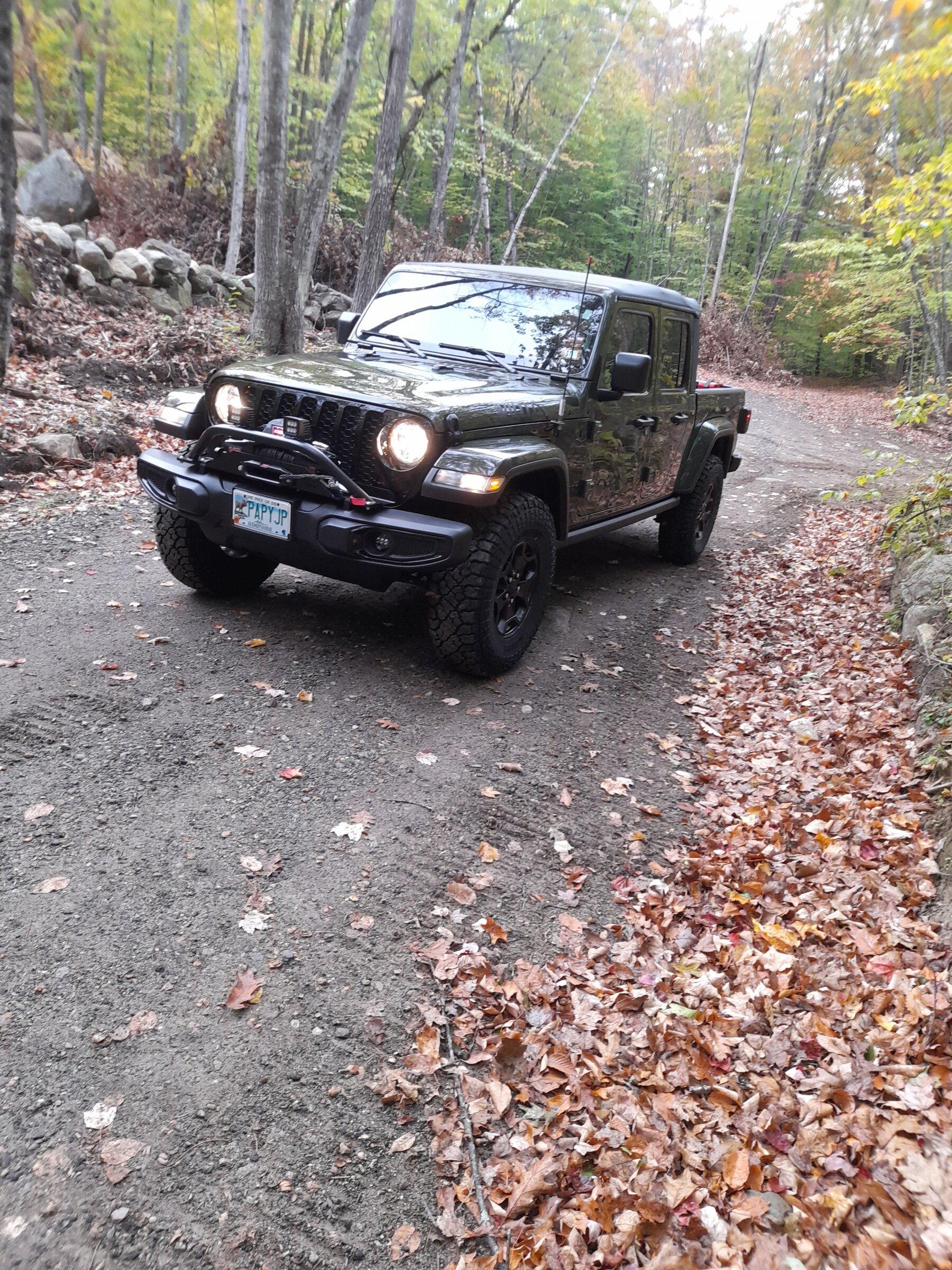

Living in lakes region NH and having experience with both snow and ice I would say a limited slip is the way to go in those conditions.Locking diffentials are too extemes at speed and grab at cornering ,open diffs leave you tractionless and wheels spinning. I have heard of locking differentials making the backend loose traction and spin the vehicle around..not good!
Jeep Gladiator LSD Equipped Gladiators Better Than Rubicon in Snow ? 20211021_171650
