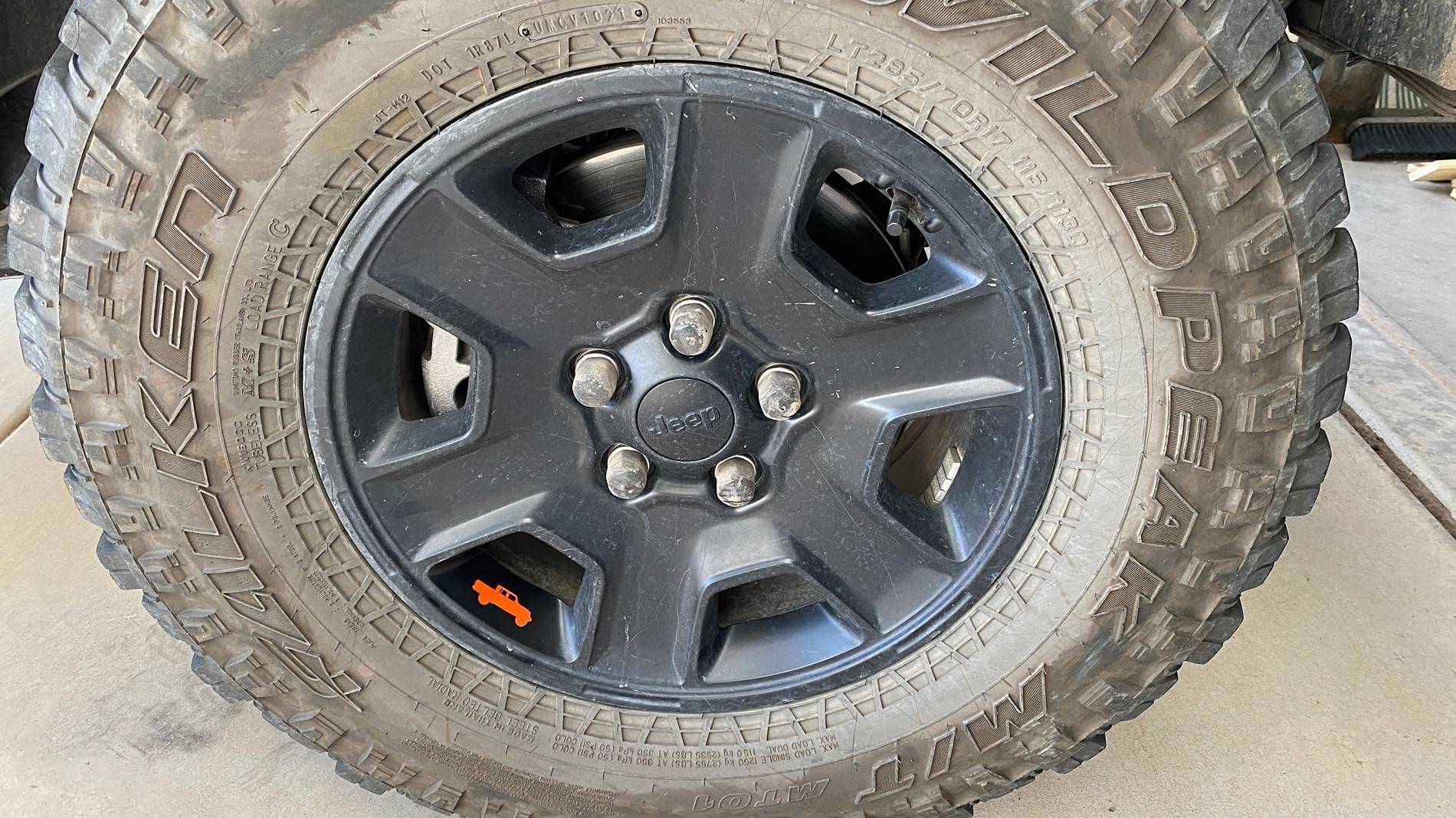

I covered mine with these. No issues with my lugs yet.
ColorLugs Vinyl Lug Nut Cover | Black | Flexible Fit Wheel Lug Nut Cap | Fits 21-23 mm | Pack of 25 | Includes Deluxe Extractor | Made in The USA

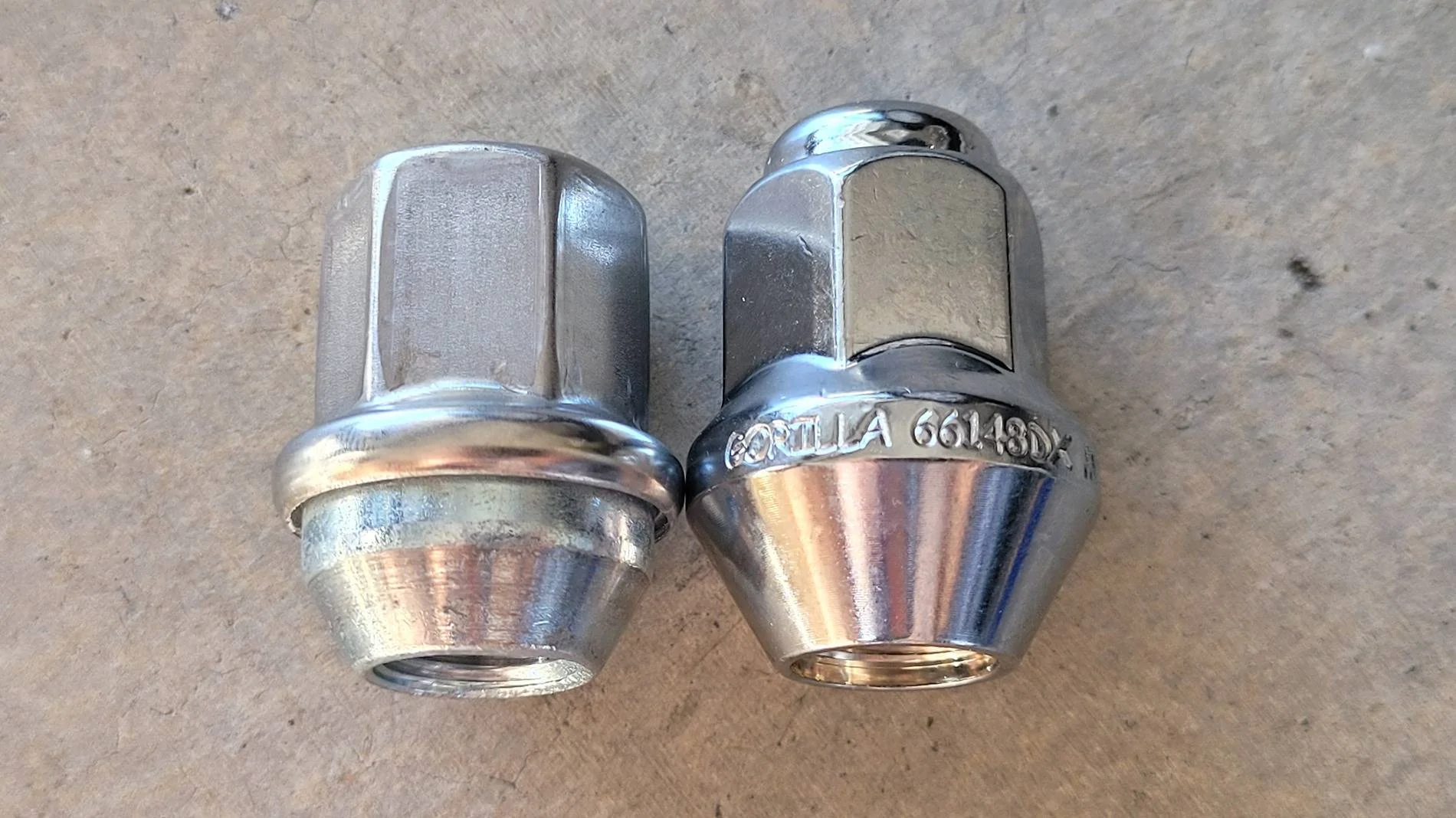

Gorilla 66148DX. The black ones are 66148BDX. They might be listed for Ram Trucks instead of Jeep. They fit perfectly fine.
Jeep Gladiator Lug nuts for stock wheels 20230813_160841

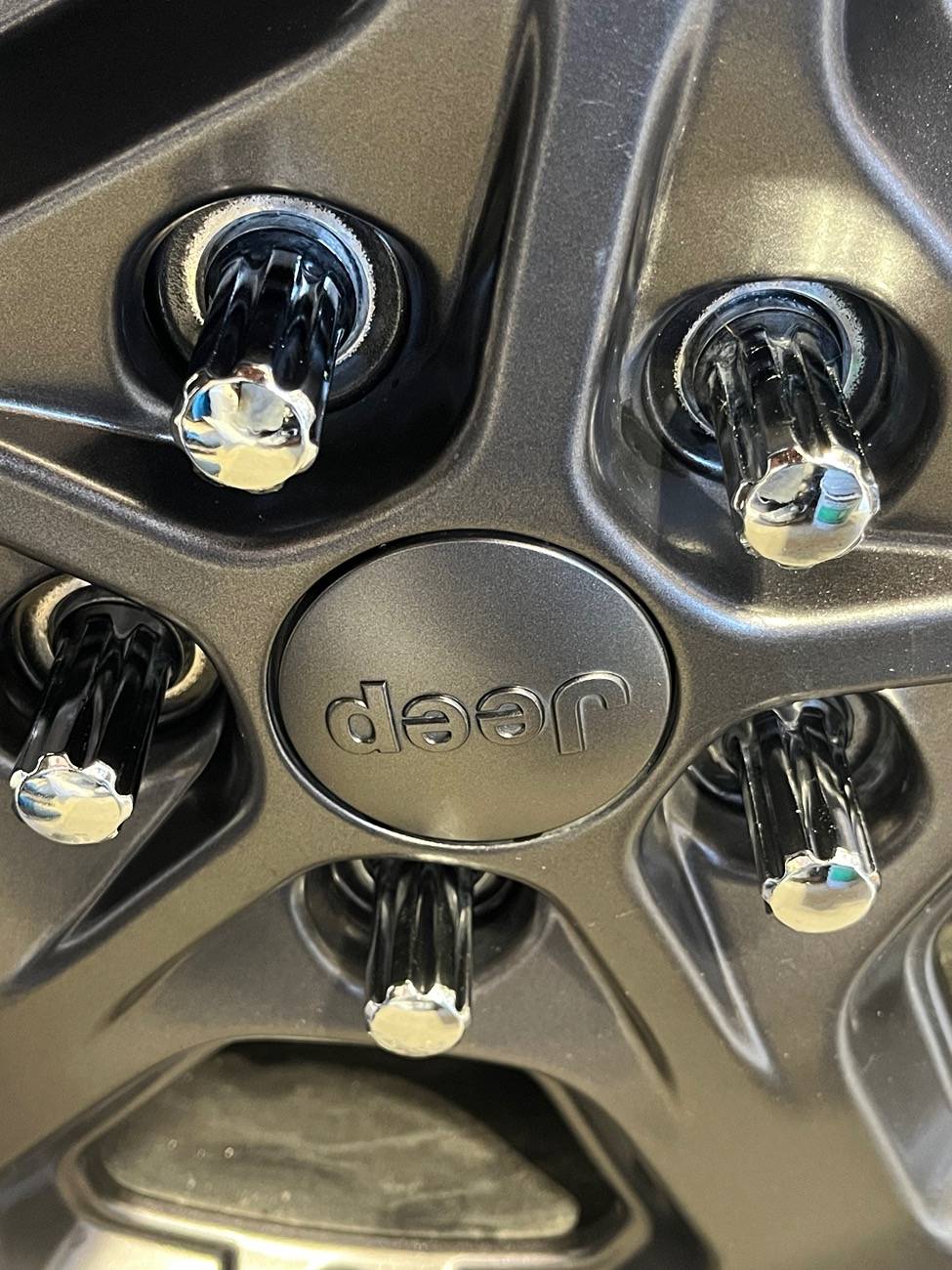

If you have time to wait, their lead time can be 6 weeks Archtype racing produces a nice product

Whatever you decide on, stay away from the 2 piece design.
Couple of ratta tats with a short socket on an impact and they swell up. If you need them off in a hurry you're then screwed.
