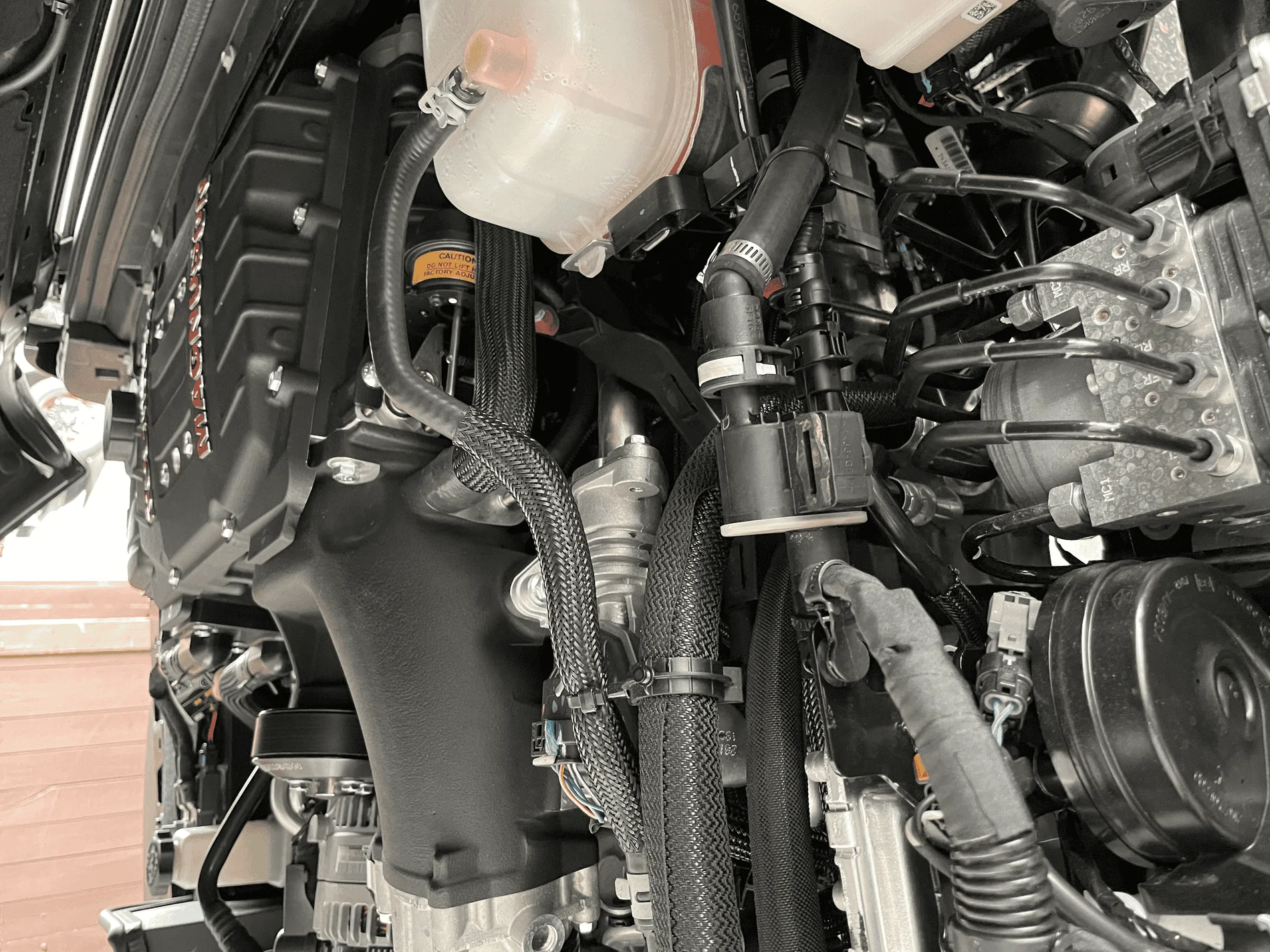

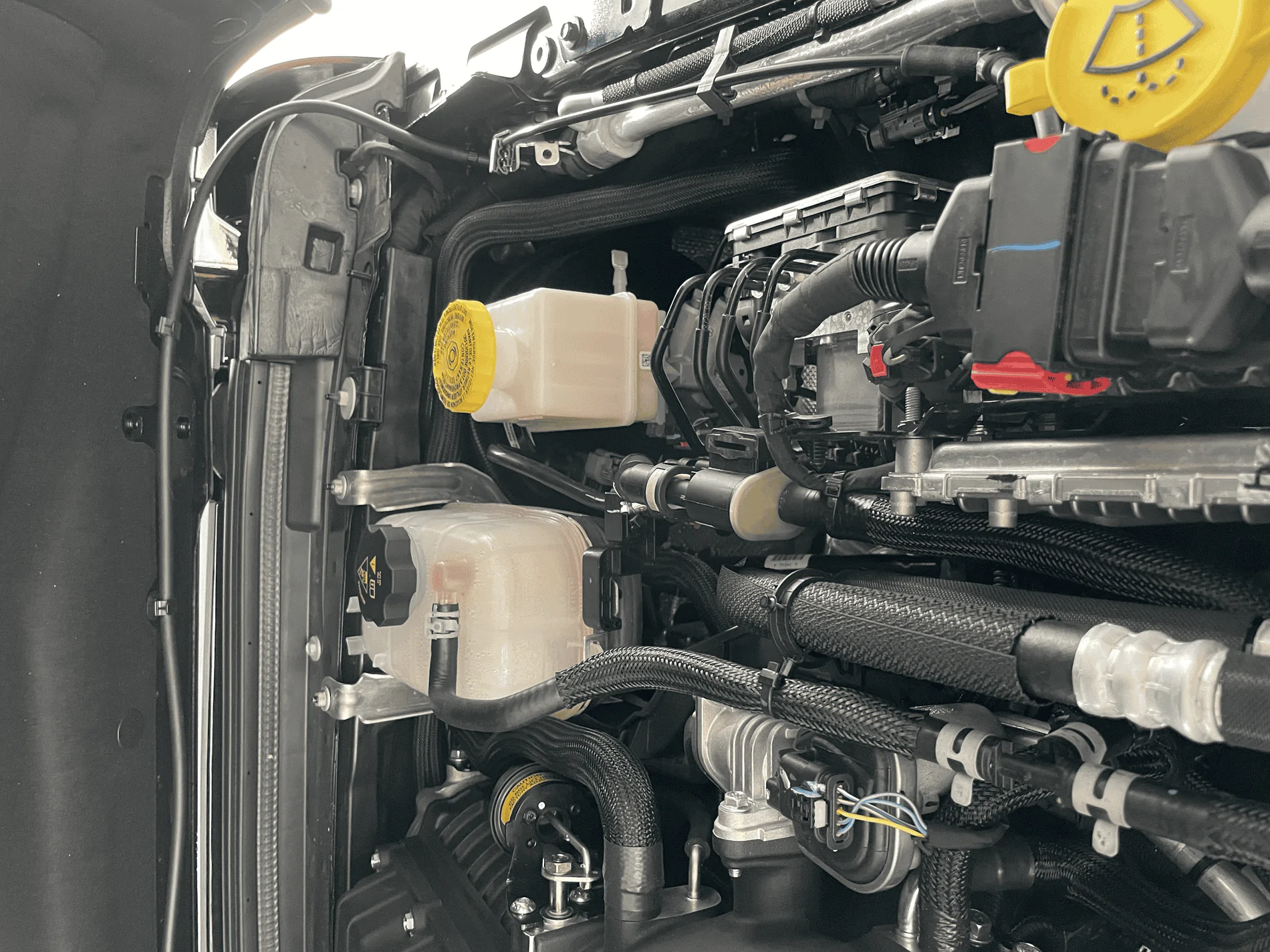

Heres a solution as to where to relocate the noisy Purge Valve that Magnuson has you relocate behind the blower and Firewall. That is a terrible area because this valve is noisy by nature so it makes it sound like you have a Woodpecker tapping on your firewall at idle. We passed the info on to Magnuson, I would assume they will address this.
Hi, in full disclosure I’m running the Magnuson on a JLUR, hope my engagement here in the Gladiator forum is kosher. I’m hoping to figure out if the purge valve is the culprit for the tick-tick-tick noise I hear at idle , and that speeds up as revs climb. At speed, I don’t really hear it.
You’re always welcome here. ?

There are two sounds. The purge valve sounds like a wood pecker. There is a tic sound that comes from the gear lash in the housing and is amplified by the no- name bearings in the idler. I replaced them with timkins and they are better. I will post a picture of the boxes later this week. Sorry for the spelling. I am on vacation lol
Did you swap/plan to swap any other parts in the kit besides the bearings?
