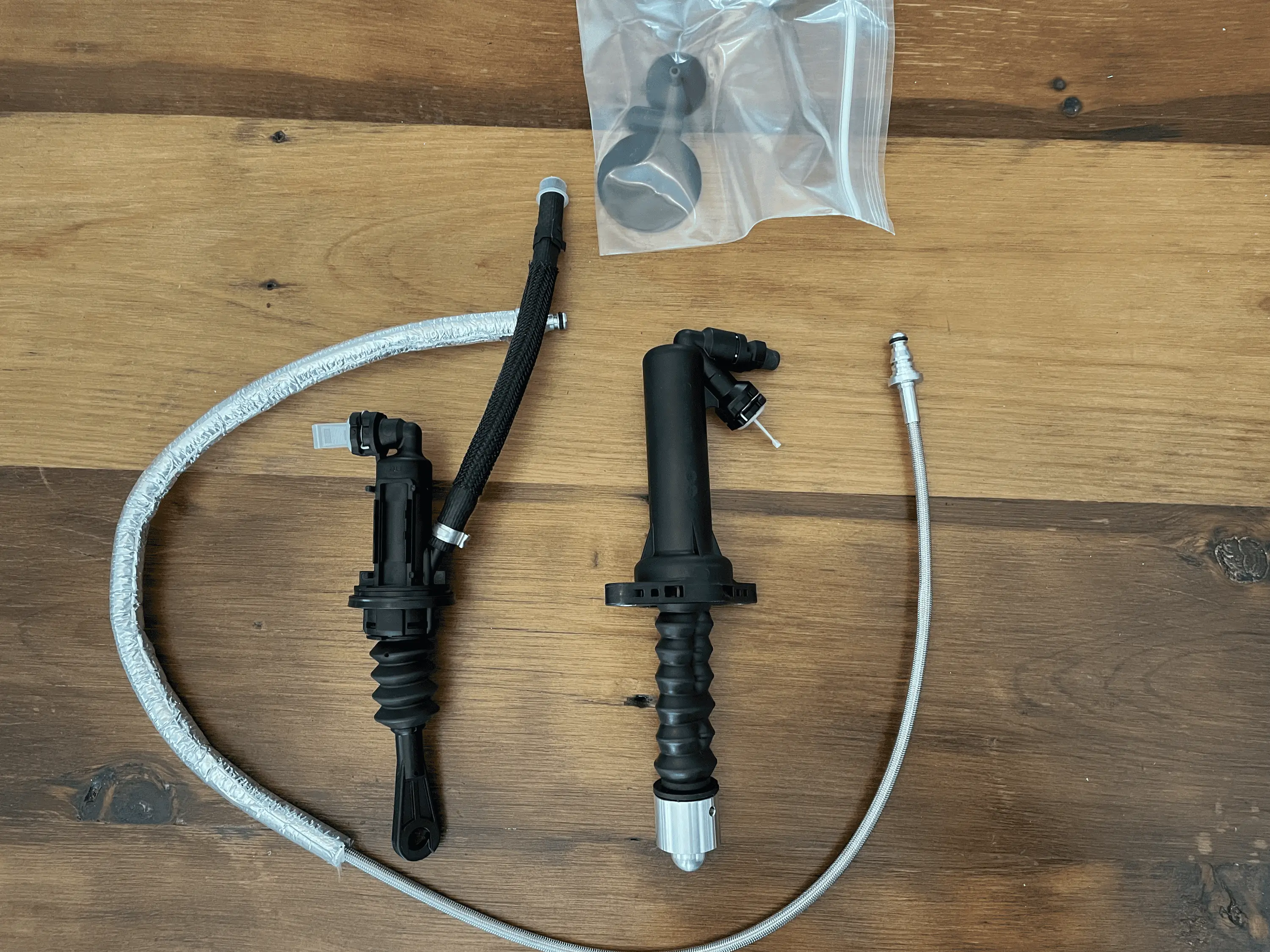

got Centerforce upgraded hydraulics delivered. Going to get an installer to put them in (no time and its a PIA to bleed a clutch). I'll report back after install
Did this report ever come back?
I’m 100% upgrading the clutch and gears, but I still haven’t understood the purpose of the hydraulics. Just ignorant on the topic.

Loving it. Highly recommend!!!
Did it actually change anything now that you’ve driven it for a while ?
also, since you’ve already done all these mods, is there anything else you’d recommend to beef up the m/t? Not sure what else to look at to make it where it should have been from the factory.
fianlly, did you disable ESS/ASS? I was reading about heavier flywheels causing problems for that system. Have you noticed one way or another? Edit: sorry it’s been a long Xmas I didn’t realize it was literally the post above me. Ignore this one.

The clutch feel and performance is way better. The biggest difference is that u can back a trailer up without smelling the clutch. The factory clutch would smoke/smell when backing - not riding the clutch. I can go from a stoplight or back up with no /minimal throttle. It also crawls offroad so much better.
I have a taser and leave A.S.S. Off since I hate it. No idea if it would be worse with the heavier flywheel but I think it terrible stock. Highly recommend this - pricey but you use your clutch on every single drive.
