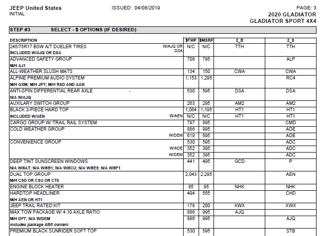

Check it out though...... in the build sheet. Anti-Spin diff N/A W/AJQ and AJQ is the Max Tow.
Jeep Gladiator Max tow and rear diff. lock on Sport S upload_2019-4-30_12-36-50
audiophil2
PHIL
Apr 26, 2019
SURPRISE
Jeep WJ
You can't order the max tow and the anti spin, once you click on max tow, anti spin is grayed out. If you have proof please let us know.
I see. N/A because it’s automatically included or N/A cause ya can’t get it at all?
Inquiring minds want to know!
N/A you can have the Max tow and Anti Spin, I assume because it uses Rubicon axles, that don't come with anti spin.

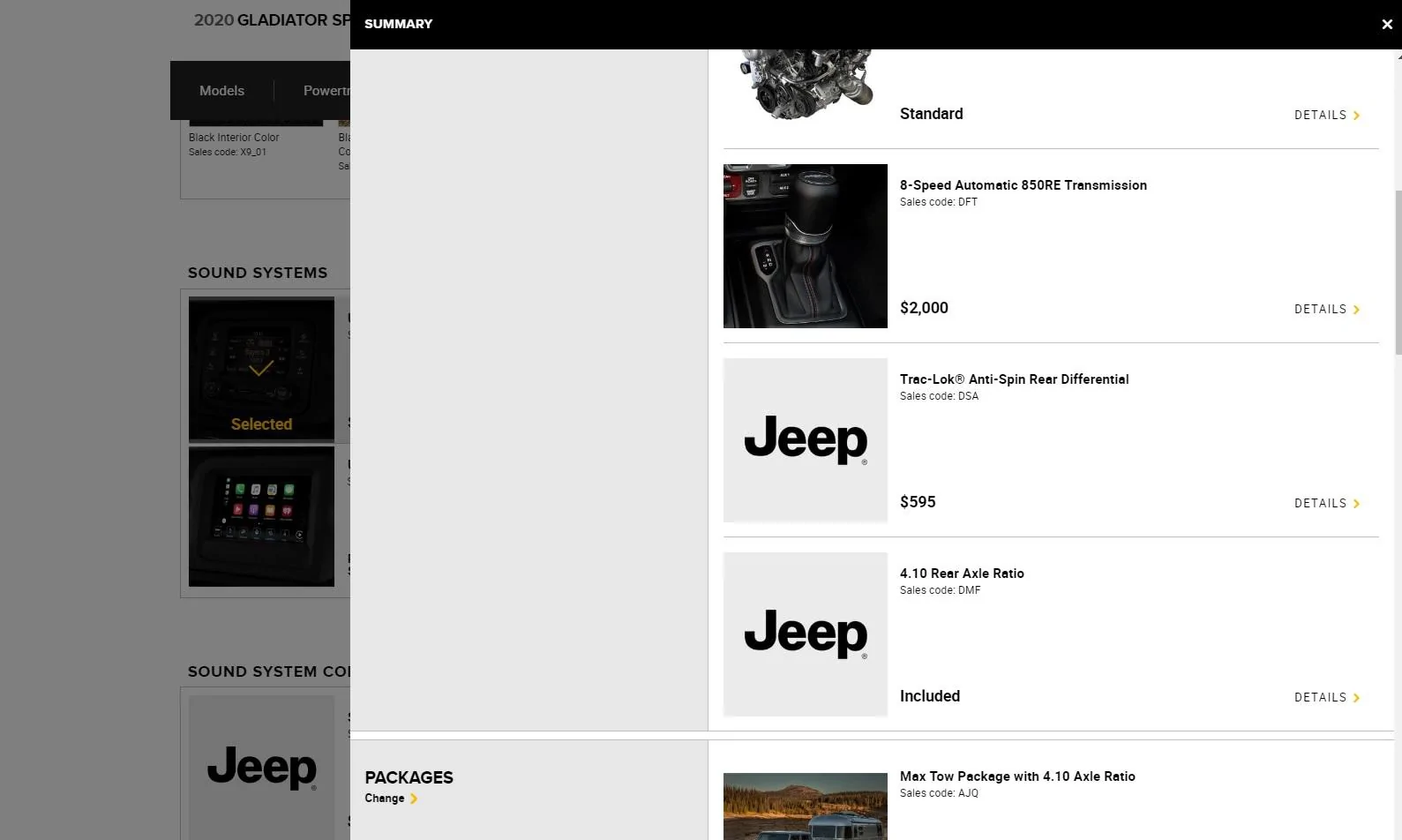

Here is a screenshot of my configuration.
Jeep Gladiator Max tow and rear diff. lock on Sport S Untitled

You can't order both the "Anti-Spin" option and "Max Tow" option because the Anti-spin is ALREADY INCLUDED with the MaxTow. So basically, the configurator is just preventing you from ordering the anti-spin TWICE.
From the online configurator for 2021 Gladiator Sport:
Jeep Gladiator Max tow and rear diff. lock on Sport S 1601571307094
