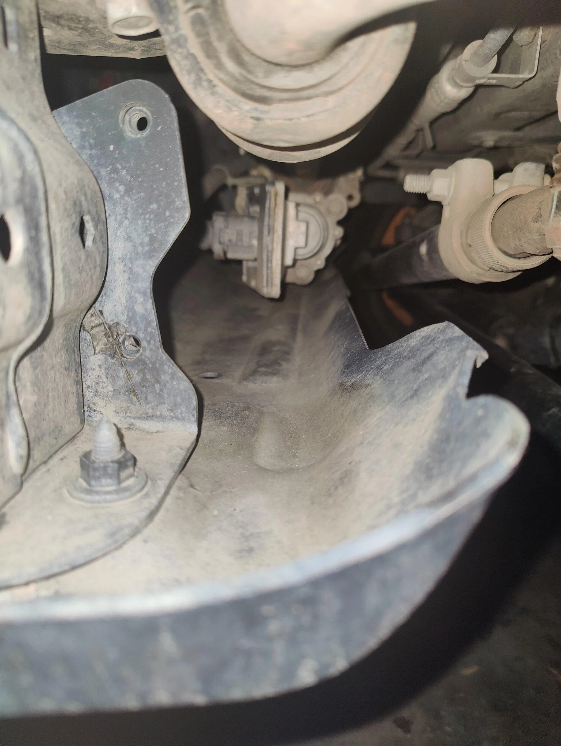

Not on Mojaves and Rubicons. That's a bonified, big heavy steel skid plate. The air dam on an overland must be different. The Rubicon one is there to protect the sway bar disconnect motor (and front end). The Mojave one is there to protect the shocks. Without that skid plate, the sway bar disconnect motor is naked and in the open. They are very much functional on both. It's a real skid plate.
I don't know if they're exactly the same, but the Rubicon skid plate is quite heavy, thick metal. It's the same on my jku. I have to assume the Mojave one is just as thick. We have actual skid plates, not airdams.
It's there to cover this thing, way back in the center. That skid plate is actually legit/functional.
