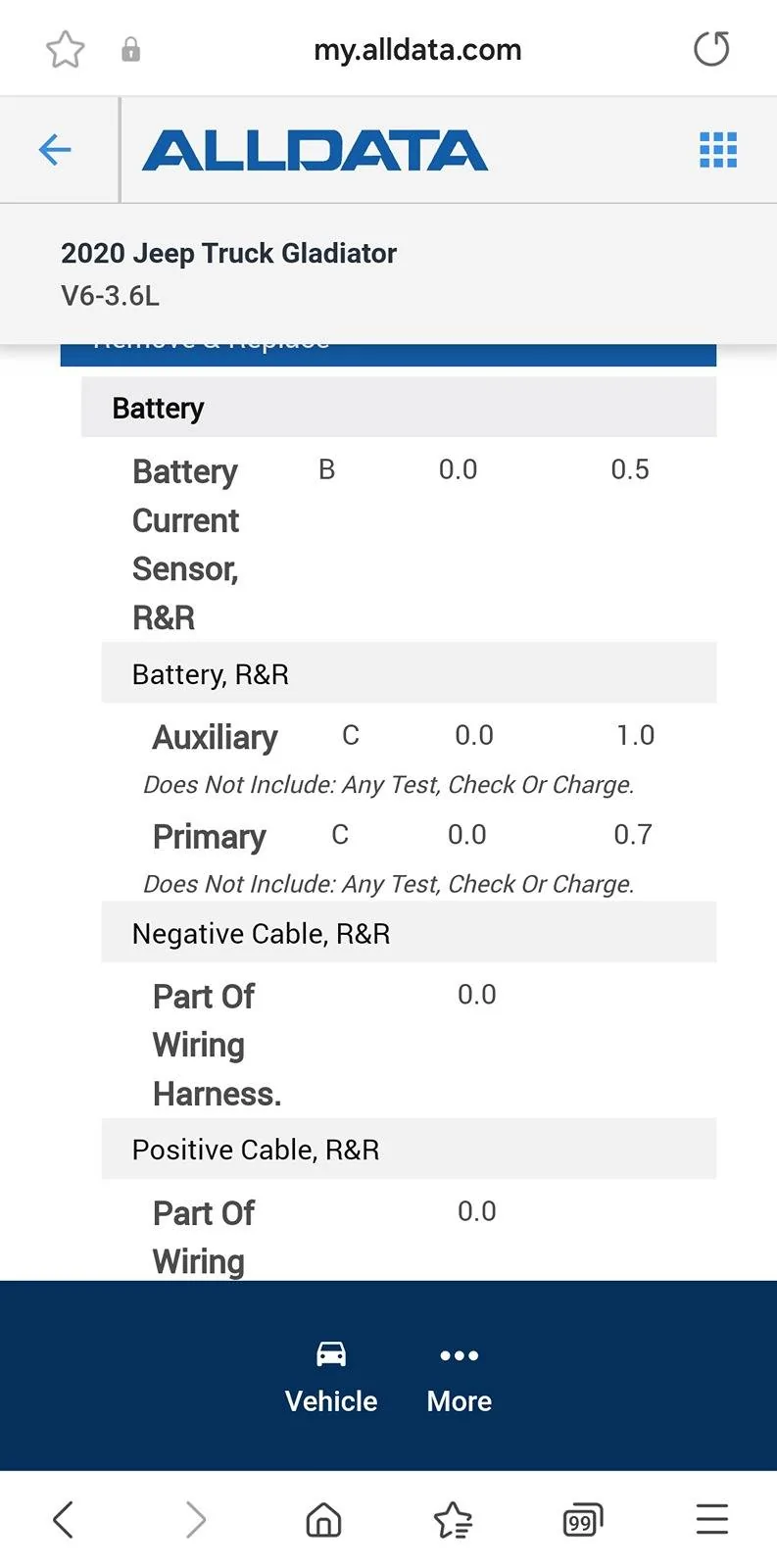

2020 Gladiator purchased in May 2020 - I asked my dealer to check my batteries while it was in the shop. They called me today and stated the batteries were "a little weak". They stated to replace both was over 900 dollars.
Is this normal these days? I know it takes some effort to get at the aux and I assume it's half OEM parts cost and half labor probably? (maybe more in labor)
This is not a gripe, just checking. I can easily do the main myself. The Aux will take some sneakiness as I am an apartment dweller and they don't allow us to work on vehicles on their property for good reason I suppose.
I can probably handle it at a friend's house when they have time for me.
However, back to the question at hand. Is this a normal charge these days for a dealership to replace both batteries?
The oem aux battery can run from $150 to over $180 (list price $265) at a dealership
The main battery can run from $282 to over $336 (list price $476) at a dealership
Dealer Labor is 1 hour for the aux battery and
.7 hr for the main battery.
Cheaper to go to an auto parts store and buy better batteries and do it yourself and save $$$$$

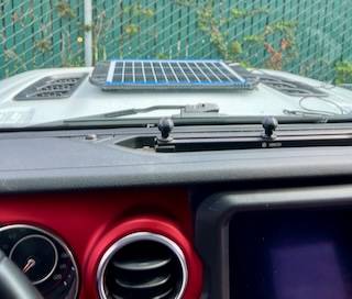

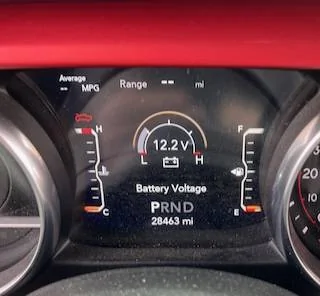

I am testing out the solar trickle charger now that I have my truck back from the dealership. Working from my truck in case I smell anything burning. :)
Is the voltage readout just the starter? Combined readout because they are in parallel? Never understood this one.
combined voltage.
I take it the truck is off - and not in an ESS stop?
That's real low voltage.

Yes, the truck is completely off. I just put it on ACC to see the battery voltage. It has a lot of short trips on it. I have in the past taken off at like 5:30am and made a long freeway trip out to the desert and back,(about 4 hours), and they've recharged to the the point where ESS starts working again.

Frankly, I'd put a REAL battery charger on it and charge the batteries. The solar will only maintain for the most part and not do a great job on a full charge. There's 4 phases of charging AGM batteries and it takes some real push to fully charge really low batteries.

Maybe I'll get them out this weekend and do that. I have a Noco 10amp charger that supports AGM so it's worth a shot. I just feel if I'm going to go through the hassle to pull them both out at four years in I might as well grab a couple new ones from Autozone and charge those up and drop them in?
This solar panel is 20watts and you're right, it's not going to charge them very fast if at all. But, it's fun to play with and good for long base camping trips!
