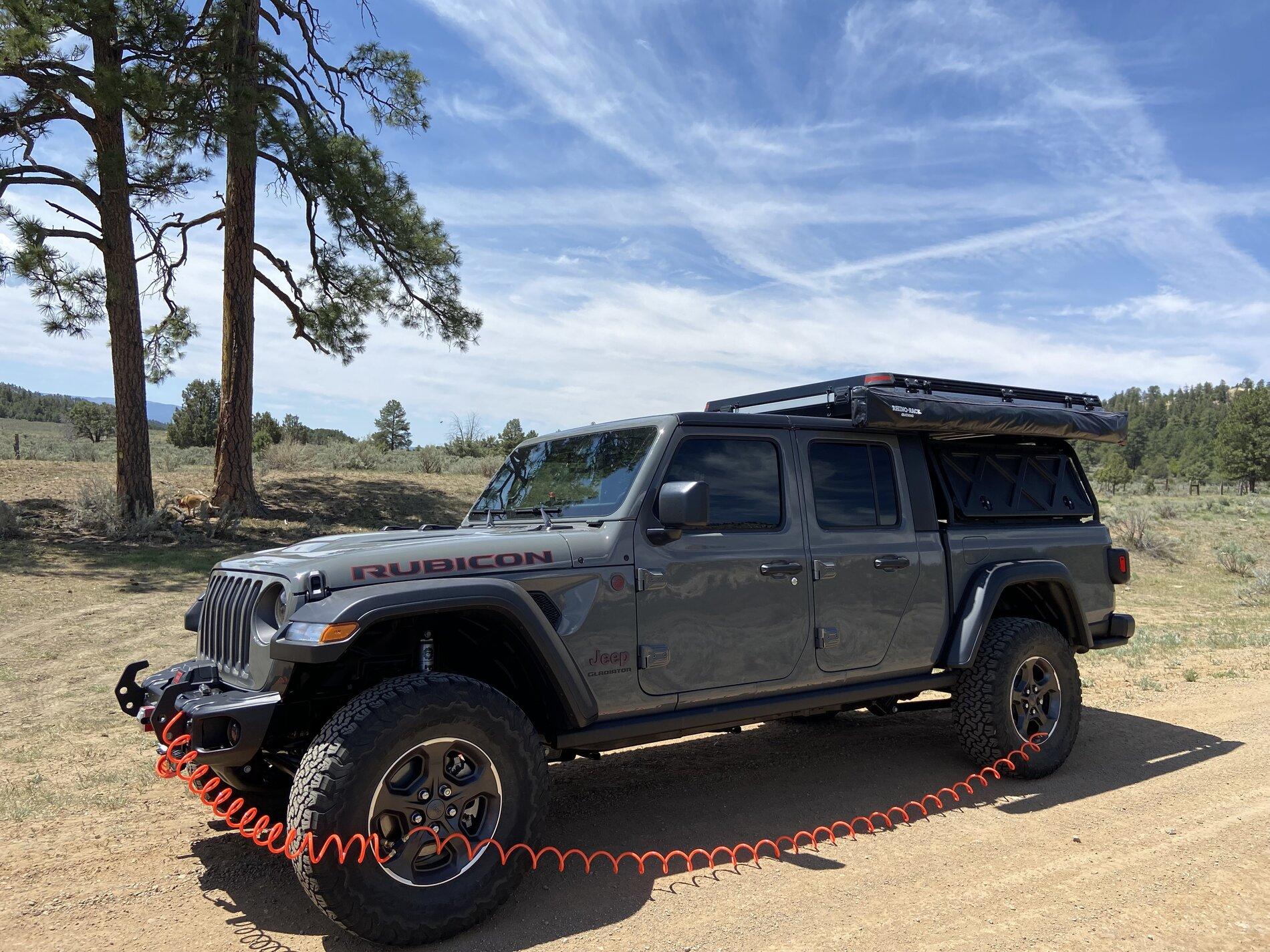

I ordered my Mopar kit from Amazon and came from Athens Dodge. It was the newer AC kit and on my 2021 Rubicon I got approx 3inch front lift and 2ish from the rear. Still a slight rake but perfect once I have all my overland gear in the back. Super impressed with the kit so far after doing some off-roading this weekend. I still feel like it's a little expensive but at 1250 I can't complain. Compared to my prior MC Gamechanger lift it rides the rough much better then the cheap MC shocks. Obviously not as good flex and articulation but not spending twice the amount. Going to Moab in a few weeks so I will report back then. I also don't see any bowing with the springs.
