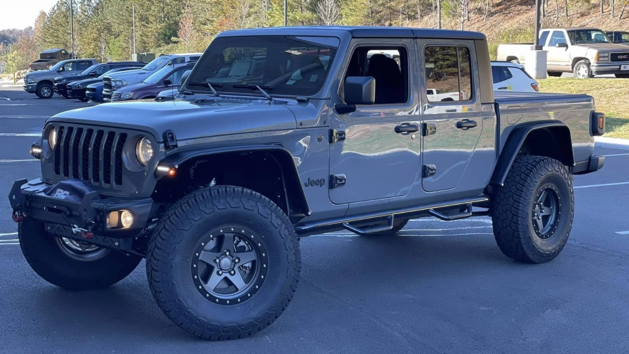

This was mine with the full mopar lift kit and a 3/4 spacer up front. It still had over 1in rake in the rear with that setup. I ended up pulling the spacers from the front and changing the rear springs to rubicon springs and it set pretty level with that setup around 1/4 rake.

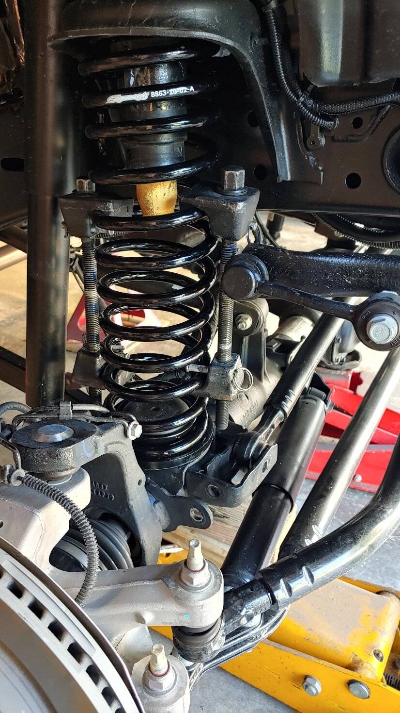

Jeep Gladiator Mopar lift on Rubicon E613DF7D-E199-42AE-BEEA-AAF61D4127FF
This is the mopar front springs with rubicon rear.

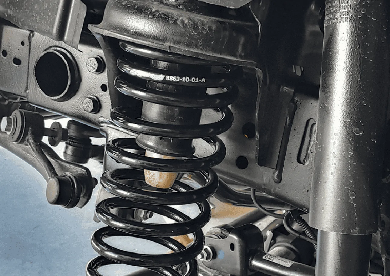

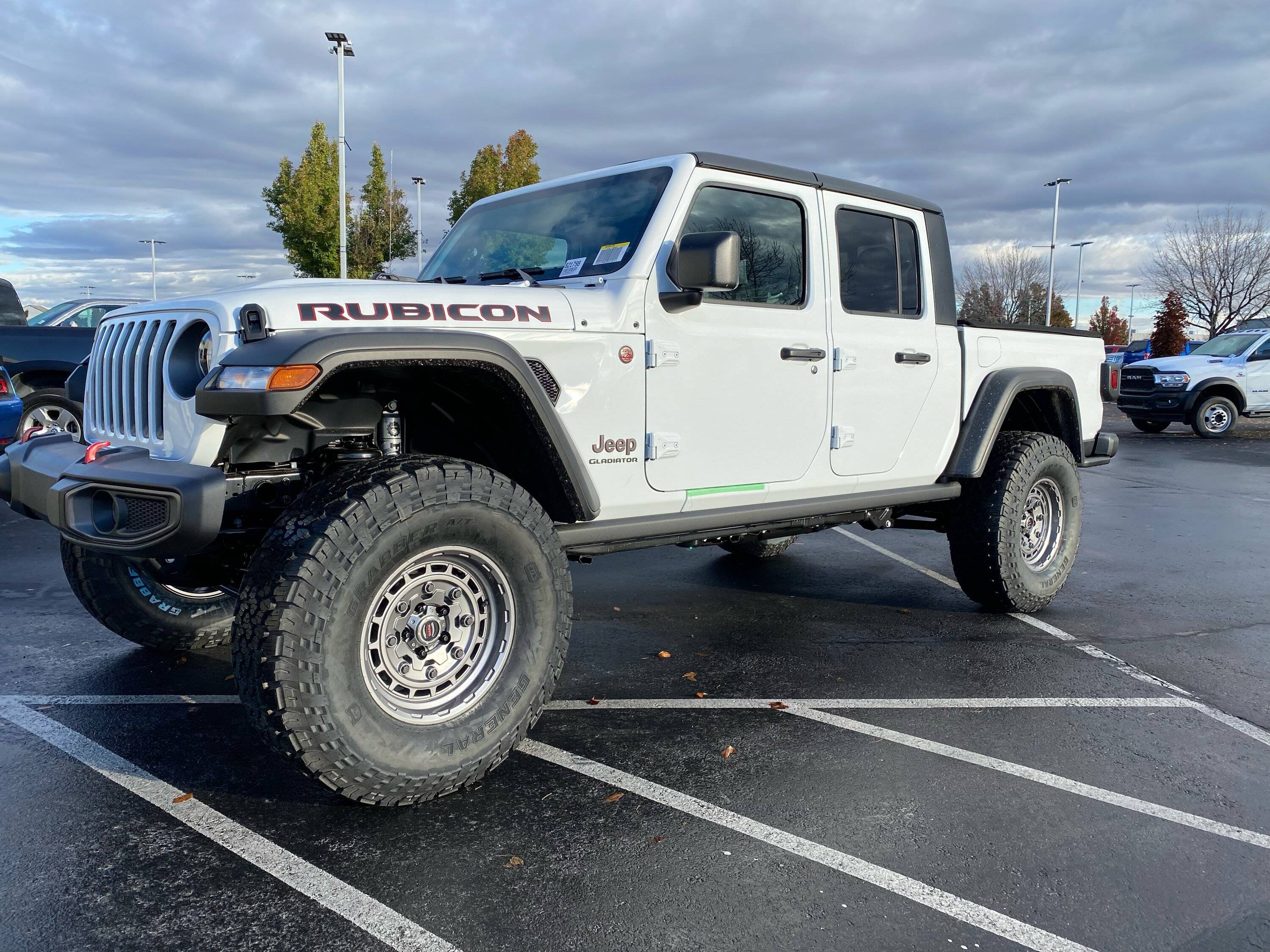

Synergy springs under the front. I went with the 1" and wish now I had gone with the 2".
Jeep Gladiator Mopar lift on Rubicon 20220907_112300_HDR
Jeep Gladiator Mopar lift on Rubicon 1671132039148

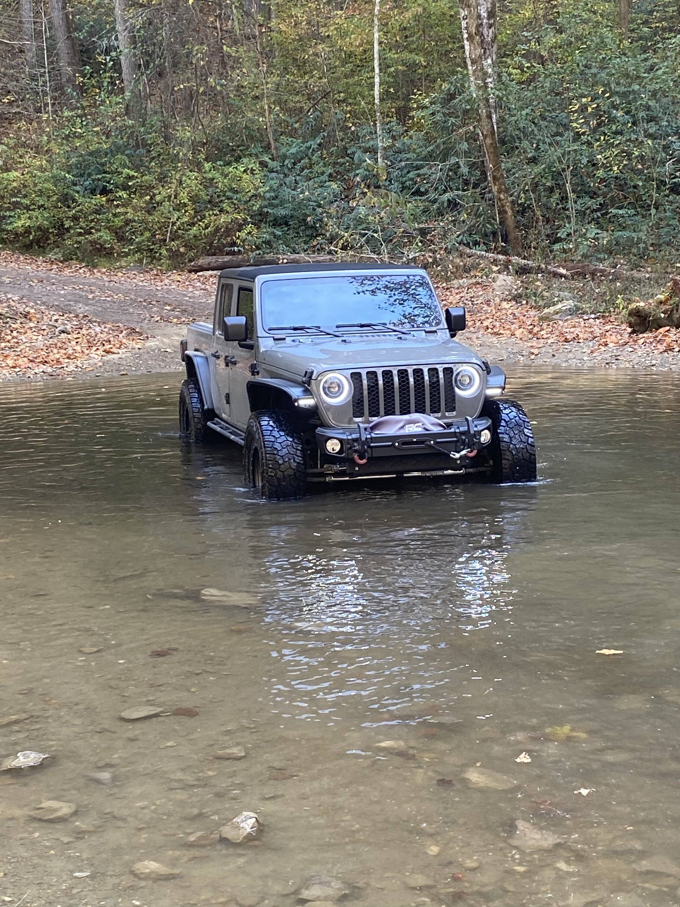

I had a 2inch Mopar lift with a terra flex spacer up front on 37s since delivery.
Jeep Gladiator Mopar lift on Rubicon 59C416DC-DB09-4B8D-85AE-8ED993015624
