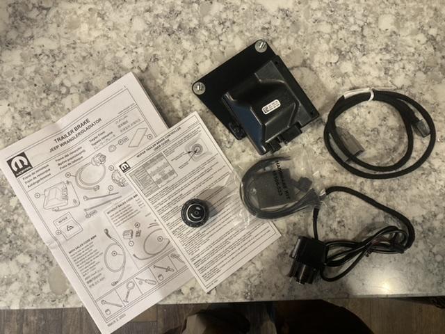

It is real!!!!! Got mine today!.....jack
Jeep Gladiator Mopar Trailer Brake Controller for Jeep Gladiator Officially Released (Part # 82215652AB) 80FDC6AD-B050-4B5A-87E9-006A0C4EC941

Install is actually pretty simple, everything plugs in, and all straps, foam padding and bolts/nuts are included, hell even the bolts are captive. I’m a Master Electrician, and I would not even consider this wiring Just a couple cords with plugs ...Jack
40,503
54,023
Install is actually pretty simple, everything plugs in, and all straps, foam padding and bolts/nuts are included, hell even the bolts ate captive. I’m a Master Electrician, and I would not even consider this wiring Just a couple cords with plugs ...Jack
If it's like its Redarc older brother, the lead between the box and the control in the dash is a Cat5 network cable. Yeah, I checked, it's a match. They even said I could locate things anywhere and simply use as long a Cat5 cable as I needed. Nice since I have dozens of Cat 5 and Level 6 cables around from my networking days. If I was keeping the Redarc in the JT instead of moving it to the GC, I would have swapped out their cable with a 90 for one with two straight RJ45 ends as the Redarc supplied 90 is actually more in the way than straight connectors would have been.
Query - where, can't tell from the pics alone -are they wanting that box mounted. I see two studs. I assume there's a brace under there with two holes just for that?

Well, akward moment here, but as I posted in another thread , my wife loves the Mojave, so she's up in the hill country at her horse's farm, she drives it every where! So I can't look under Mojave but drawing up close showings a bar with two holes in it that the bolts go through, I'm pretty impressed with it at this time. I am also thinking of relocating the 12V socket to the side panel of center array to right between heat/AC controls and glove box door, but alas, who knows when I'll be able to see how much room is there.....Jack
