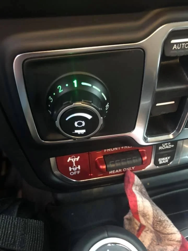

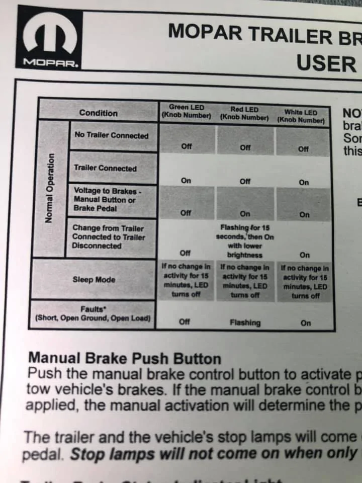

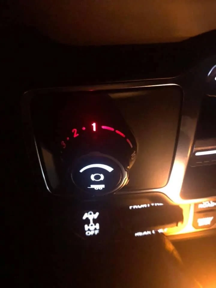

Here’s some more pictures and zoom of the instructions showing the various LEDs and their meaning from a Facebook post. Most exciting for me is that it illuminates, so it’ll be easier to see at night.
Exactly as expected, except the addition of the glow to see it. Otherwise those instructions are almost exactly like other controllers - match Redarc pretty close.

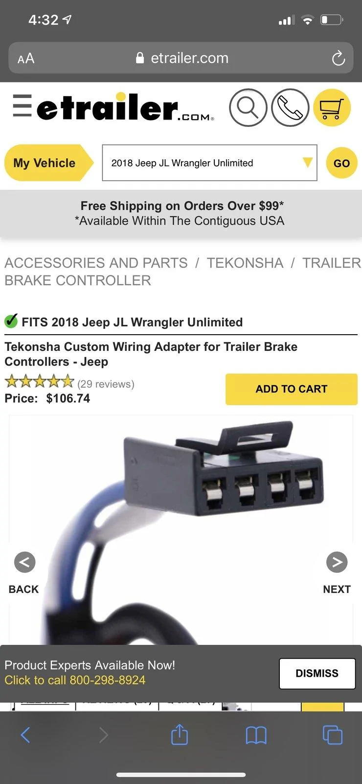

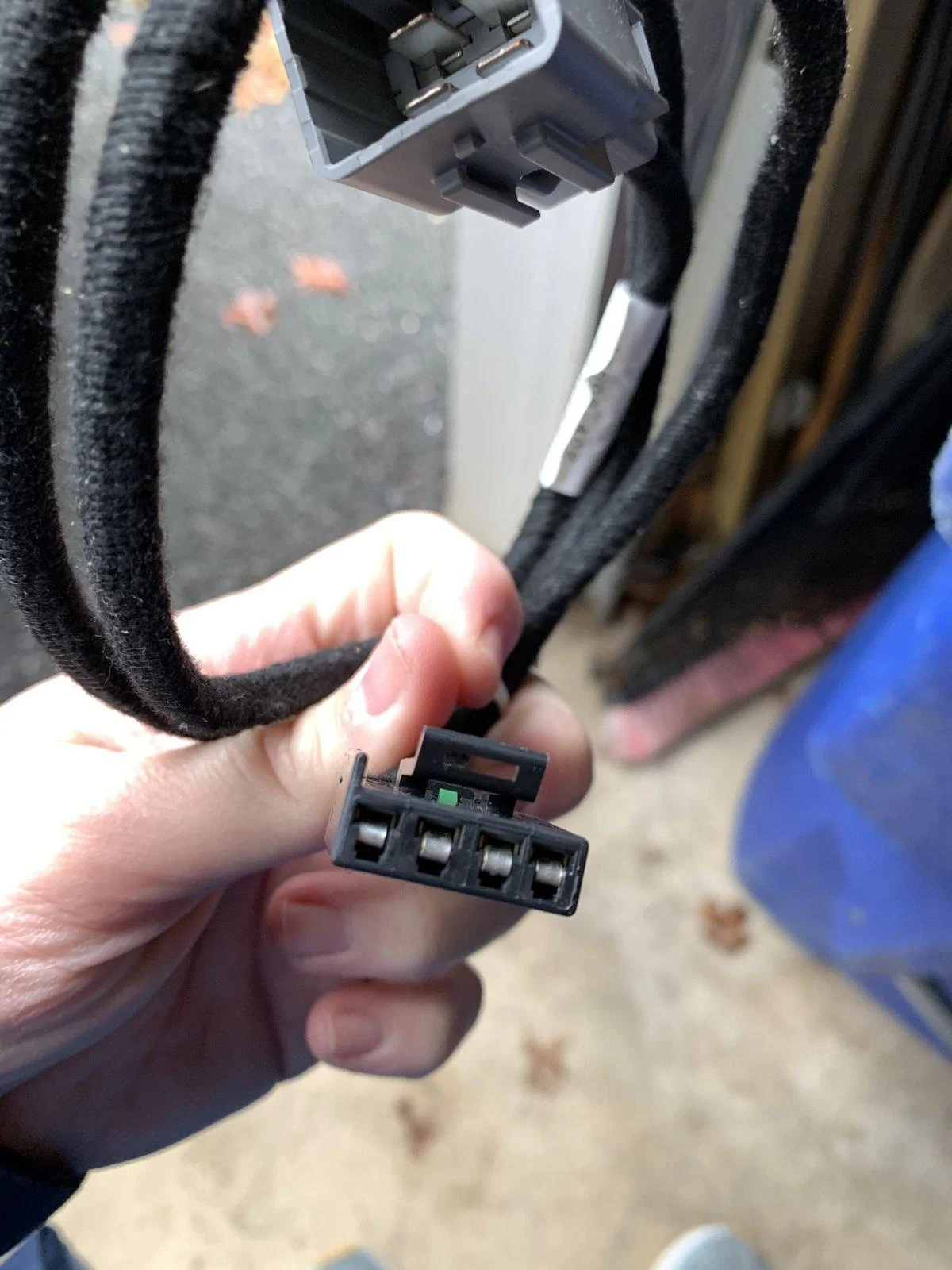

One thing I noted was that the controller has been speculated to be made by Redarc, however I believe it may be Tekonsha instead. I say this because the wiring harness that connects the controller box to the truck appears to have a Tekonsha connector on it. Here’s a picture of the connector from the kit harness and the one Tekonsha sells for their standard controllers, appears to be the same thing.
Jeep Gladiator Mopar Trailer Brake Controller for Jeep Gladiator Officially Released (Part # 82215652AB) 74223075-1DD3-405F-9412-097FDC780D20
Jeep Gladiator Mopar Trailer Brake Controller for Jeep Gladiator Officially Released (Part # 82215652AB) 8E257701-1335-41AE-A8C1-ECEE57A8E240

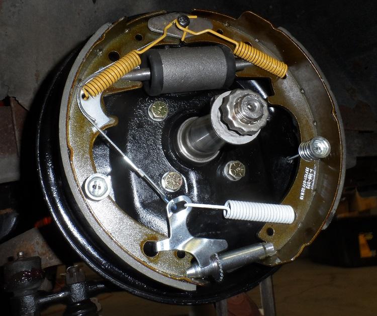

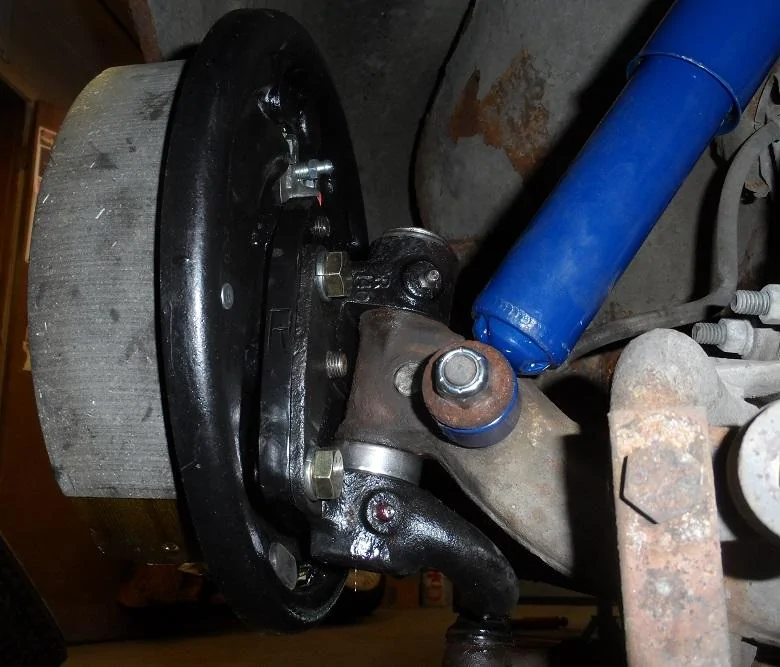

I see you have a 49 Ford.
Here's one for you - the front brakes and spindles from my 73 Javelin on my neighbors 49 Ford -
He wanted bigger brakes and to lower the front a bit, so I gave him my brakes and put Kelsey-Hayes disks on my car
