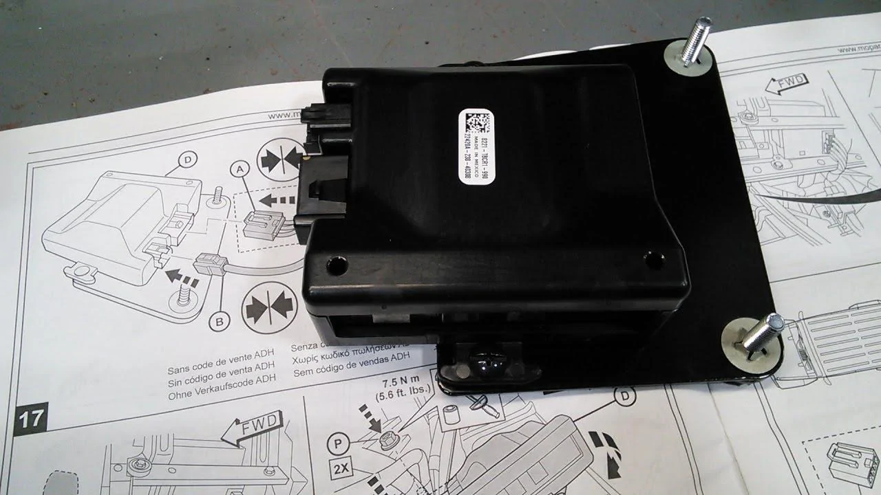

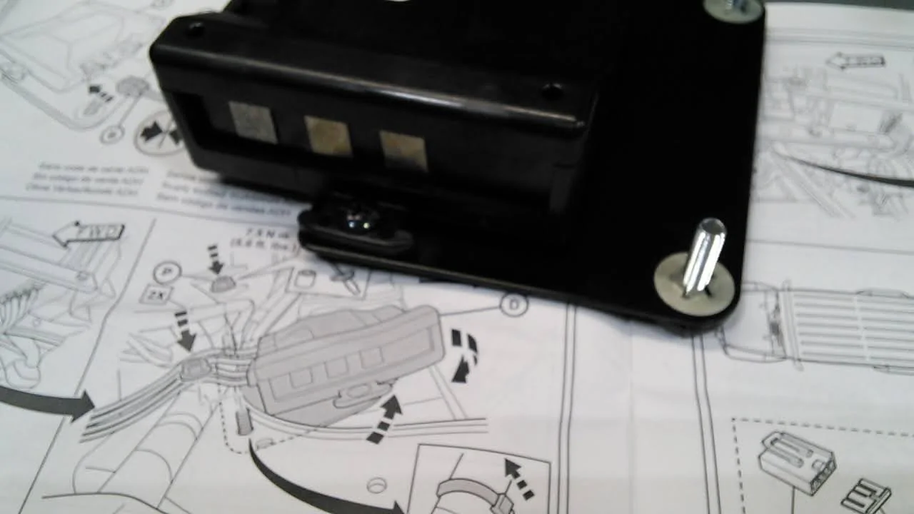

Anyone else notice anything hinky about these pictures - look closely at the details
Compare the actual controller box to the pictures in the so-called instructions.
Jeep Gladiator Mopar Trailer Brake Controller for Jeep Gladiator Officially Released (Part # 82215652AB) IMG_20201030_130934
I think it’s an instruction typo. Mine is like that too and installed just fine.

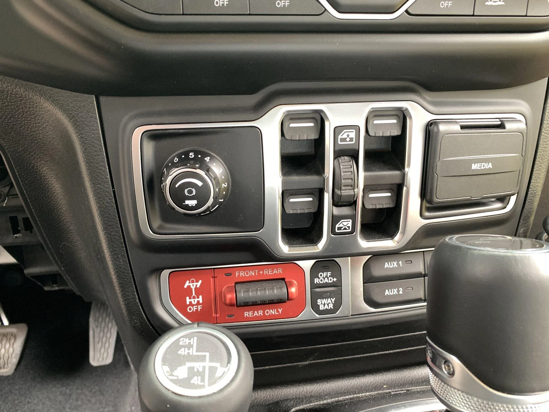

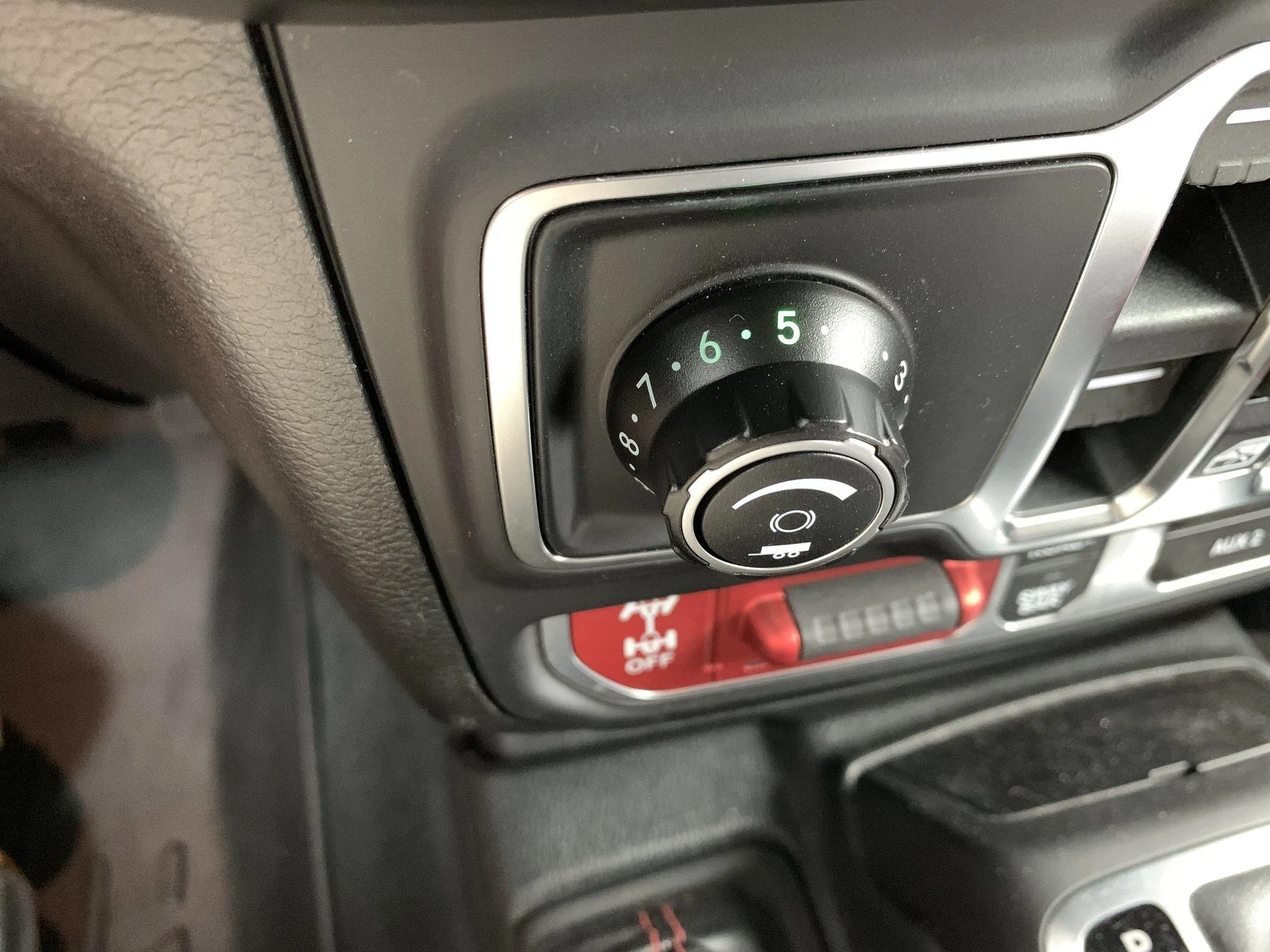

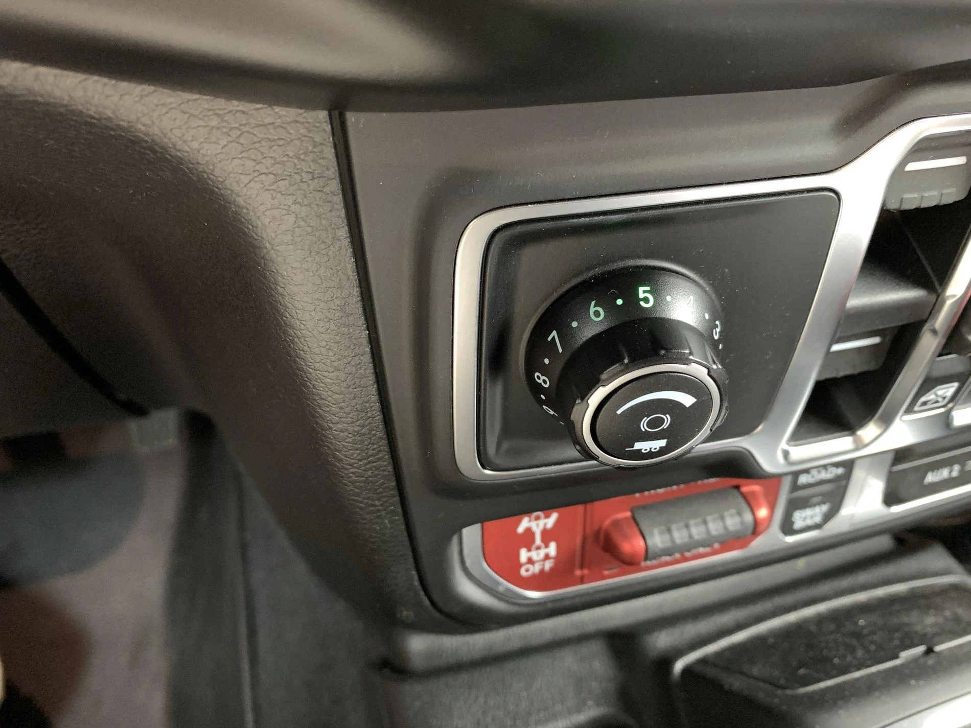

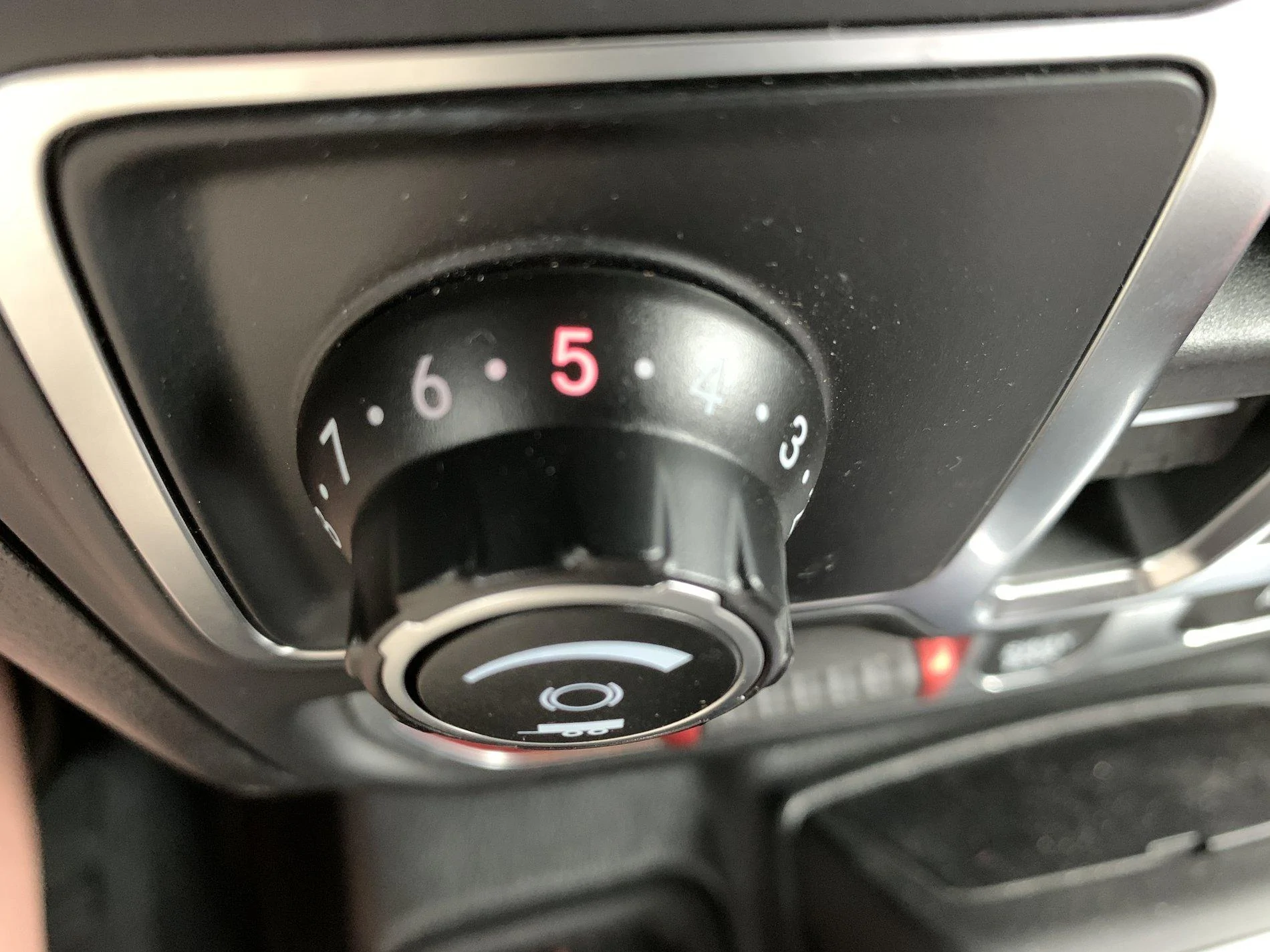

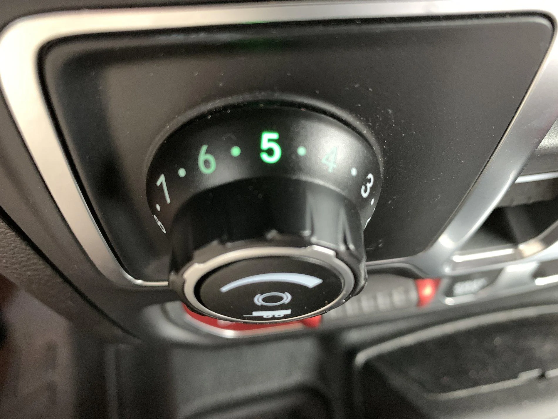

So I just got done installing mine, it took about 45 minutes from start to finish. I’m bad at taking install pictures, but I did grab some of the finished product. Couple things to note:
1.The upper mount for the controller under the dash has a clip for wiring in it from the factory. You have to remove that clip and slide it out of the way, it’s just a push pin. The instructions show this, but not very clearly.
2. It’s nice and snug under there, I’m still unbending myself
3. The instructions show the proper operation of the controller, which I tested and it’s spot on.

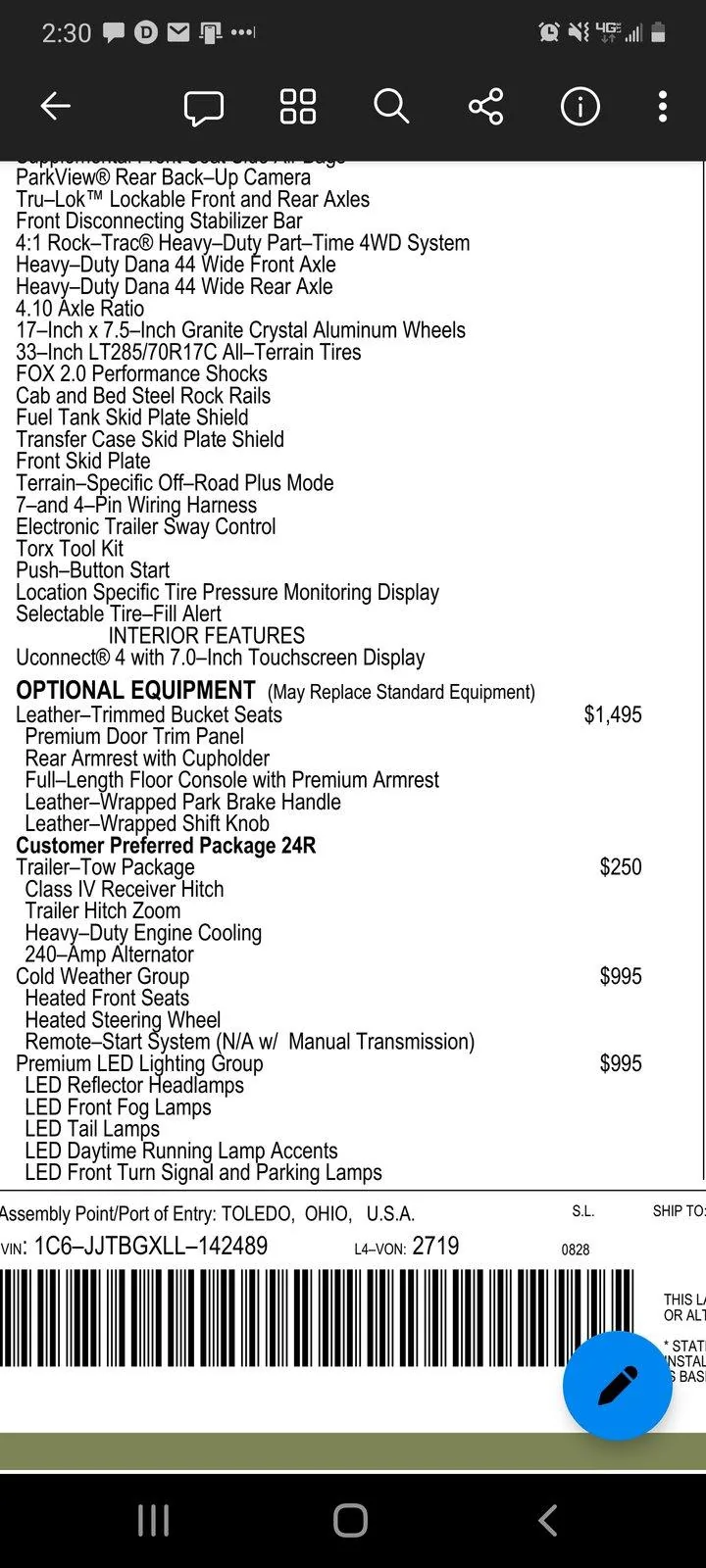

I have a 7 and 4 pin - dealer says I'm still missing the harness.. Thoughts?
Jeep Gladiator Mopar Trailer Brake Controller for Jeep Gladiator Officially Released (Part # 82215652AB) Screenshot_20201030-143014_OneDrive
FREEZE451
Jon
Oct 23, 2019
443
645
Fargo, ND
2021 Jeep Gladiator Mojave | 2021 Grand Cherokee L
Spoke to my dealer, they said there is nothing to plug into period and they would have to cut some wires.
I'm going to locate instructions and see if there is something missing.
I have what everyone says and the specifically said that it needs the ADH code. Even thought I said the ABR code is the JT code, he showed me the online section in more that states that - so they are going by that.
Personally I see where they are coming from, but I will totally check it out myself.
Thanks guys.

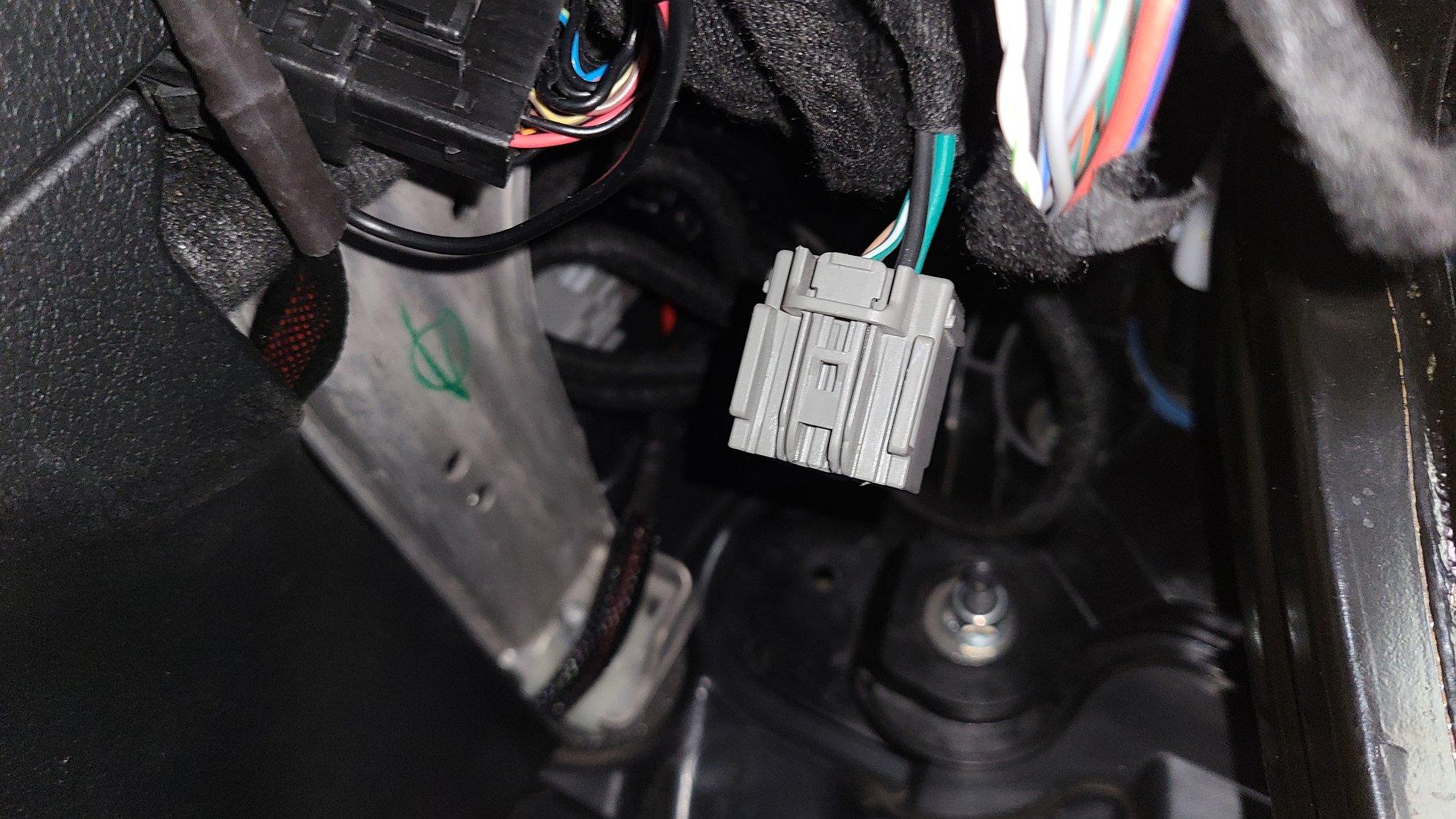

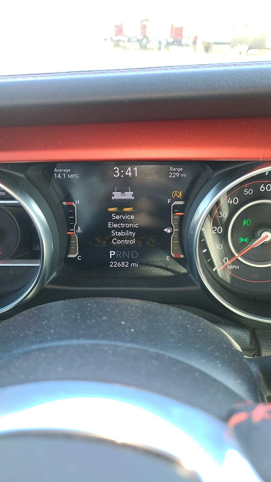

Round 10!
So I located what I think is the plug.
Jeep Gladiator Mopar Trailer Brake Controller for Jeep Gladiator Officially Released (Part # 82215652AB) 20201030_153752
When I plugged it in, I got an error on my dash saying the stability control is off and to service it.
Jeep Gladiator Mopar Trailer Brake Controller for Jeep Gladiator Officially Released (Part # 82215652AB) 20201030_154149
Then when I unplugged it it went away.
Any thoughts?

Round 10!
Any thoughts?
Imagine the dealer did the same thing, thought "well, not going there." And decided to order a cable.
That is the correct plug. If it’s not working, the other harness isn’t going to fix that. The harness they are referring to will only run the blue brake controller to the add on he was that comes with the trailer wiring for installing on Wranglers that came without it. If plugging in the controller causes that issue then either the controller is bad or one of the wires got knicked when installing it.
From your window sticker you already have the tow package so there is nothing to add.
