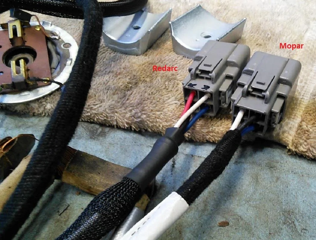

Would anyone who has NOT installed their Mopar controller be willing to check the 4 wire harness (that connects the controller box to the Jeep's wiring) for a diode?
It should be the white wire if I recall correctly (on Redarc it's red)
Jeep Gladiator Mopar Trailer Brake Controller for Jeep Gladiator Officially Released (Part # 82215652AB) IMG_20201030_103332
I checked my Mopar harness and it did not have a diode. All 4 wires ring out full continuity from both directions. The Tekonsha 3073-P with diode rings out like you described the Redarc harness, they one slight beep, then no sound and a reading on the red wire, other 3 ring out full continuity as expected.
I'm hoping someone with a working unit checks theirs to see if what you and I got were different in some way, such as that wiring harness thing.
But it's hard to ask someone who has a fully working controller to go take the harness back out, check it for a diode, and put it back. That's a bit of work to ask of someone who isn't having any problems with it.
Maybe if those who have not yet installed theirs checks and reports back - and then if it workse or not.
What Jeff and I have shown is that two of us who have the problem controller situation also do not have the diode.
What's needed - find if any of those that work just fine have a diode in line.
