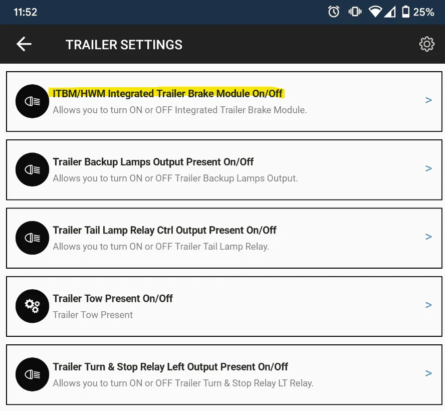

Regarding the ECM flash: I thought I read that in the Jscan app there was a toggle for brake controller. I wonder if this has anything to do with the issue that shadow has but monte doesn’t?
Jeep Gladiator Mopar Trailer Brake Controller for Jeep Gladiator Officially Released (Part # 82215652AB) 1604935500148
40,497
54,011
Good thought, but 'Been there, done that.'
It's for "integrated" which this is not. The wiring diagrams show these using a connector labeled "third party brake controller".
I already toggled that with my jscan.
I thought - what the heck, some people insist a flash is needed while others - nope, no flash and it's fine. My dealer tech indicated no flash was needed after looking into it and finding those error codes set. But I set that to "on" and it mattered not, errors there were still.
