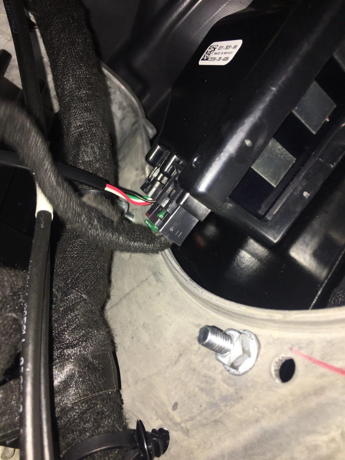

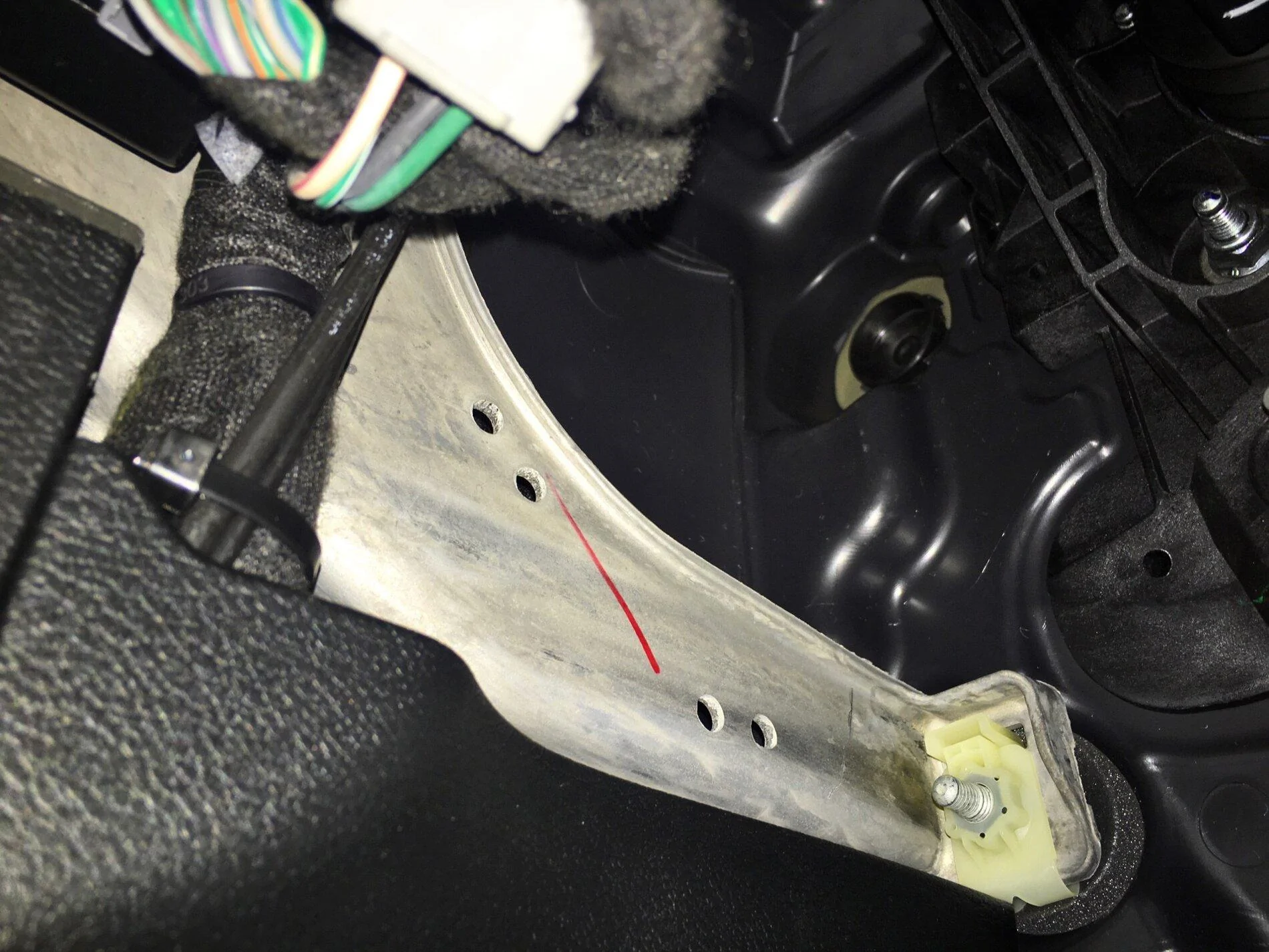

Hi All,
As others have recently suggested, given the mixed results, I would highly recommend once you get the switch installed into the dash panel and that panel reinstalled, clamp the controller to the frame somehow, connect the wires, and test the system. If it fails at this point, avoid the frustration of trying to mount the module.
I used to very small screwdrivers inserted between the clear plastic and metal frame, directly over the latches to remove the power port.
My biggest frustration was a) identifying what the F*(^! the instructions was trying to indicate as far as where to mount the module, then b) being able to bend in there to get to it, while laying upside down.
a) I've included PICs of the frame assemble where it mounts. Included is also the unit mounted. Note as ShadowPaPa says, wiring as instructed is very tight. So, I mounted the unit and let it tilt towards outside of Jeep, then connected wires after routing them as chosen, then carefully tightened the nuts while ensuring the wires did not pinch or abraid on the frame. Note that the lower screw mounts in the hole highest on the corner and the other requires that you remove the existing tie wrap holding the existing wiring harness to the frame. The hole where the tie wrap plus into is the upper mounting hole for the module.
b) I moved the driver seat backward agains the rear seat by removing the 4 seat to floor mounting bolts. Doing so made it a whole lot easier.
As a separate note, we've had discussions about the elimination of the 12V power port. I'm thinking that it could be relocated into the center consoled. Not my idea, stealing it from my Lincoln Aviator. I found this console storage unit which I believe will permit me to re-mount and reuse the existing 12V port in it's entirety, into the bottom of the top unit. https://salexorganizers.com/jeep-wrangler/ With a little extra wire, the upper tray can still be removed permitting access to the bottom.
Jeep Gladiator Mopar Trailer Brake Controller for Jeep Gladiator Officially Released (Part # 82215652AB) frame looking up from floor
Jeep Gladiator Mopar Trailer Brake Controller for Jeep Gladiator Officially Released (Part # 82215652AB) frame looking forward from floor
Jeep Gladiator Mopar Trailer Brake Controller for Jeep Gladiator Officially Released (Part # 82215652AB) controller mounted as instructed

Hi All,
EXCELLENT PICTURES!

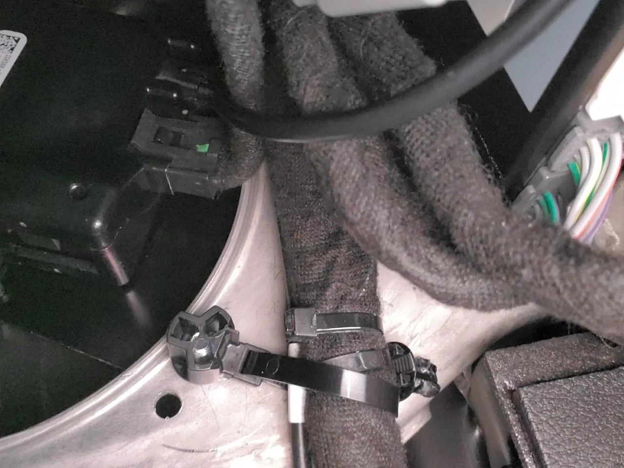

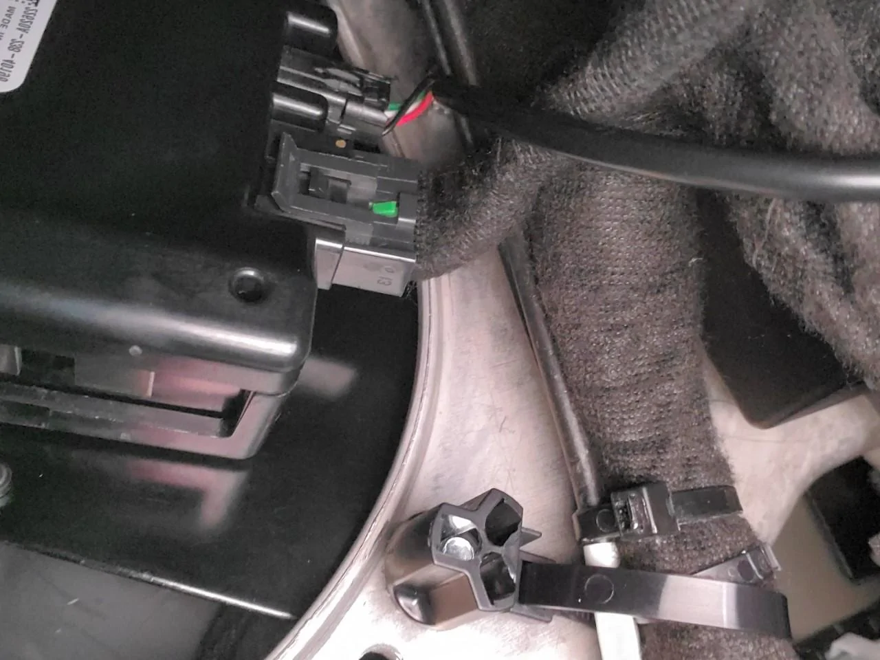

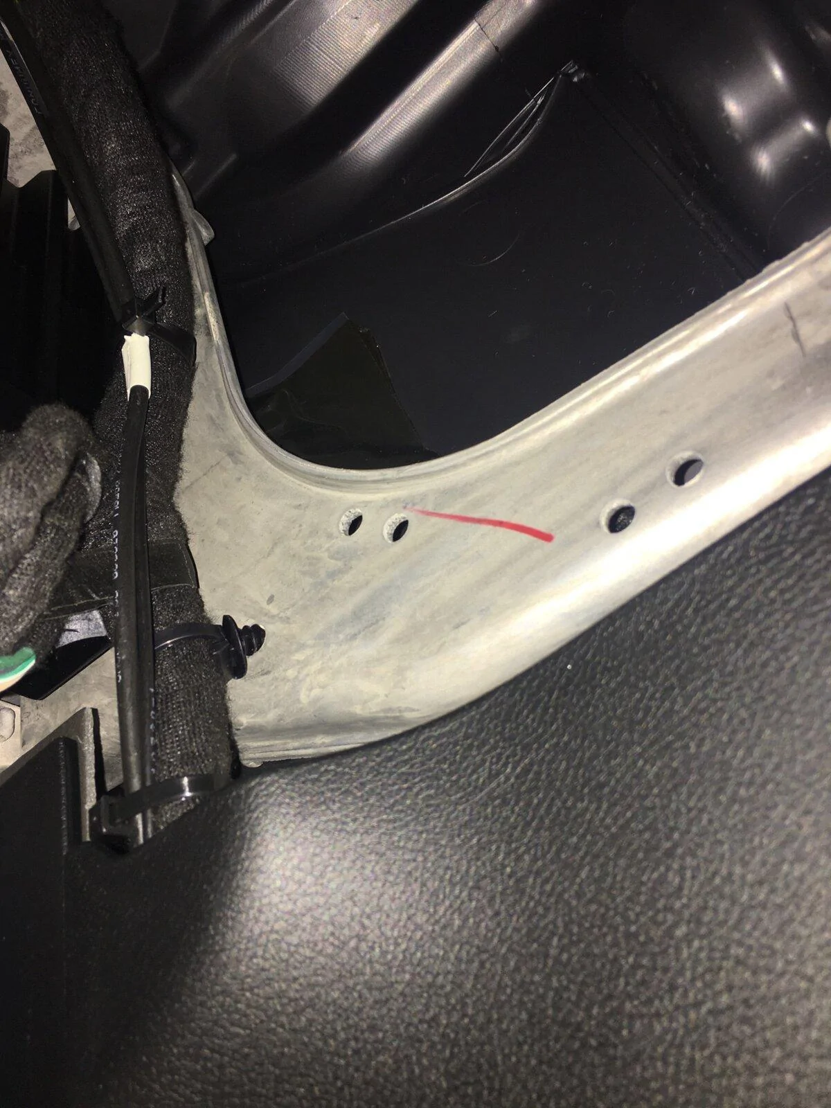

Well here are some pics of my install and a video showing the function. So far mine has functioned without any issue. I have towed my trailer yet but hooked it up at least to test function.
Pictures of module are actually mirror imaged because of the way I held my camera.
Edit. Have to reduce size of my video
Jeep Gladiator Mopar Trailer Brake Controller for Jeep Gladiator Officially Released (Part # 82215652AB) brake module1
Jeep Gladiator Mopar Trailer Brake Controller for Jeep Gladiator Officially Released (Part # 82215652AB) brakemodule2
Jeep Gladiator Mopar Trailer Brake Controller for Jeep Gladiator Officially Released (Part # 82215652AB) brakemodule3
