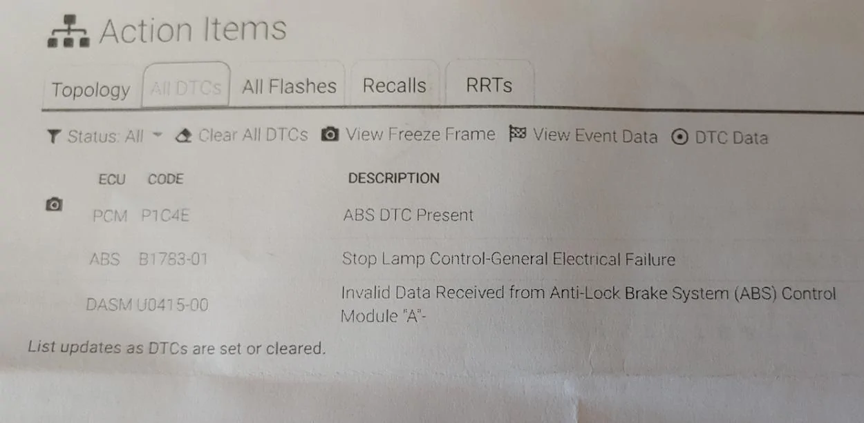

after much debating with the dealership about the wire harness and ECU flashing they were trying to get me to pay for. They came across this STAR report.
Bottom line they are aware the controller isn’t working and there is no fix currently
well looky here!!!!!
WAHOO!!! Well, my dealer tech DID contact STAR, a case was started, he reported the error codes, so if a few others did this exact same thing, we're getting results.
MEGA-MEGA thanks for this!!!!

It threw those exact same codes - and the dealer tech reported to - drum roll - STAR team........

Here's a couple of things to consider based on Jeep's communication -
It's not a harness difference
It's not a controller difference
It's apparently a TRUCK difference - I think I posted elsewhere - "what changed" one of the first questions of troubleshooting.
And since it's the truck - will they fix the TRUCK????? Or, band-aid with a diode?
Does this mean people with later JTs and a Redarc don't need the Ram harness?
EDIT - I READ THE Bulletin again - it says EITHER MOPAR OR AFTERMARKET BRAKE CONTROLLER!
This means the REDARC controller issue MAY BE A JT TRUCK issue as well - please users of other controllers look at that bulletin closely - I think they also mean those who had the SAME errors with Redarc controllers as well.

The codes my tech reported to star team....
