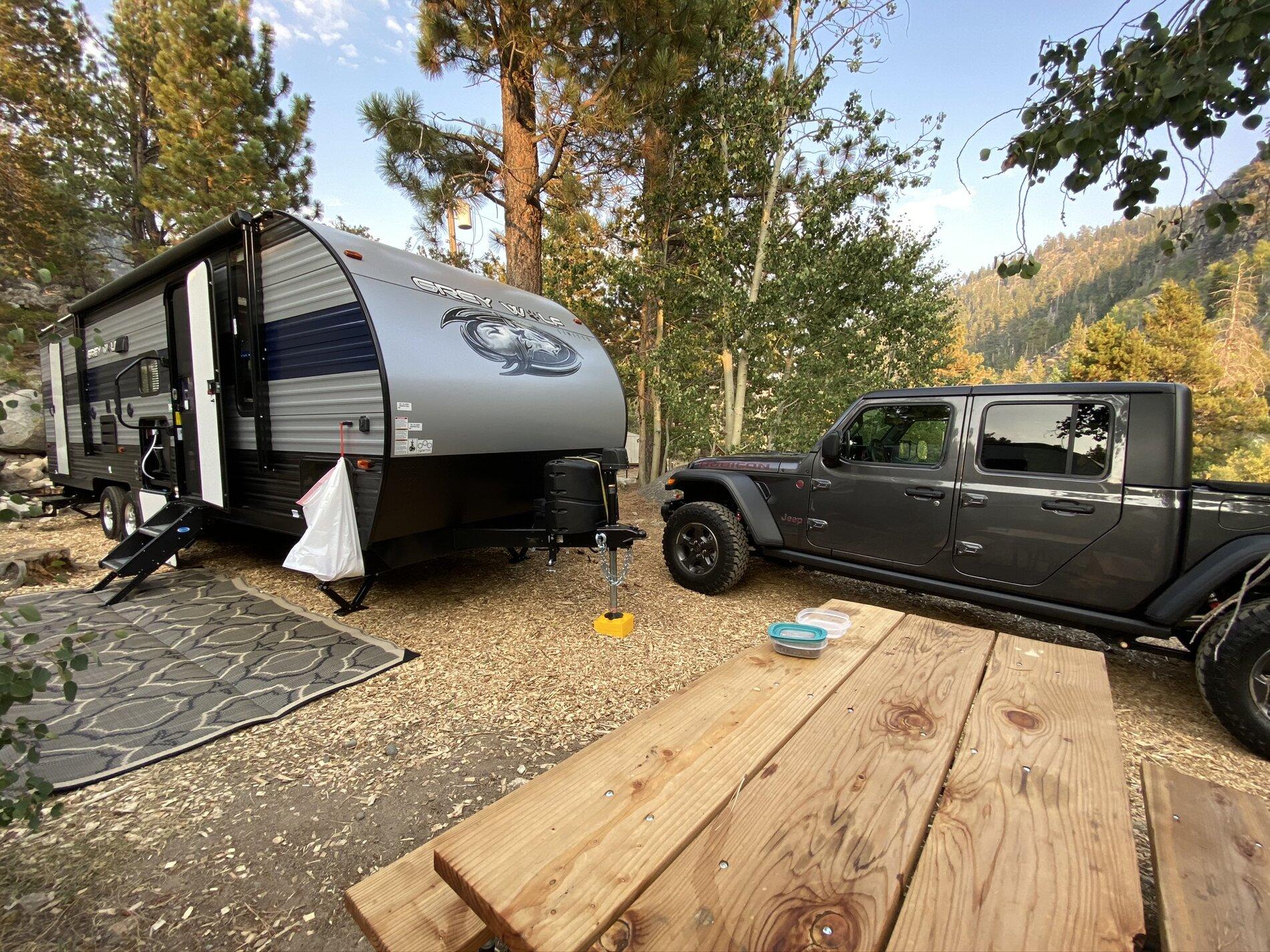

We take our trailer out every month or two. Usually head up to Tahoe, which is a 6000-7000' climb, depending on where we go. I use a sway controller and WDH. Obviously a brake controller too. The truck has zero issues controlling the trailer. I am sure proper setup is half of the reason why it handles so well. My only issue is it is under powered for the heavy loads. I will be regearing it soon to increase the torque. Other than that, I am perfectly satisfied with the towing our travel trailer with. I get excited when I go pick the trailer up from its storage location.
I should mention I am a slow poke towing. I don't go over 60mph and usually am between 50-55.
Nice set up? Can you provide more details about your trailer? Live in the bay area and looking to get one similar? Thanks!

It’s a grey wolf 26dbh. To be honest I wouldn’t go with something this big. It tows it fine fine but with family in the truck we are not far under the gladiators GCVW. So I’m always watching what we put in the trailer for a trip. Total weight nazi when we are packing. If we do decide to bring a lot of stuff, my wife follows with your girls in her car. If I were to do it again I would go with something 5000-5200lb range. That way loaded up with whatever I wanted to put in it would be still be under or at 6000lb. They make a grey wolf 23dbh, which is the same, minus a couch.
