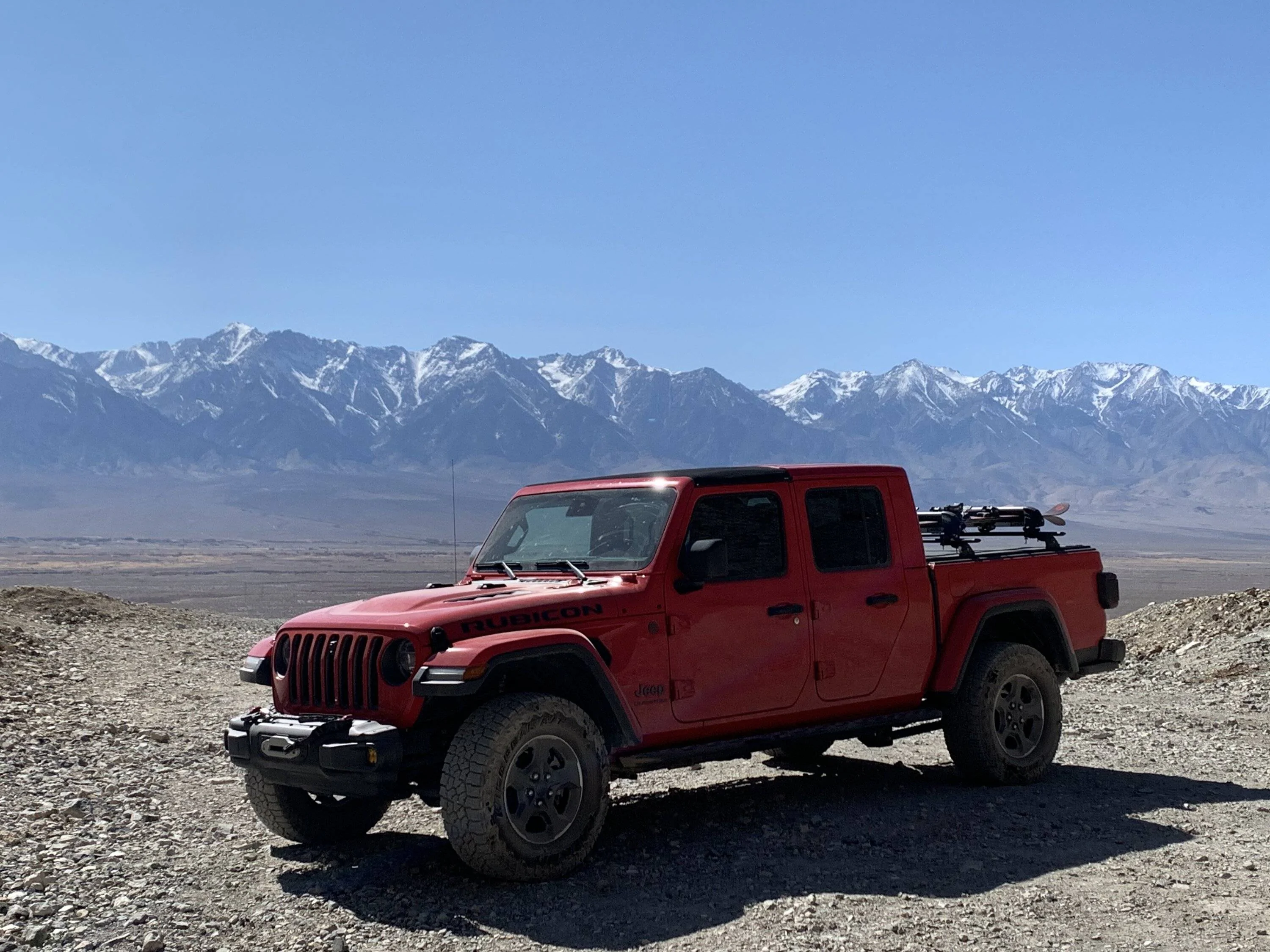

Finally decided to put together a build thread. This was my first Jeep and wasn’t sure what I was aiming for, so I’ve learned and changed things along the way.
This is a daily driver with intention of driving family around and occasionally going camping, hauling family stuff on trips, and occasionally off-roading balls out.
Started as JTR with aux, Alpine, metal bumpers.
Jeep Gladiator Mx5red’s JTR build thread IMG_8253

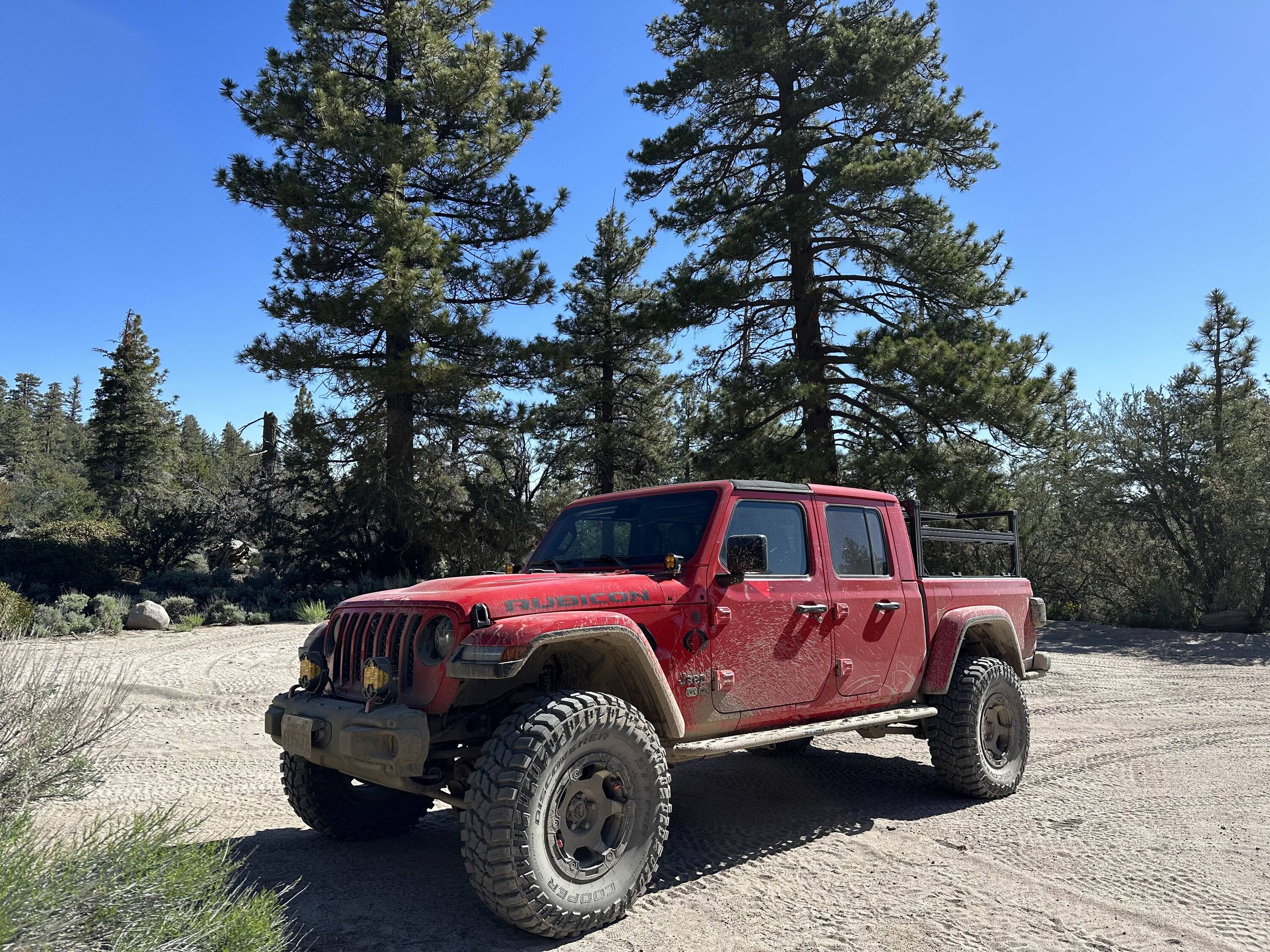

As of now, Clayton 2.5” springs, HD in rear, Mojave take-off shocks, 37” Coopers on Teraflex Nomads.
Jeep Gladiator Mx5red’s JTR build thread IMG_3575

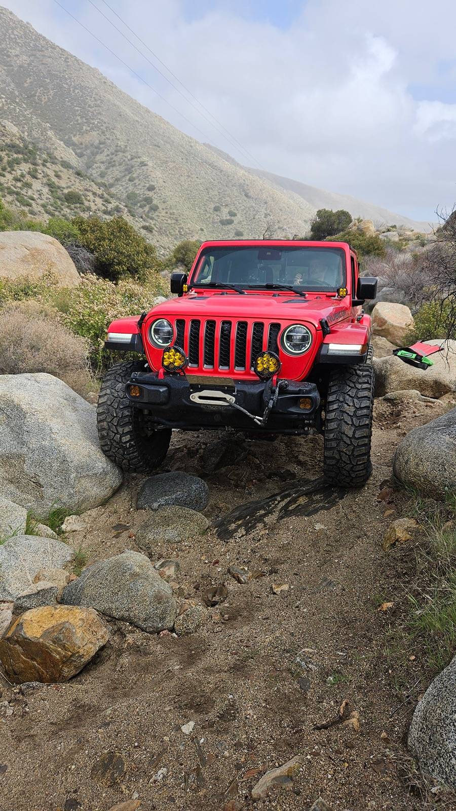

STEALTH Smittybilt H2O 12k winch mount
One of my favorite mods. Covered by flip up license plate mount (forget brand, maybe RR)
Manual cutoff switch for battery power which runs winch, and Anderson connectors which hook up to the Smittybilt compressor so I don’t have to use battery clamps.
Smittybilt 2781 compressor with Anderson disconnects and high flow fittings/hose and Jaco L2 chucks
Replaced Smittybilt winch hook with Smittybilt winch hook?
cheap Amazon soft shackles, snatch block, OVS rope snatch block, tree saver, snatch strap - because what better place to save money on, than safety?

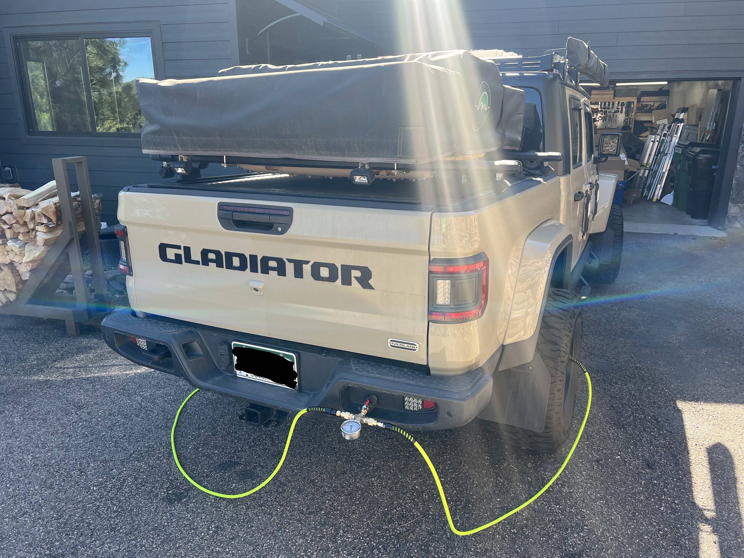

Bak revolver x4 bed cover - like the integrated rails

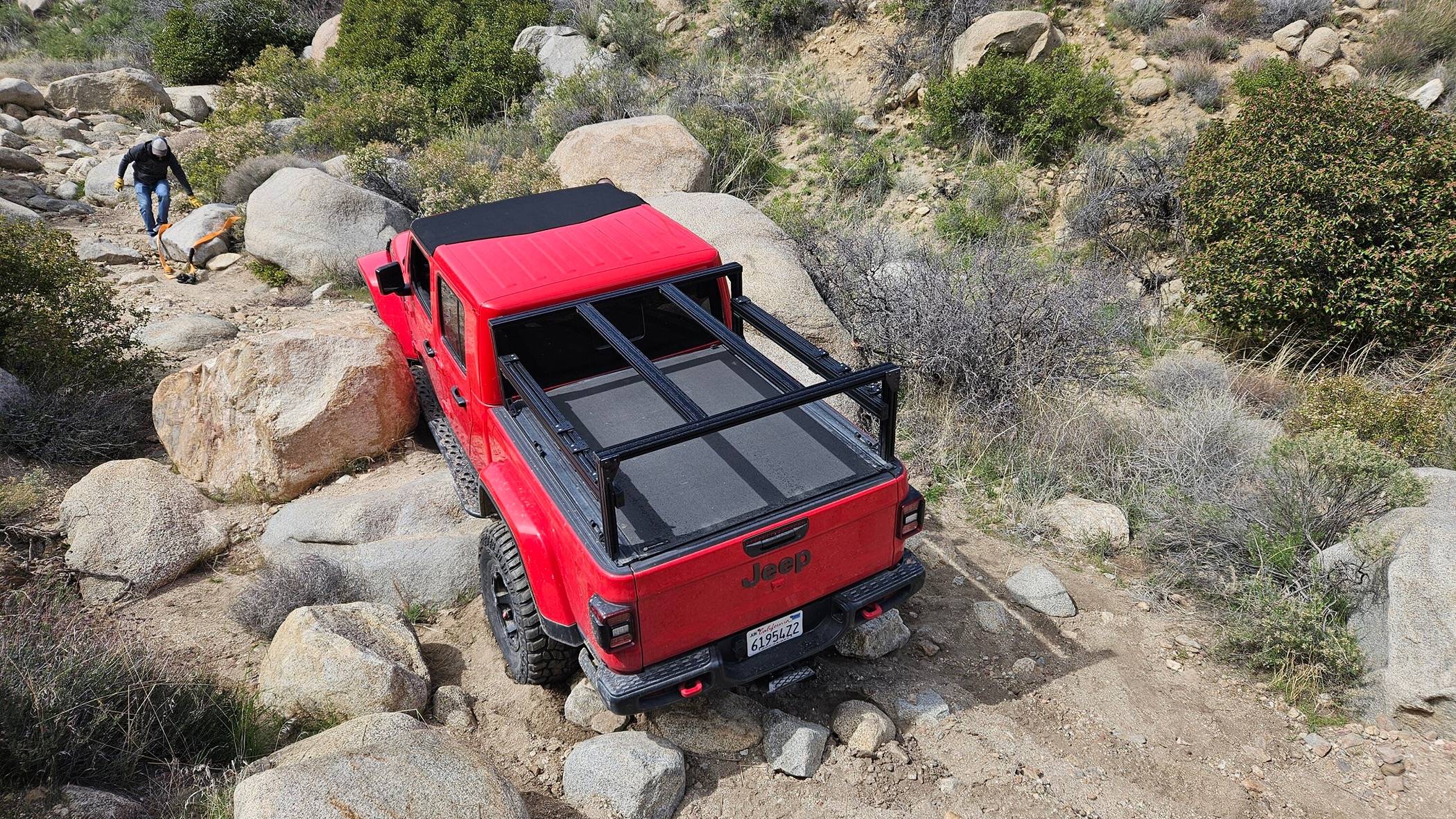

DIY bed rack from 80/20 with slide-out rails, an extrusion overland knockoff. Shortened it from 23 to 18.5”.
Cheaper/lower versions may be worth it, but mine probably wasn’t. I don’t like the look but especially with a new dog, a bed cap such as RSI or ARE may be in my future.
Plus, I would’ve bought a fridge already but not many fit under a tonneau.
I have also used Yakima cross bars with ski racks, and bike mounts. That was pretty useful for me before, but I thought @DrJ had a better setup with a retractable tonneau.

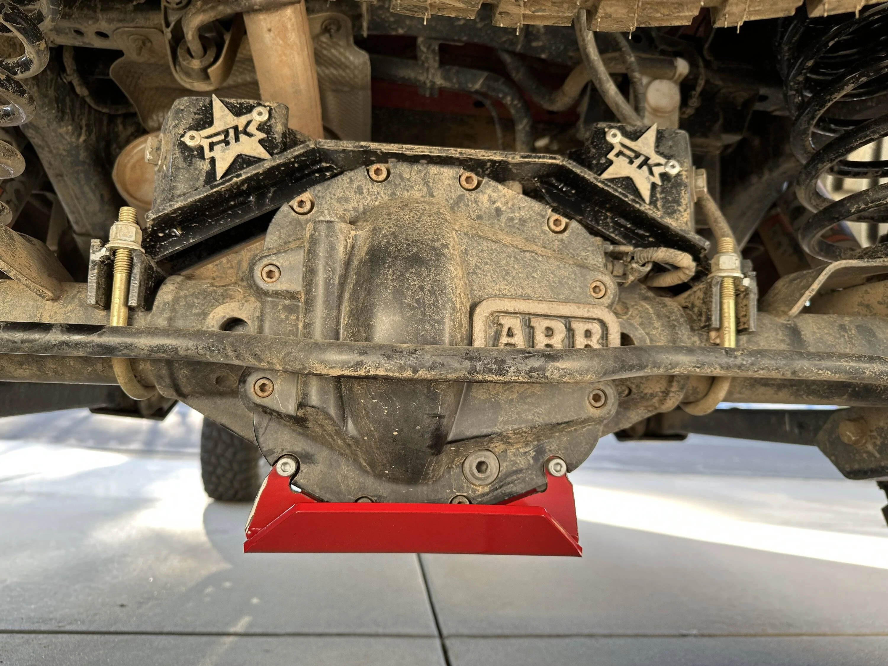

Rancho front diff cover and skid
ARB rear diff cover
Racho rear diff skid mod to fit ARB

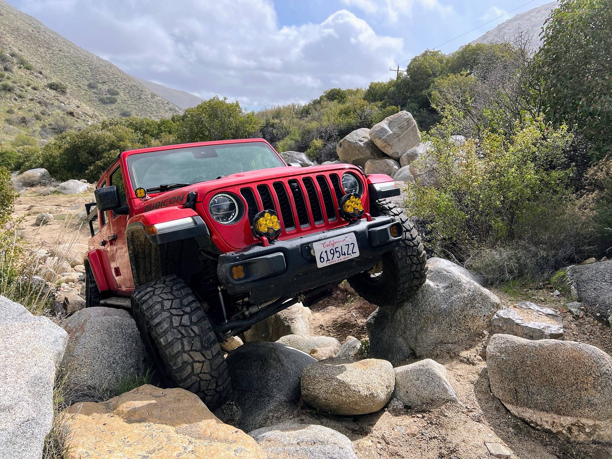

Baja Design squadron pro ambers - love these for off road, but spilled too much light
when used as fog lights. Moved to a-pillar and rarely used now.
Diode Dynamics SS3 max yellow fog lights - sharp cutoff, works great as fogs. Prefer Baja Designs color though
Baja Designs LP6 - super bright!
Oracle rock lights - trash! overpriced
Full disclosure I attempted a knockoff DIY Gatekeeper Off-road steering knuckle light mount but it didn’t work.. still may try the Gatekeeper ones as steerable driving lights.
Bed light install with LED strips.

The stock Falken A/T are great tires!
Bought some rough, used 37” Goodyear MT/R to try, they could not be balanced.
Bought 37”cooper STT Pros and have been happy with them off-road. They are noisy! I switch back to OEM Falken 33s for winter or towing.
If I had a longer commute or didn’t switch winter tires I’d definitely do A/T like a Mickey Baja Boss or larger Falkens, don’t think there’s any downside unless you’re doing thick mud like in the SouthEast and truly need a mud terrain.
I like the Teraflex Nomads. Deflate quickly, but I need a 3D printed wrench to help get the caps off.

You did a great job on the rack. I'm looking into making my extrued aluminum rack in this vein. You mentioned you don't like the way it looks though. Why is that? Also do you have any pictures of it from the front of the jeep? I'm wondering what it looks like square from the front looking back.
mx5red
mx5red
Paul
May 7, 2020
1,537
2,417
San Diego
It must’ve grown on me, I think it kinda fits now. To be honest I haven’t really utilized it well. I made the slide outs thinking it would be useful camping, being able to access stuff mounted closer to the front of the bed on the inside, while being able to mount on outside as well. I daily mine so I don’t drive around town with a bunch of overlanding stuff mounted all over?
So aside from strapping big cargo bags for a few trips I haven’t utilized the rails/rack, they usually sit empty.
The Bak rails are set in a little, so even with the upright legs (not angled like most racks) the top corners are still pretty even with top corners of the cab, they don’t stick out.
