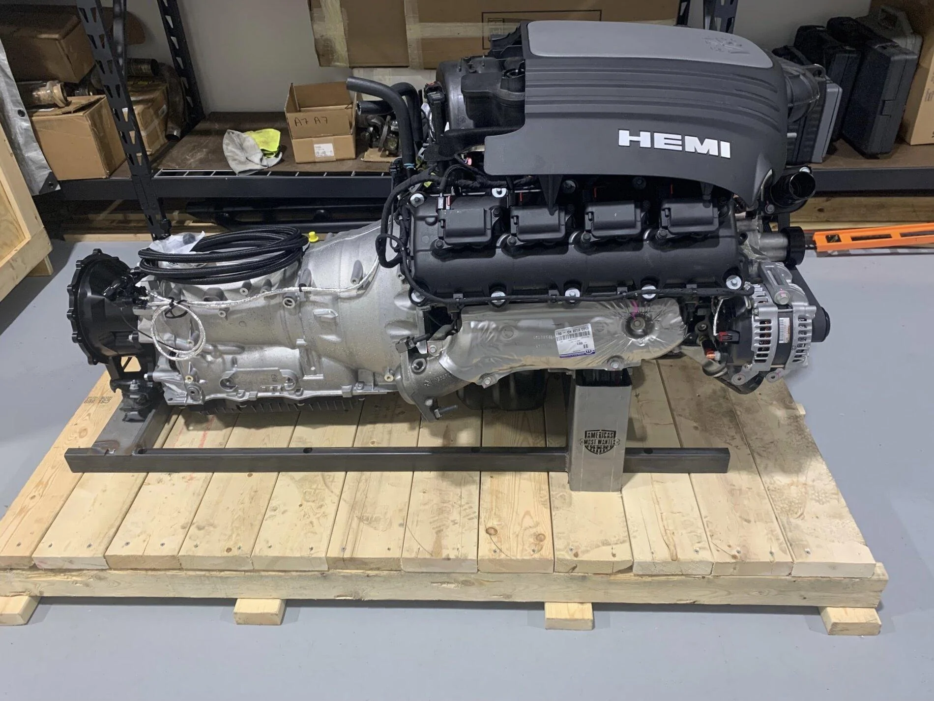

I have a 2020 JT Rubicon running a 2" Mopar lift and 37" tires. I am a long time Jeep owner (5 builds) and have always ALWAYS wanted to do a Hemi Conversion. On my JT I strongly considered it but then decided to go with a less expensive alternitive and supercharged. I honestly thought I would love it but quickly found why it was a 3rd of the price and absolutley hated it. I can't say enough about the supercharger company and they were honest to god good people. The supercharger option no matter the manufacturer just isn't for me. It was soooo far off a stock feeling drive, the power wasn't were I needed or wanted it, it was awful for hauling, etc etc etc.
Anyways to the exciting part. After being disappointed, I called and started researching compaies with the best reputation for Hemi converstions. I spoke with several companies and from everthing I could find AMW4x4 is the absolute best in the business for so many reasons. Anyways, fast forward a month or so and my JT is currently in Holly MI at AMW4x4 getting its Hemi conversion as well as a handfull of other parts and upgrades. I plan to keep updating as the build goes and a review once I drive it home.
I decided to go with the 5.7 over the 6.4 on this build. I have owned 10+ 5.7's and currently own a 6.4 SRT. I decided on the 5.7 for several reasons:
Fuel -The supercharger required premium fuel. I didn't think it would bother me a bit but after a few fill ups.....it really did piss me off a bit that I had to run premium and the performance wasn't much better.
Economy - I like driving my JT alot......the 5.7 offers 415 hrspwr and 400+ in torque. I will see better fuel economy and just all out be happier with the 5.7. Seriously....I don't need my lifted truck to be a sports car. Many people don't agree with me on this.....but I have a 6.4 for when I want to drive it.
During its time at AMW 4x4 it will be getting a complete new powertrain amongst some other goodies - engine, transmission, full exhaust, drive shafts, differntials (5.13s), updating the lift to a AMW custom long arm 3" lift specifically for the Hemi build, fenders, fender liners, and some other small hardware and badging.
Here are two "before snaps" and a few snaps of the work in progress. I will try to keep pictures and updates pretty regularly. Feel free to reach out with questions or comments!
Also - I have a stock 2" Mopar lift in mint condition (6k miles on it) for sale. This will come with the front adjustable track bar (Teraflex) and an adjustable rear track bar (Evo).
