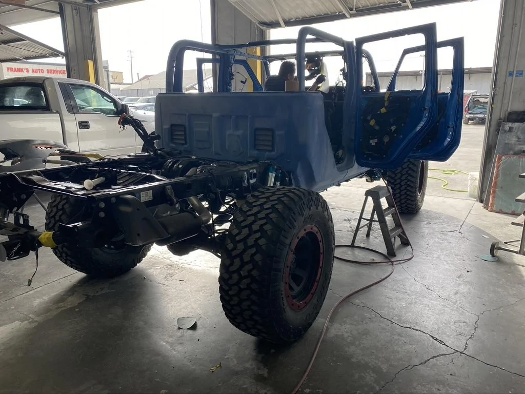

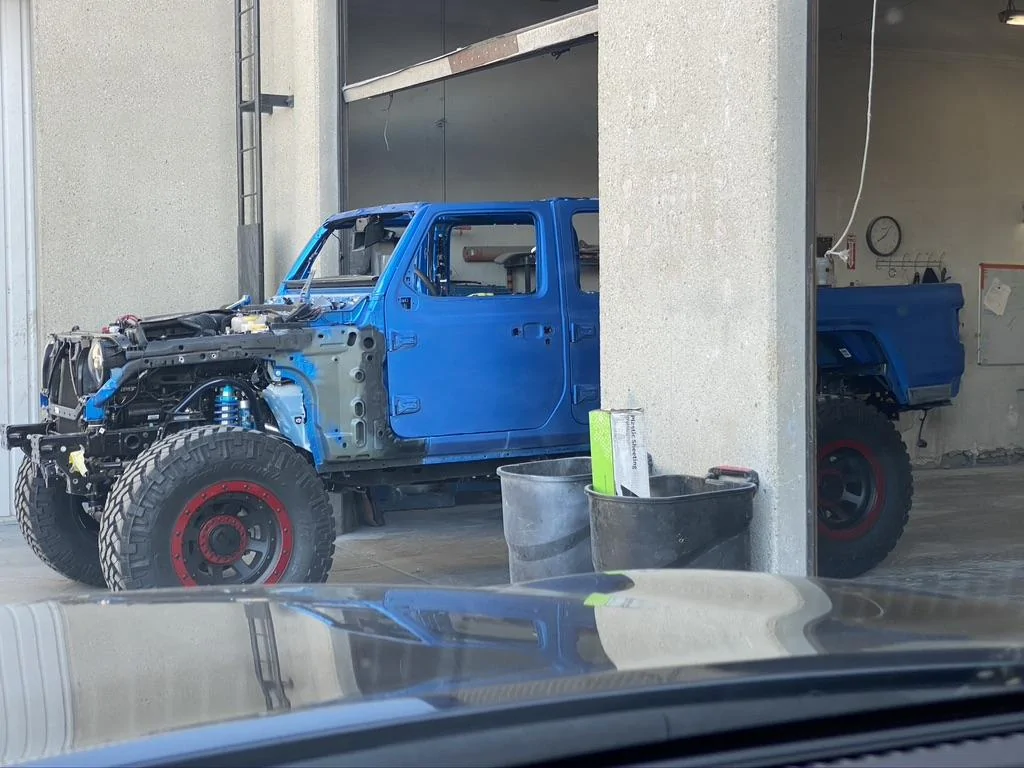

Well we ripped my 2021 JTRD to the frame almost for kevlar and the suspension and other than moving things around (washer fil, air box etc) the springs were a bit stiffer and the transfer case in a slightly different location, yes it was a bit heavier. We weighed it at all 4 corners at King for the proper valving and Rebel dialed it right in with the springs and such.

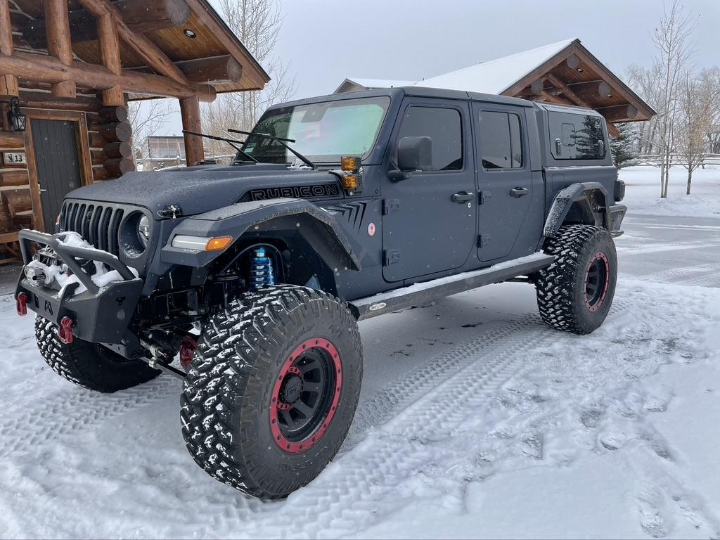

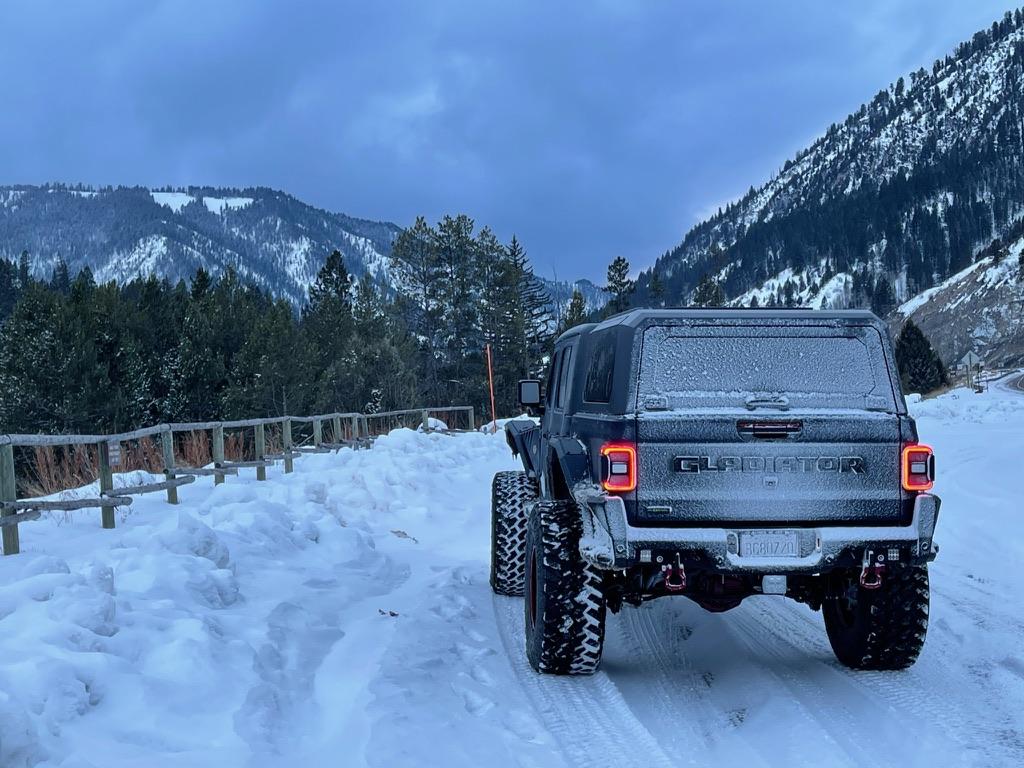

Thanks! Been a bit over a month since its all done and have over 6000 on the OD. Been on a few epic road trips to Idaho in -6 weather with snow all over and some rock crawling. Mostly for overland adventures. We love it. Had the 2020 JT in gas and loved it, put 20K miles on it in a year so I have a true apples to apples comparison and by far for me, its amazing. I love the fuel mileage and mostly the torque. It is endless.

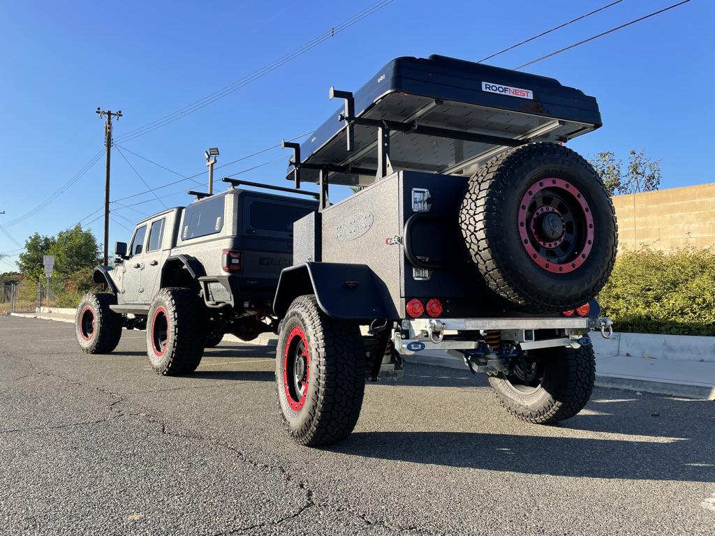

That's an amazing build. What's your cap and what's the trailer? Been looking at the small Vorsheer but it's so pricy for a small trailer ha ha.
Thank you. Its the RSI Smartcap. The Trailer is the Tuff Stuff XT. They are not cheap for sure. I realized when talking to people about the trailers you pay for what you get. Mine is about the lowest price point for independent suspension as well as all the pull out drawers etc with the off road hitch. Trailer performs so well and I dont even notice it on my diesel.
Did you re-gear or are you still on stock gears (3.73)? And are those 37s? If you are happy turning 37s and pulling a smallish trailer on stock gears that is a pretty strong endorsement for the 3.0!
So...they are 40s. I did regear to 4:88. To be 100% in line from a mathematical point it was between 4:56 and 4:88. I am glad I chose the 4:88s. 70 mph no trailer I get about 22 on flat ground. With trailer about 19 ish. I rarely drop out of 8th unless its a steep hill. Axles were not ready at time of the initial tear down so that will be a project for later this year.
