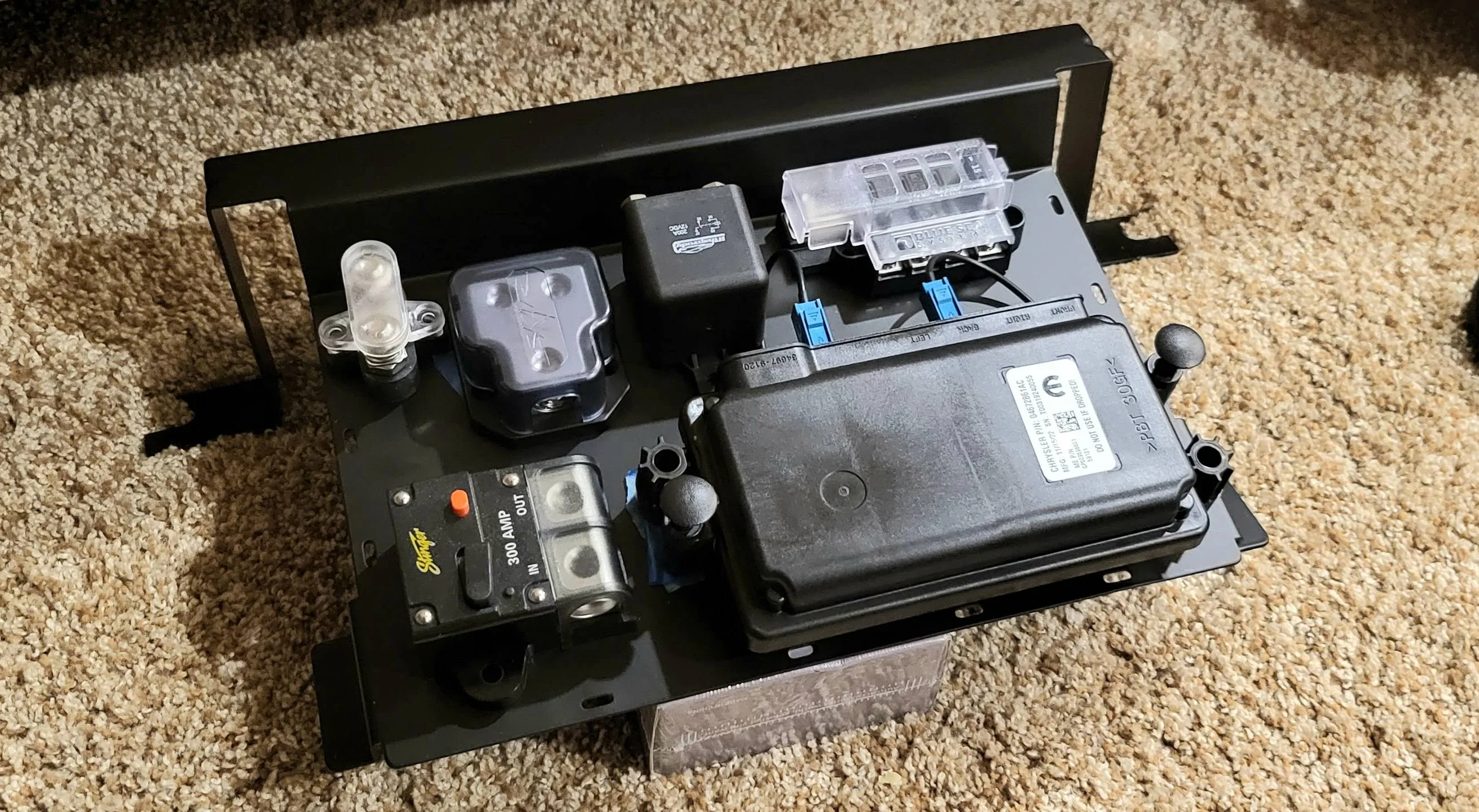

@ecidiego Let me make sure it fits!

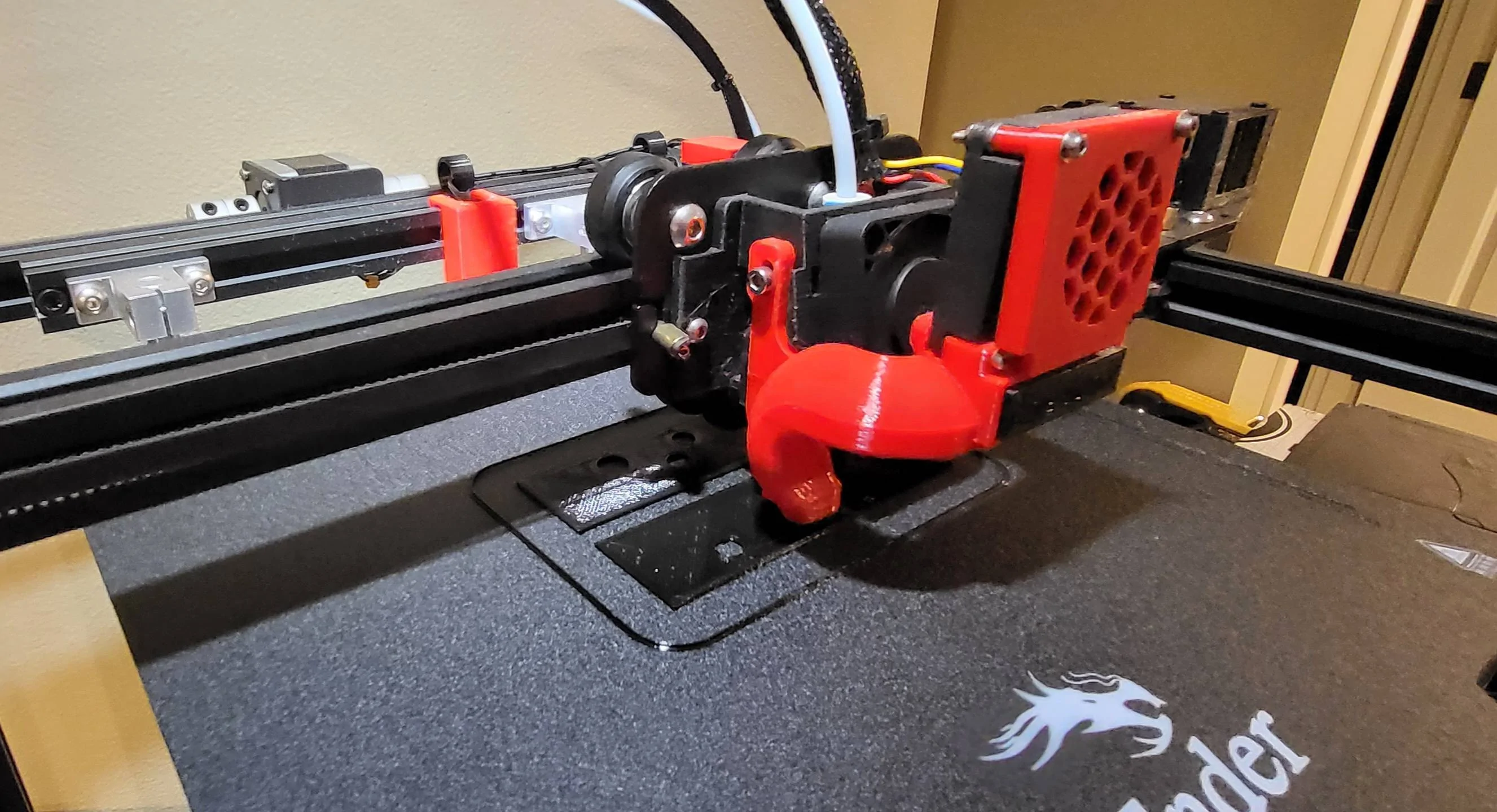

3d Printing brackets for the CVPM.
