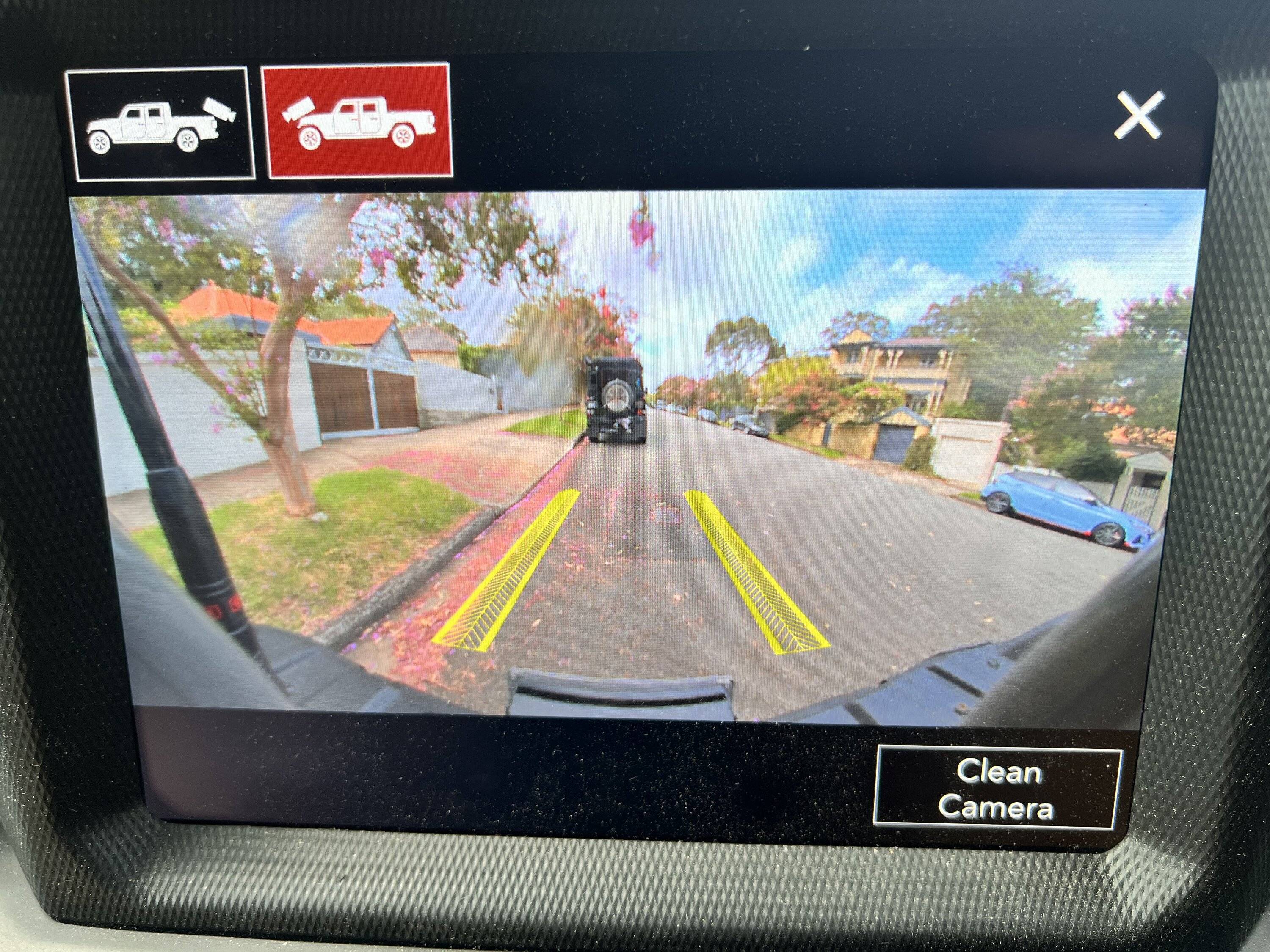

So, jimmy07 sent me a shorter harness, and the cvpm is neatly installed behind my glove box.
Everything is working perfectly, so I can confirm this works on Australian models.

Would love to see a pic of the CVPM mounted behind the glove box if you get a chance.
Apparently there’s a lot more room in there on the Australian models.
I had my 2 way mounted in there, I removed that, and installed a mounting bracket I fabricated to take the CVPM, then rd installed the 2 way over it, so I can’t really get a photo without pulling it all apart.
Can definitely confirm that that CAN block works though

Another fun fact, in case anyone else in OZ is doing this, the front camera wash hose doesn’t quite reach the correct outlet on the pump, so I switched the hoses around, and therefore didn’t need to reverse the pins on the pump plug.
Works perfectly
Works perfectly
LOL. That makes perfect sense... I wonder why the factory had done it such a long way.

What RustyC did in essence is reversing the wire.
I just did not know how the pump exactly worked but from what has been learned, I can see that BCM changes the direction of pump rotation and that determines the fluid to go to different ports. You reversed the ports and left the wiring the same. Previously, wire polarity was reversed but left the outputs as they were.
I say reversing the hose is easier and less invasive option of the two.
A question for RustyC, does it also spray the TrailCam when windshield is sprayed?
Those who did this orthograde, does Trailcam spray command also spray the windshield? And when the windshield is sprayed does it spray the Trailcam?

Wouldn't be possible to reverse hoses on my truck. Cam hose will not reach. Rusty's is different because it's an aussie truck and not laid out like ours.
