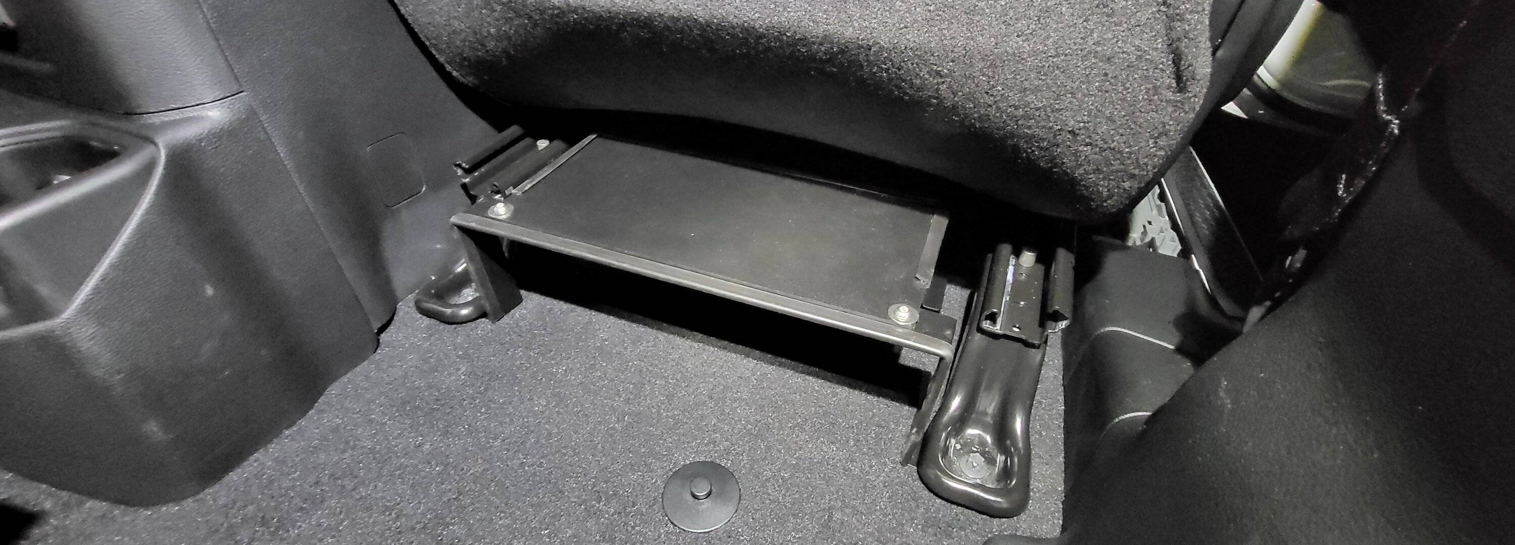

My underseat mount is installed.

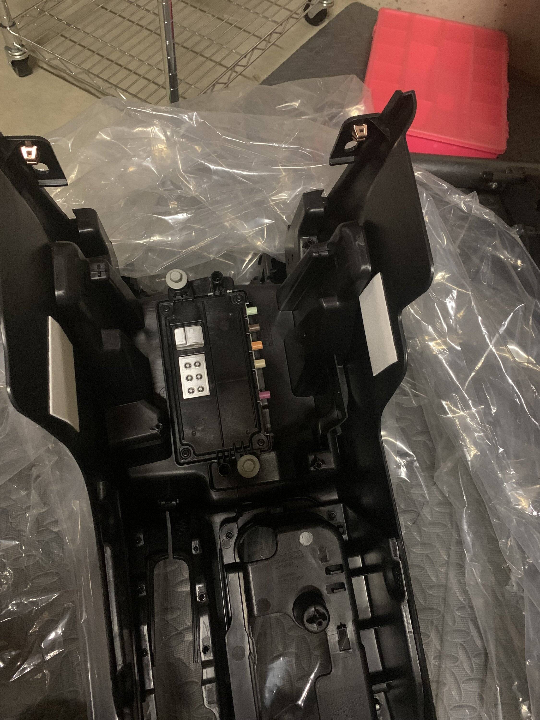

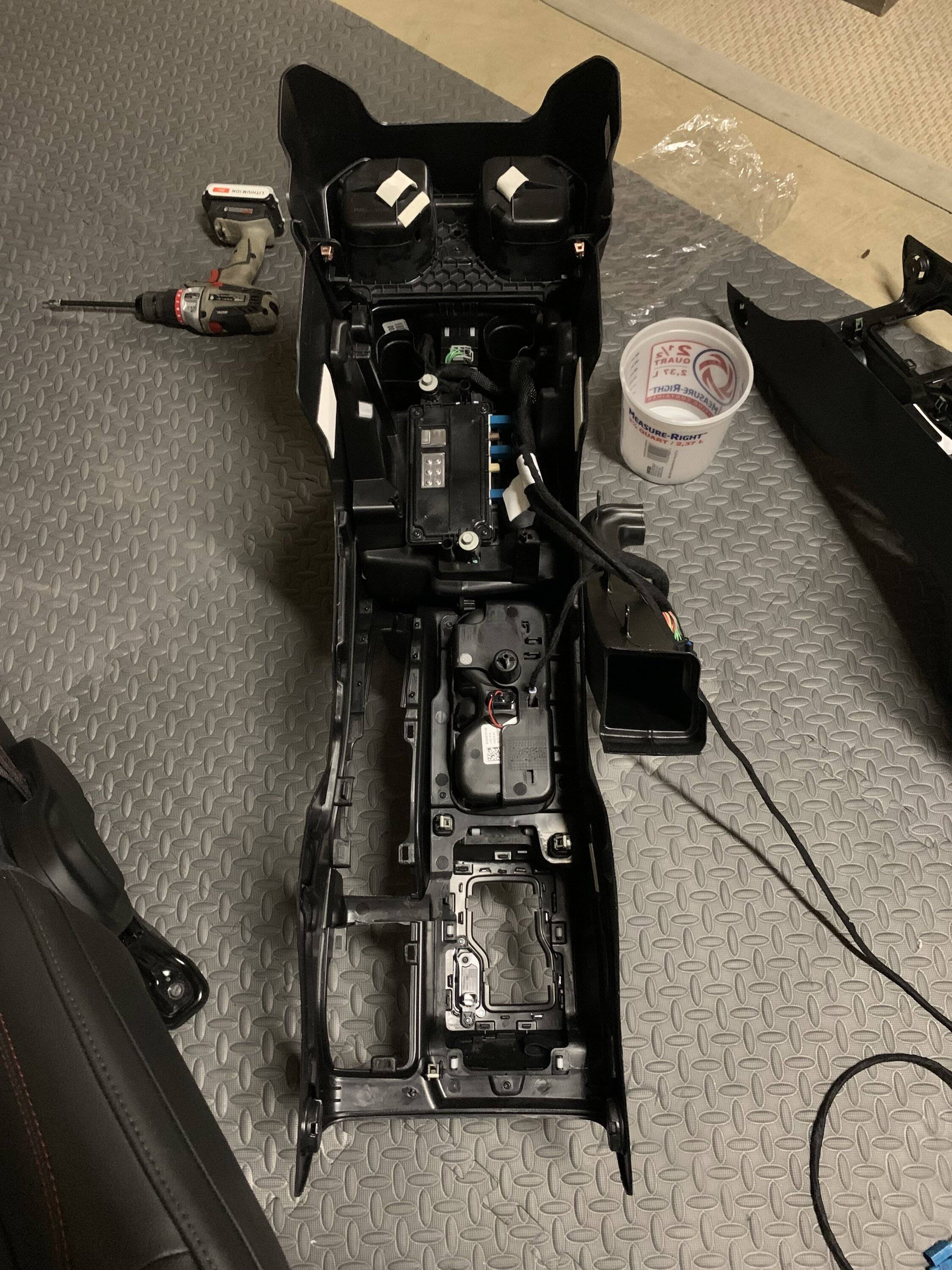

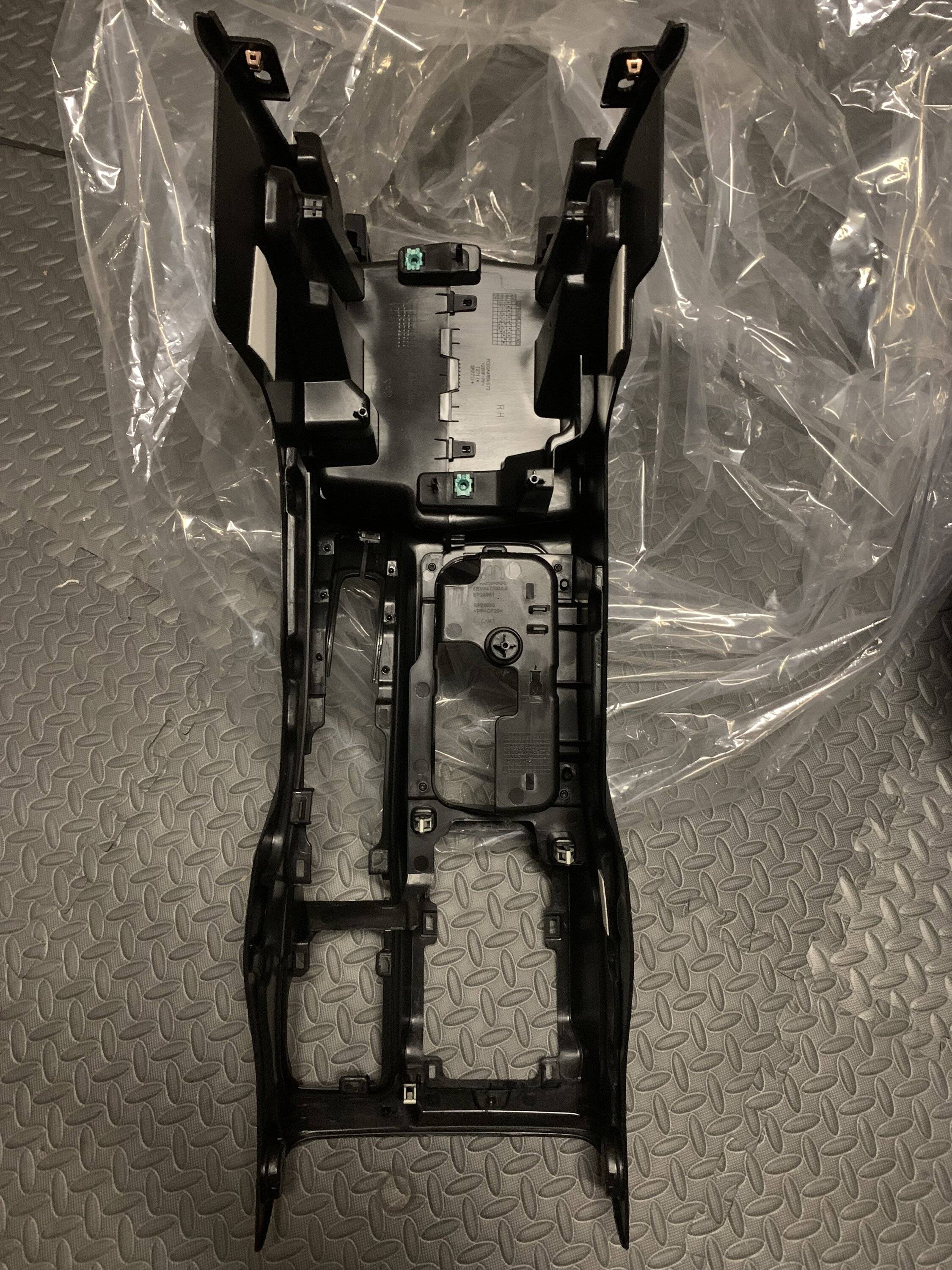

Came from a trip and had a few parts waiting for me. One in particular the wrangler center console I spoke of above. Yup, it definitely has a spot for the CVPM. As soon as I have a few open hours I’ll confirm it fits in our vehicles.

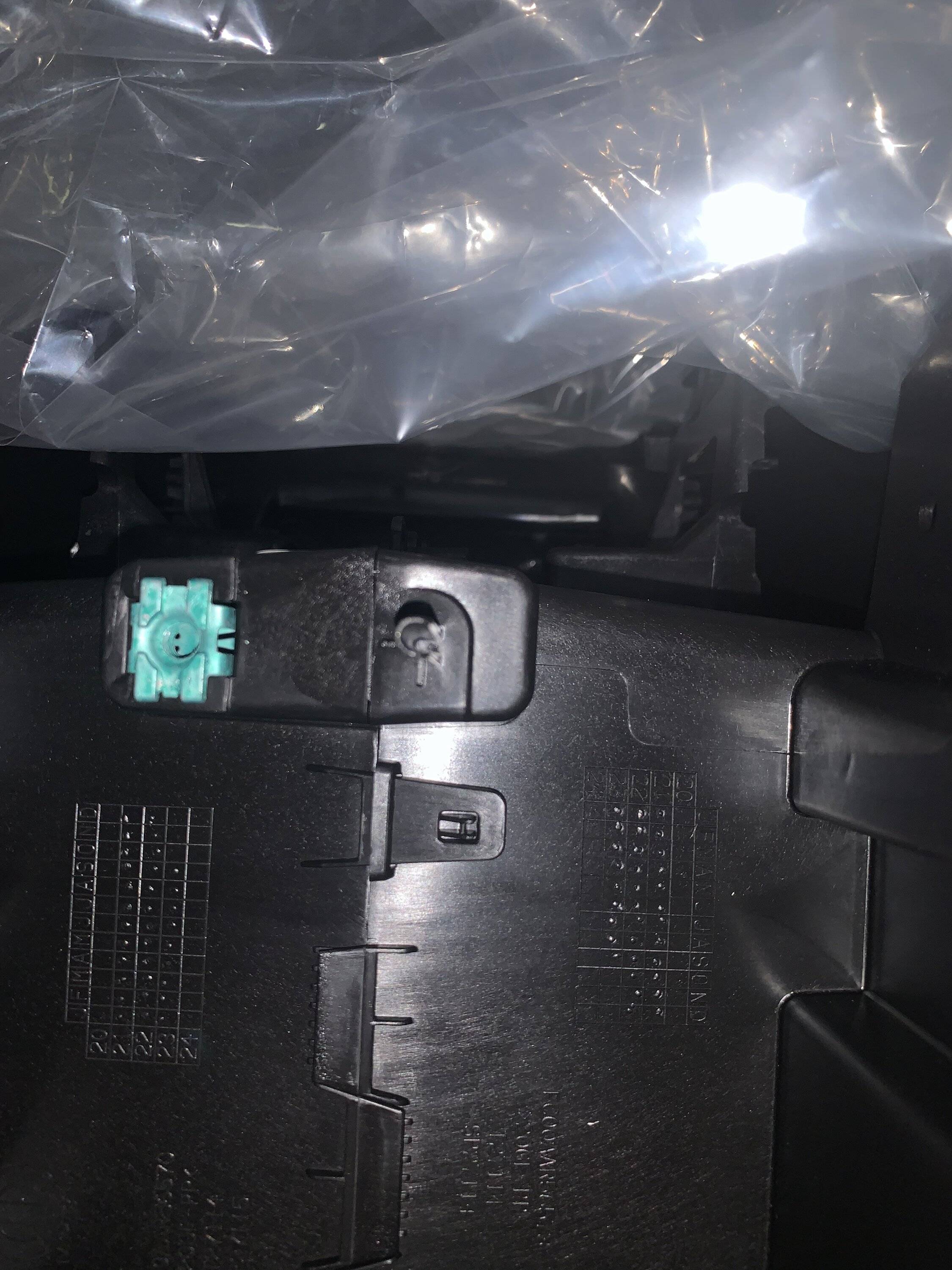

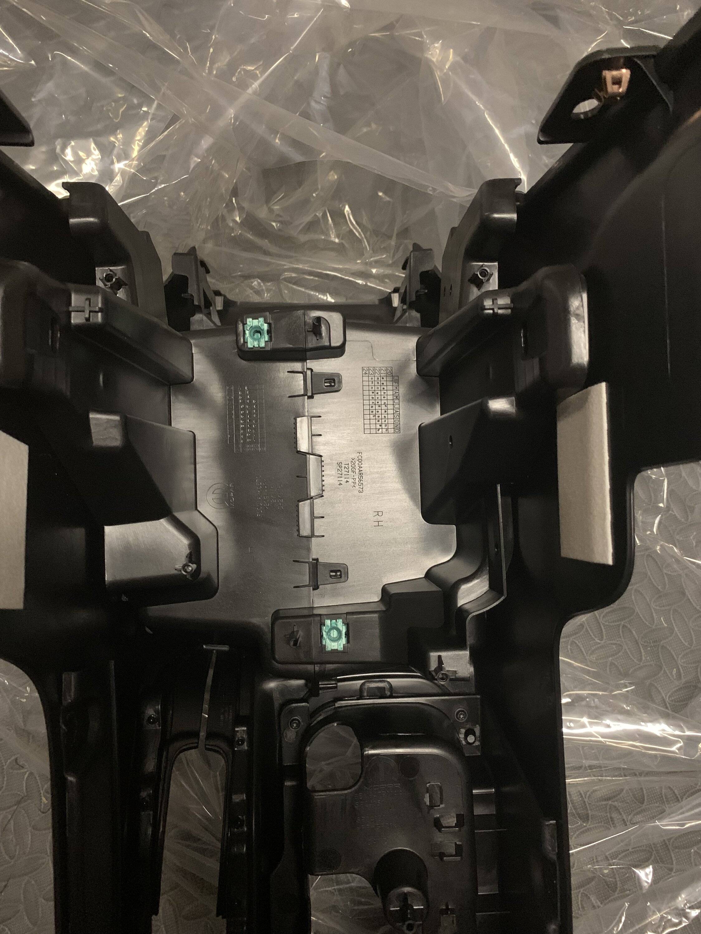

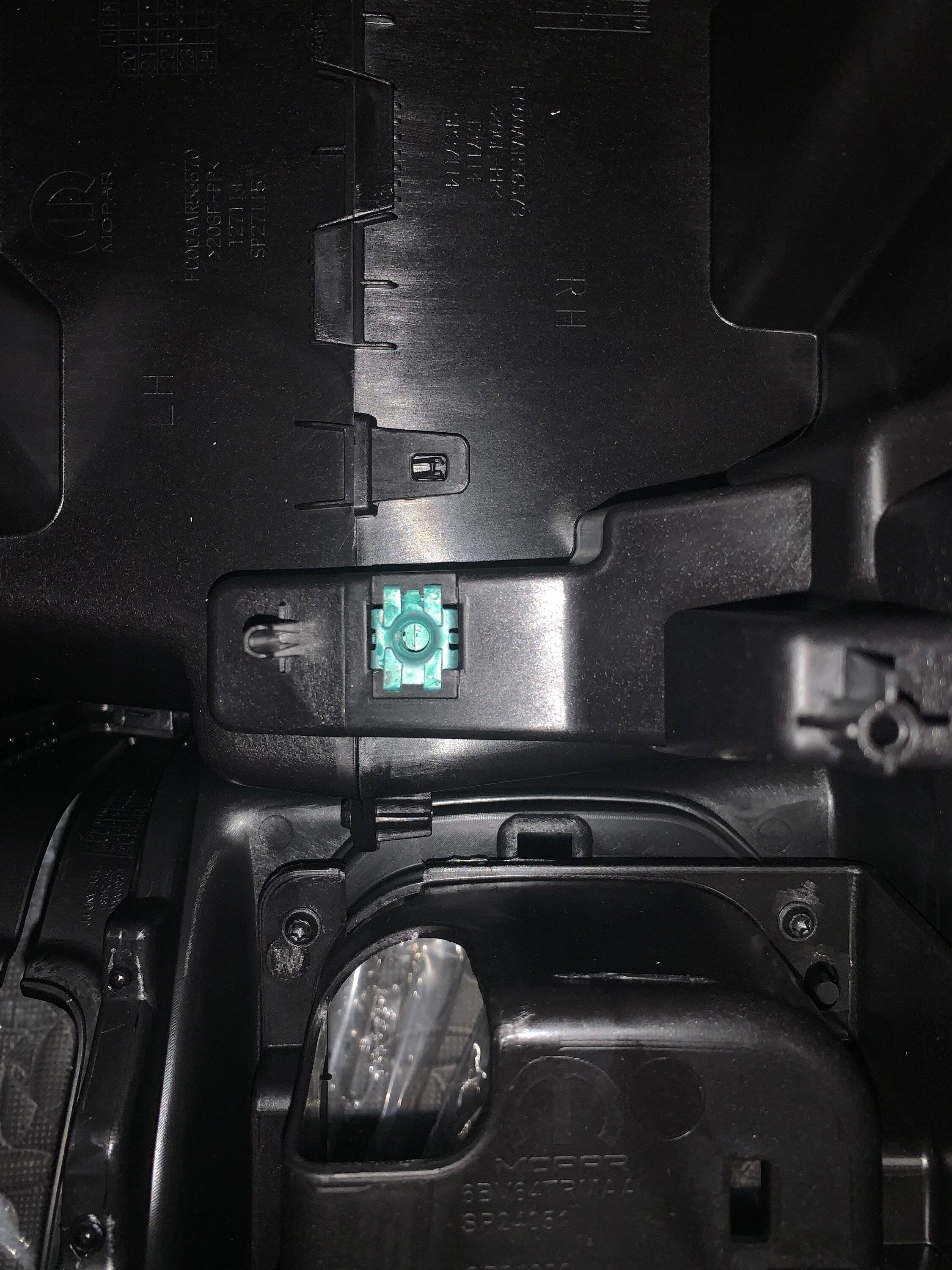

EDIT: I did a little closer look at the JL diagram and this is actually how it fits in. The center console came with the metal CVPM snap nuts (green things in pic). Looks like you use the CVPM Bolts to attach it. The bolts seem a bit long but I don’t see any other shorter hex flange head bolts that are on any other diagram. The green snap nuts are the exact same as the ones required for Jimmy’s install just green for some reason.

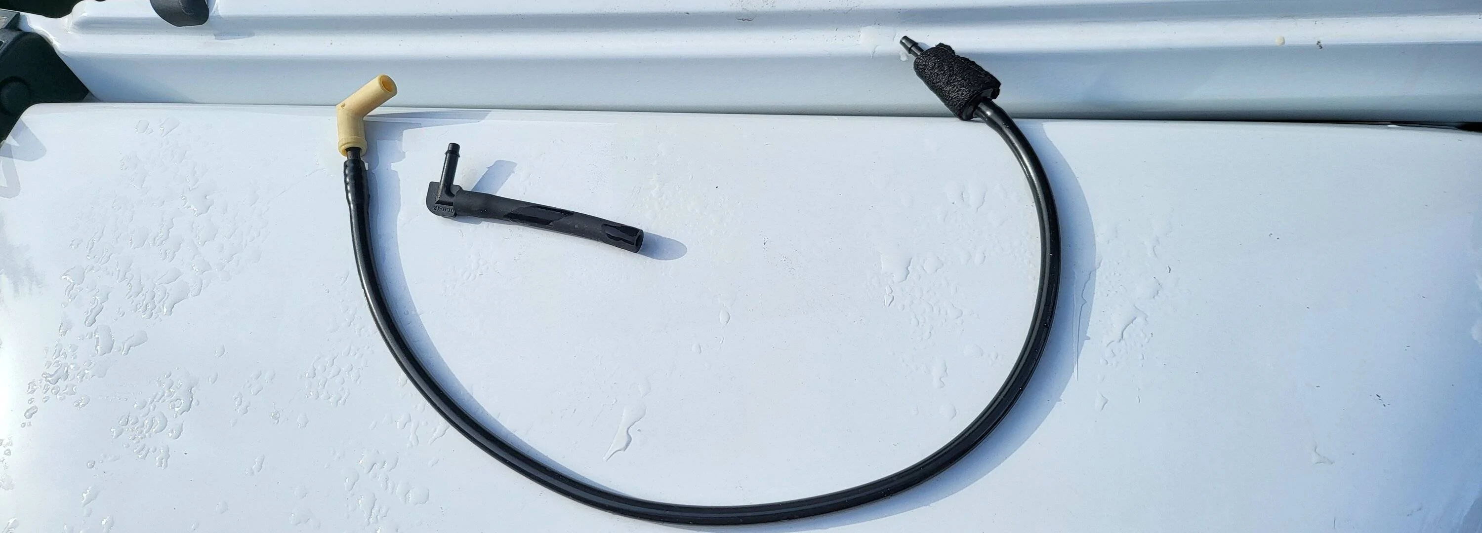

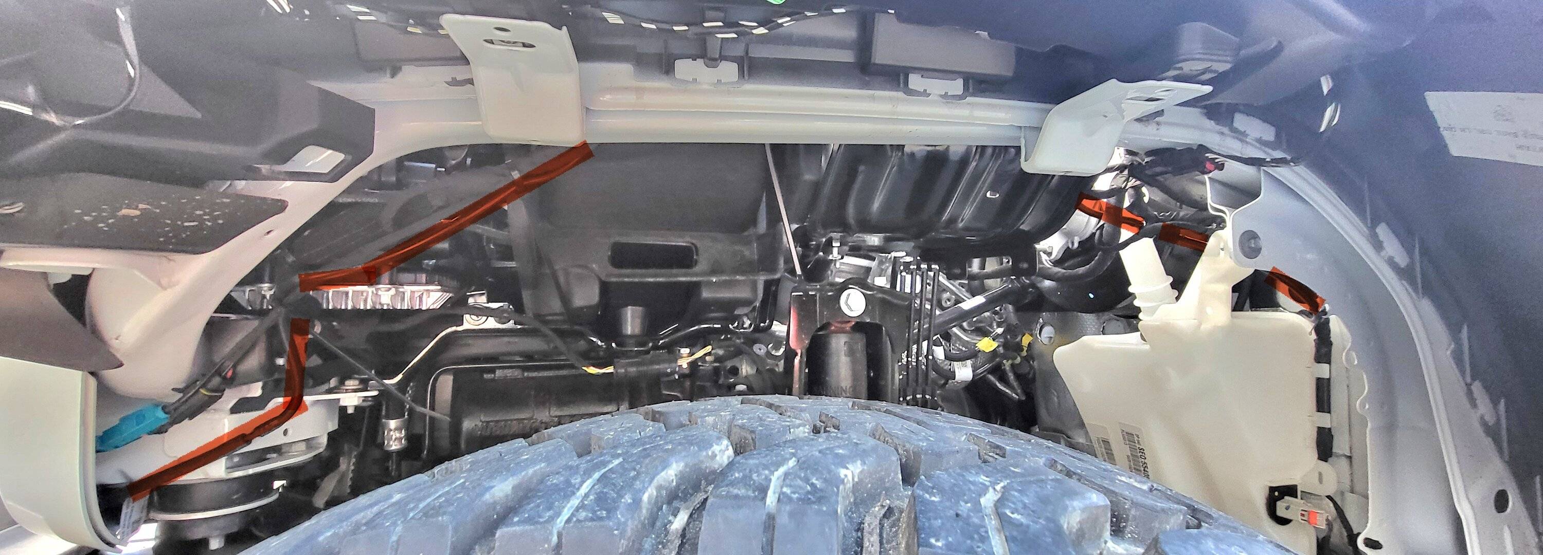

I am all buttoned up with new headlights, iDash with stealth mount, RedArc trailer brakes and rear power outlet, Recon flare extension. Gotta figure out the halo. Installed the diesel specific harness.
Nontheless, Didn't use the power cable for the washer.
Completely remade the hose from the bottle towards the front.

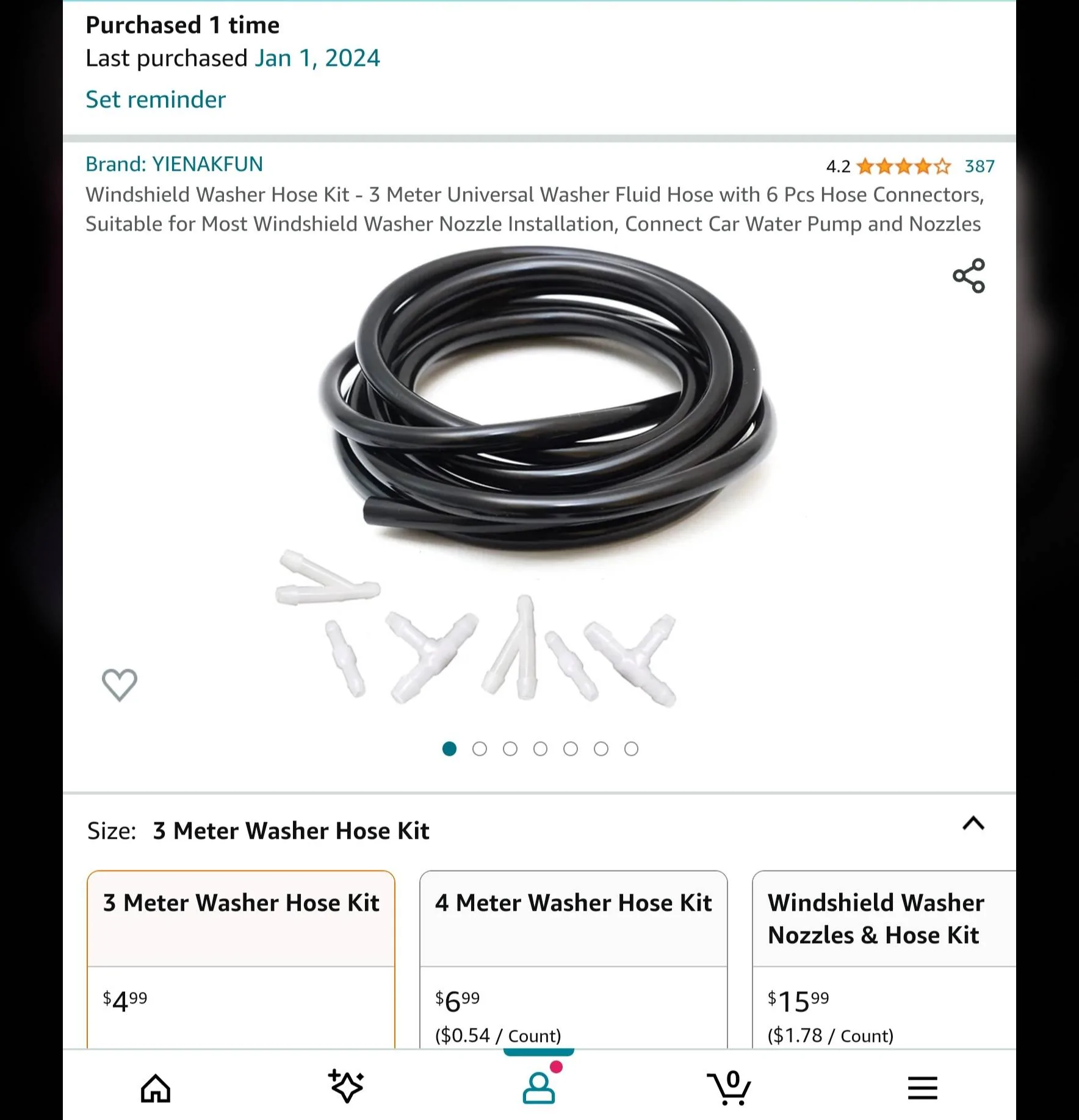

Yeah, what a b!tch. I was wondering why you made a hose and now I know. The one we thought was the correct part number from all the MOPAR diagrams for the diesel is actually the one from the pump to the windshield. Looks like I’m in the same boat. Any advice on making the hose myself such as length, OEM hose material, and routing?
Updated on my thread with links on what I used. I used the ends on the short hose and extended the middle section. You do need the ends (specially the end that connects to the front hose) and possibly little filter (I think) in the middle. Hose cost like 5 bucks and connection/fitting I already had for other projects.

1. I did not switch any wires. There is no connector you can undo to remove the washer bottle harness in JTRD. Making the harness from the part list completely useless.
I connected the TrailCam washer on the left side of the pump and the windshield washer output on then right.
2. I did not use the wiring harness. I could not use it.

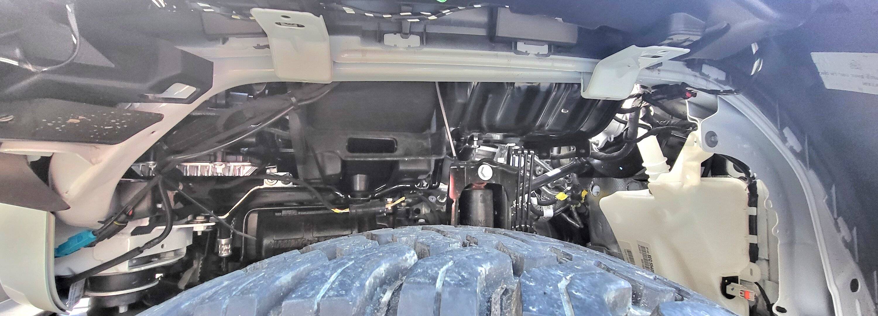

3. I went up over and ran the hose towards the front. Zip tied the washer hose to the existing cables and Trailcam Fakra Z cable. Used the ends and little bulge from the ordered Mopar hose.

@DailyDrivenTJ great route for the hose, that follows my farka wire route as well. Thank you for the guidance on the wire harness. I found the correct part# for the missing diesel washer hose: 68465694AA, I think. Every time I tear this vehicle apart I find another part I need making this project take months. Last question, if I button all this up without doing the pump yet, will it throw any codes or have any issues when coded WITH trail cam?

I thought about searching for the proper hose from Mopar but I wasn't going to let the hose stall the project. It is just a hose. All I needed was the length and the ends of the short hose transferred fine.
I think I paid like 5 bucks for the 10ft hose from Amazon and got it next day.

I rebuilt the center console with the JL CVPM attachment and it’s perfect! It added about 3 hours trying to figure it all out but here’s a pick of it upside down with CVPM installed. Just waiting on my dumba$$ to find a suitable crimping tool for the harness before reinstalling.
