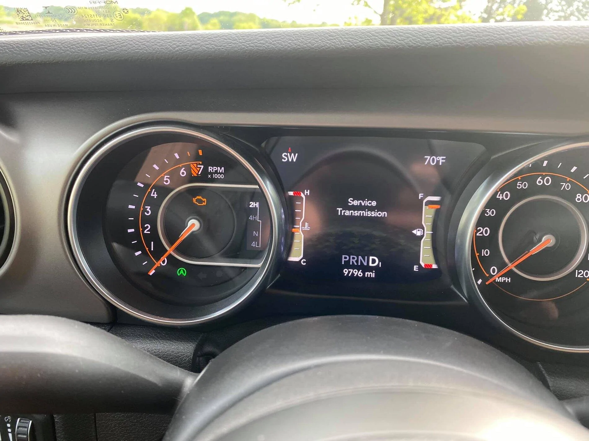

My Sport S took a dump today…

My Sport S did the same yesterday only 1200 miles. Dealer had to replace the AUX battery and the Z fuse. I haven't don't any mods to mine at all. Said Jeep bought bad batteries. They told me the same story when the aux battery died in my 2018 GC, one would think 3 years later they would stop using the bad batteries

ESS stopped working on my wife's 2018 WK2 as well. Dealer replaced BOTH batteries (this was late last summer) and said that they've "been seeing a lot of this lately".
Yeah, you'd think 3 model years later!

We had to replace the ess bat in the wifes pacifica when it was just 1.5 yrs old... not a jeep but same engine. Those ess batteries are little motorcycle style batteries and every motorcycle battery ive owned (and its a lot of them) didnt last long unless they are on a trickle charger. Problem is (atleast on her pacifica) it didnt start charging the battery until after the main battery is fully charged and the short little trips we were taking werent enough to keep things fully charged so that little battery wasnt getting charged often enough.

Decades ago, I had these exact symptoms. I pulled into an Auto Zone, bought a new computer, swapped it out, turned the old computer in for a core charge. That fixed the issue. That car had one computer though.
