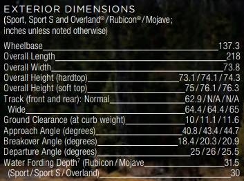

Well, Jeep says Mojave sits 1" higher than Rubicon up front.

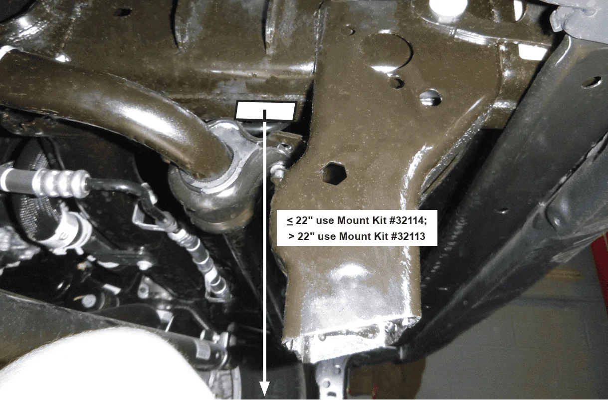

That's really very interesting - since my Overland sits as high as a Mojave. That means my Overland sits 1" higher than a Rubicon.
I used a real tape measure, parked so I could go back and forth between my vehicle and the 2024 Mojave. I measured multiple spots on the frame and body.
I concluded that a brand spanking new Mojave does not sit higher than my current Overland, (at least not enough to care about) thus, my snow plow equipment should work, dimension-wise.
There's a spot they tell you to measure - ground to frame - to determine mounting brackets and whether it will work or not. There might have been 1/8" difference.
This was my area of concern -
Jeep Gladiator Need your feedback, Manual or Auto, Rubicon or Mojave. 1709999098503
Mine measures 22 1/8"
The Mojave at the dealership is 22 3/8" - no winch, no driver, not a full tank of gas. Winch and plate on the front, plow bar on the front, it would likely drop that Mojave a tad.
Here's from my "Keep" notes -
Jeep Gladiator Need your feedback, Manual or Auto, Rubicon or Mojave. 1709999426421
Since the tires are roughly 1/2" taller, that accounts for the 1/4" difference between my Overland and the Mojave (my 22 1/8" vs the 22 3/8" of the Mojave)
I just went out and re-measured mine at that exact same spot - it is sitting at 22 1/8".
Put the Mojave tires on it and it would sit at 22 3/8"
So I wonder where they are getting their dimensions????
They don't. They say:
1-Inch Front Lift
But they do not specifiy which trim it is 1 inch higher than. What they do say is this:
Jeep Gladiator Need your feedback, Manual or Auto, Rubicon or Mojave. height
The mojave is only .2 inches higher than the Rubicon at it's highest point (which based on my crude memory of some crude measurements i took some time ago, is roughly the rear of the roof)
Between the .2 and the better approach angle but worse departure angle (as we all know the mojave has less rake) i'm guessing the mojave is only a half inch higher than a rubicon up front and the same height in the rear.
