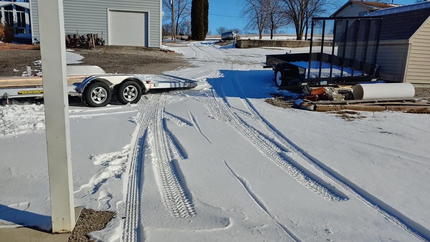

My gasser JT gets significant wheel hop on gravel in snow - climbing my neighbor's driveway hauling my trailer in 2 wheel drive, there was snow on his drive and I started to spin wheels and it was hopping and tearing his gravel up. I had to stop and go to 4 wheel drive mode. It made the rear end hop.
It may not look like much from this perspective, but where my trailer sits, I stand and am looking with eye level being about the even with the bottom course of block on his retaining wall. It's a fair climb up to the road.
It hops when it's slick and tough pulling.
