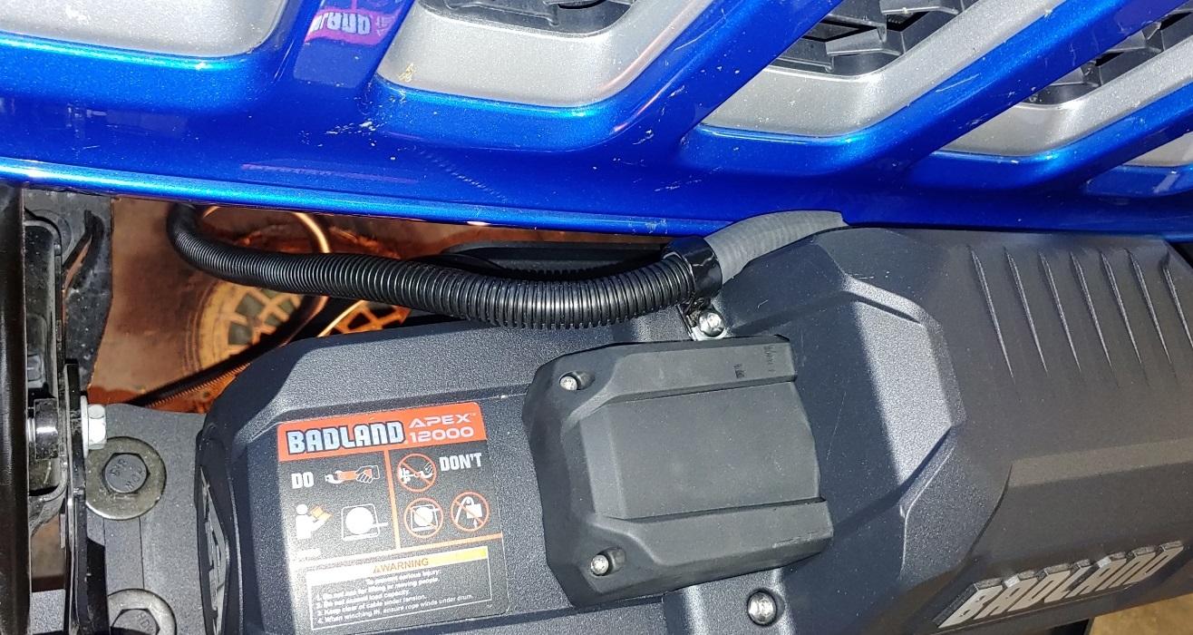

Installed a Rugged Ridge Arcus front bumper with the Badlands 12000 lb. winch. Man that winch used every bit of space up plus some.
I did what kitfoxbill did on the power cable plus 1/4" spacers on the frame horns to space the winch plate away from the grill and then put some 1/2" washers between the bumper skin and the winch plate, at that point everything cleared. And yes it was a pain getting a bolt thru all of those componets. But it was worth it as I am very happy with the outcome.

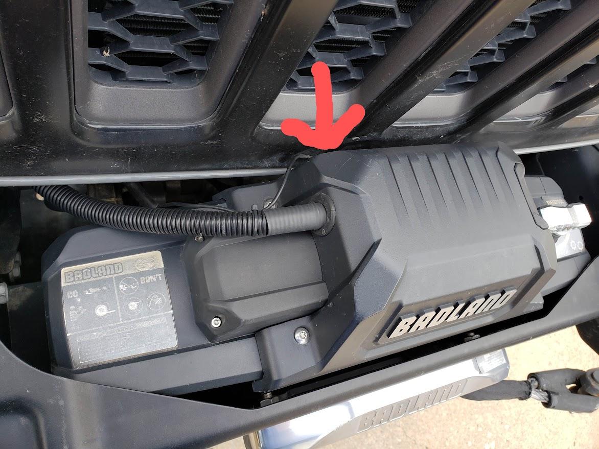

Here you go. Moved the power cable from the back to the side and put the spacers in place.

Mine wasn't as close as yours. I do wish I had used spacers between bumper and winch plate when bolting the bumper on, though.
Your winch looks to sit a whole lot closer to your grill than mine.
There's a good 1/4" or more clearance on mine after I tweaked the shape and clamped it.

Yeah, mine is close but it does not rub and with the reroute of the wire I was happy with the way it sat.

Heck yeah, I would be too. In your case the cable re-route was necessary - and it gave a nice clean appearance and does sit nicely.

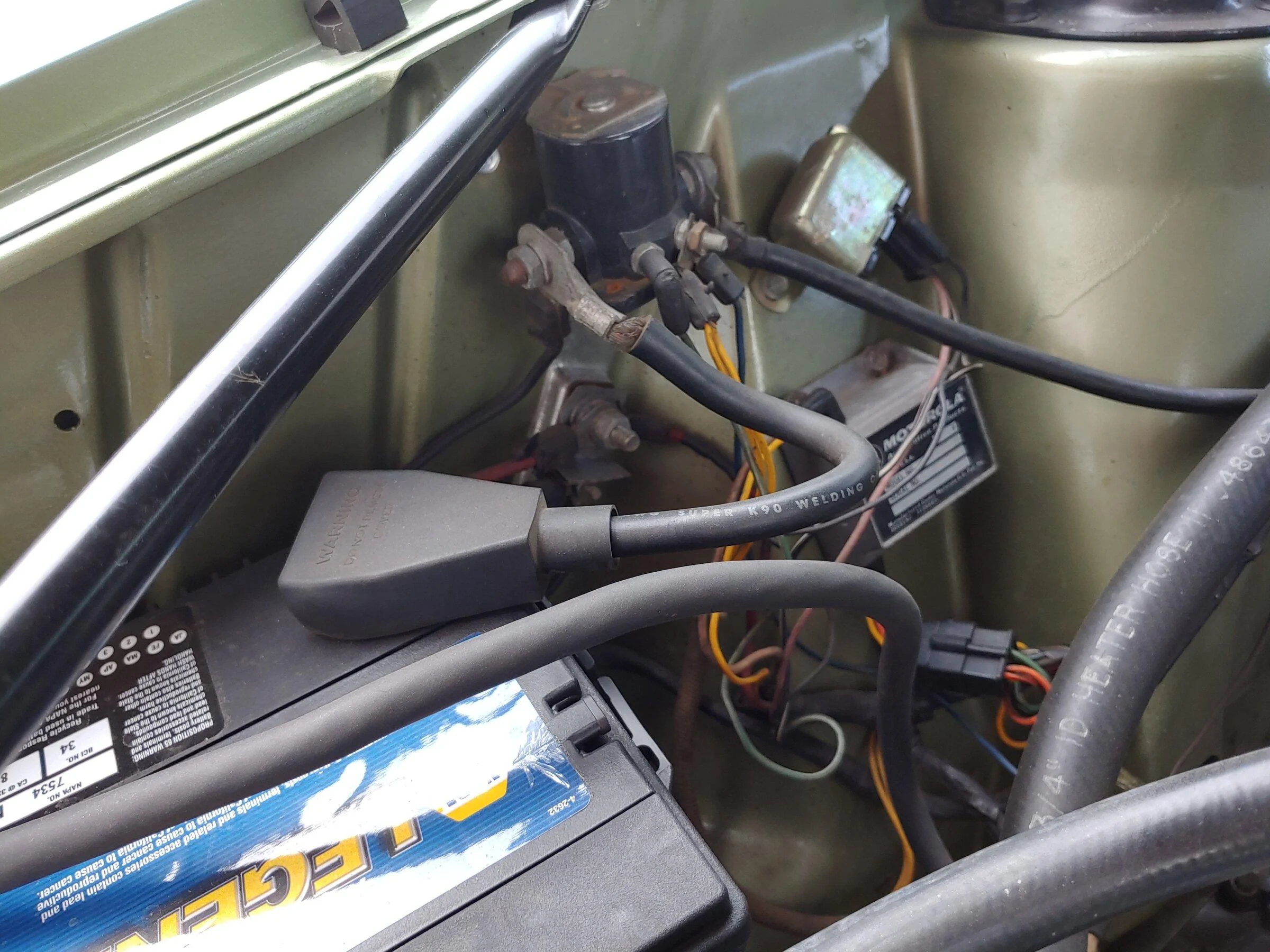

Here is one installed in one of my cars - this is typical orientation but it won't matter for your use. .
Be careful when tightening the nut to hold the cable on, be sure you don't let the large studs on the side turn at all. There are flats on the heads inside and they need to make flat contact with the disk that the solenoid pulls down across the bolt heads inside. A few people have let those turn and you lose current-carrying capacity.
