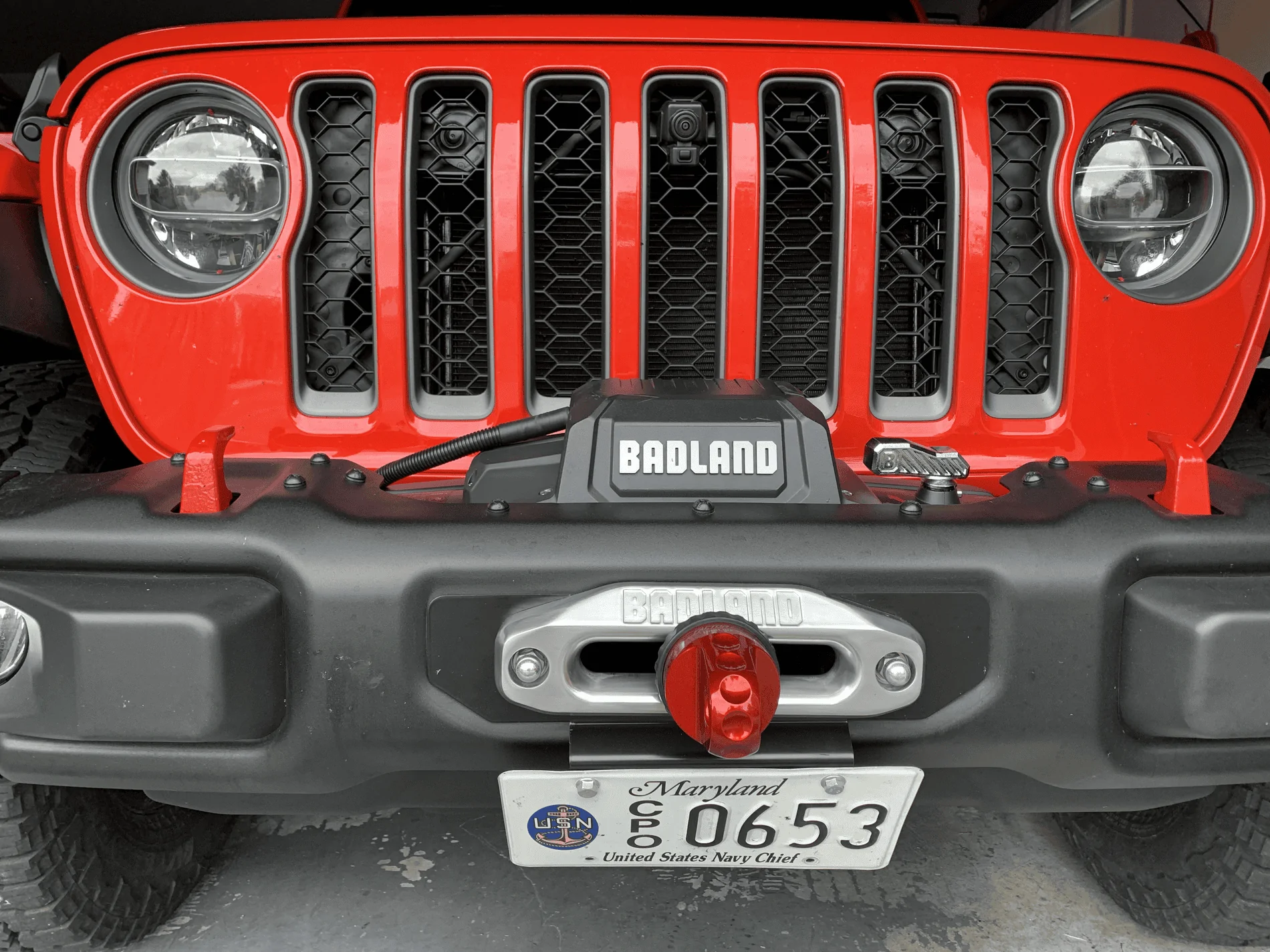

Here's what I used for install on stock steel bumper:
1. Warn OE Rubicon Winch Plate #101255
2. Poison Spyder Zeon Winch Spacer Plates #45-57-010-03
3. Fastenal Hex Cap Screw & Acorn Nut (2 each) for the Fairlead, screw-#M12-1.75x50 acorn nut-M12-1.75
4. Factor55 ProLink Shackle Mount
Everything else came with the winch.

Thanks DeepSea for the part numbers. I ordered the Warn mounting plate yesterday (should have it Friday) and will install everything this weekend. Fingers crossed!
