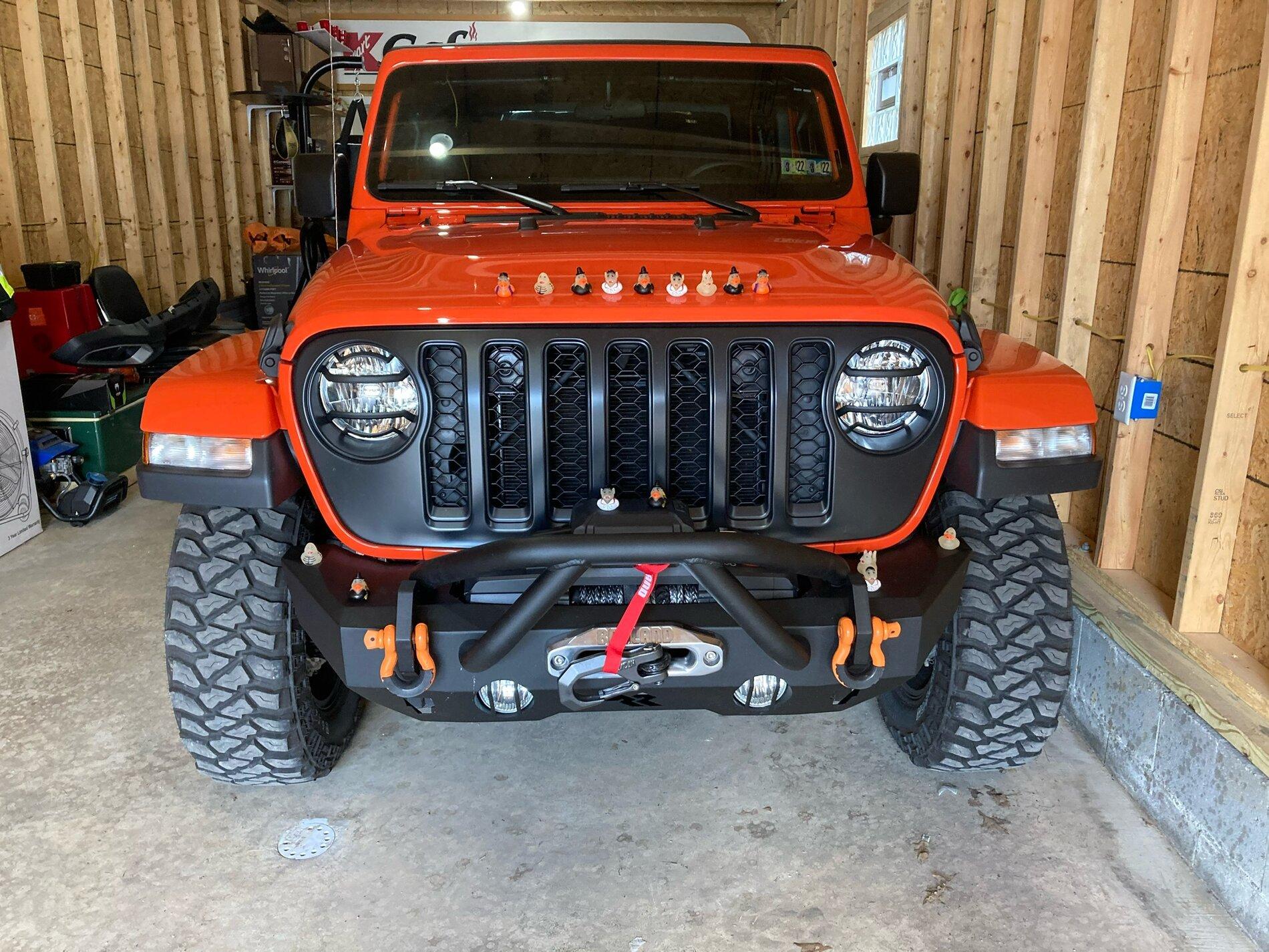

I used the Rockhard 4x4 winch plate for the oem Rubicon steel bumper and have zero interference between the winch clutch lever and the bumper. Plenty of room. Plus it was only $200. Much cheaper than the Mopar version and many of the other options as well.
I did find I had to get longer front mounting bolts. For one, Rockhard did not send me 1-3/4" bolts like on their install video anyway, they sent 1" bolts. I picked up a pair of 2" bolts to make it work. I'm curious how did you run your wires?

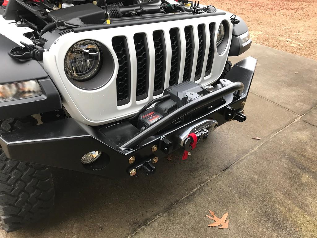

Can anybody tell me if the Apex 12K w/ Su the tic center mounted or offset mounted? I’ve read about some Warns being offset mounted, therefore causing issues with the fair lead. What about the Apex? I’m wanting to install into a Motobilt Crusher bumper (which offers flexibility for either mounting type).
40,453
53,888
Centered. Mine is well centered on the mounting plate and between the frame horns. (Badland Apex 12,000 winch from HF)

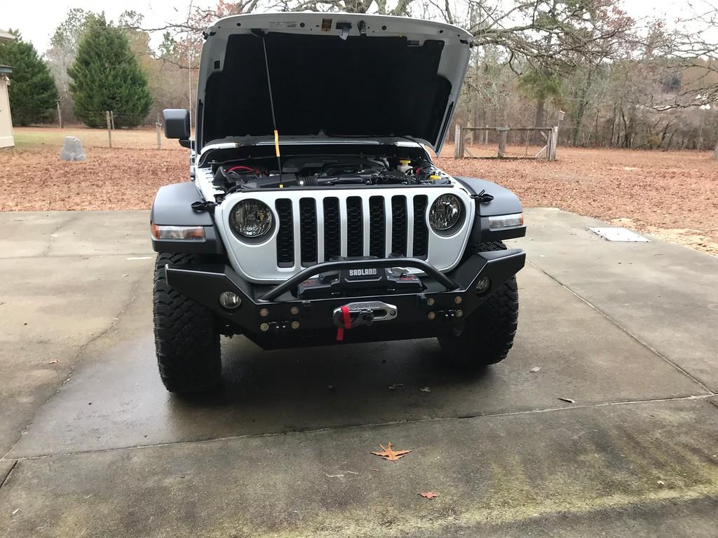

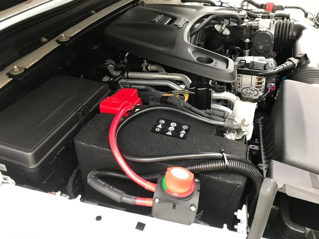

Rockhard full width bumper and Apex winch. The Rockhard bumper comes with metal spacers to extend the bumper forward. The Rockhard Installation video says the 1" spacers are the ones most commonly used. I used both the 1/2" and the 1". I might not have needed both spacers if I had moved my winch positive lead from the back to the side to start with. I also used the HF disconnect.
I took some pictures when I was moving the cable and did a write up on the change. You can find that write up here:
https://www.jeepgladiatorforum.com/forum/threads/apex-winch-mod-move-positive-cable.38243/
Jeep Gladiator New Apex 12K Harbor Freight winch Install i-hqWG7cJ-XL
Jeep Gladiator New Apex 12K Harbor Freight winch Install i-PjZ2SBH-XL

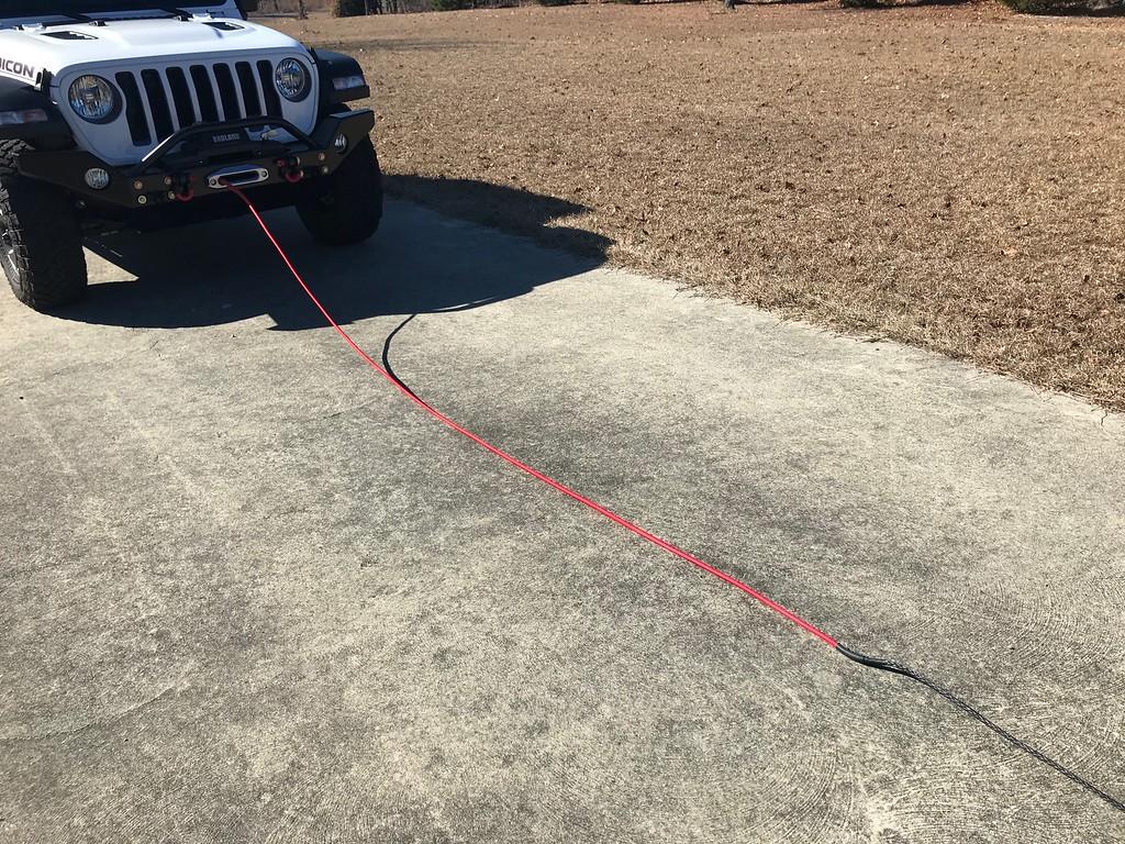

Final step of the winch install is to pre-tension the rope. I did that this morning. I was surprised to find the drum end of the rope was a heavier piece. I am very impressed with the Harbor Freight Badlands Apex winch, both the completeness of the package and the ease of operation. I love the wireless controller.
Jeep Gladiator New Apex 12K Harbor Freight winch Install i-rWj4Xzd-XL
