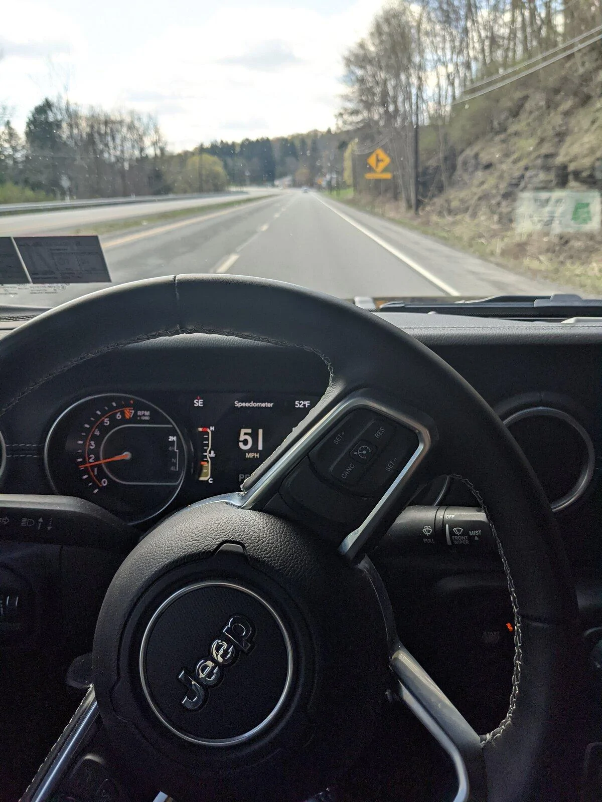

Box is being replace again, as this is how the steering wheel looked on the way to the dealer for service. This is traveling straight.
Pretty crazy, luckily the dealer was understanding of the urgency and was able to get me in much sooner than the initial 2-3 weeks.
I know it looks bad but your alignment between your tires is fine. They just didn't adjust the drag link to get the steering centered. You could do it yourself in a few minutes and save a trip to the dealer.
The Jeep tracked perfectly straight. The issue i had was there was no input to turn until the steering wheel was moved that far in each direction.
Driving on any type of switchback was very dangerous. I would go from turned almost half way one to completely the other way before it recognized to turn the actual wheels.
Gotcha. Yeah that is bad. Really bad. What ended up fixing it?
The work write up stated they replaced the steering box.... again. The original one was replaced with the steel one last year.
