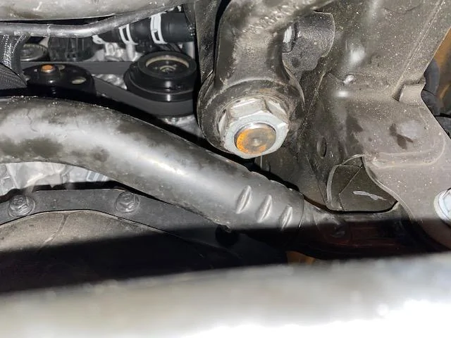

I had the steering box replaced months ago. It made huge difference and really tightened up the steering for me. I was driving I-10 this week and noticed the steering drifting a bit and seemed to be getting worse through the trip. Jeep dealer can't get me in for a few weeks due to ownership change? (Another story, another time), so I had a look to see if anything obvious was amiss.
The photo is the steering box, the nut was loose. I hand tightened about 2 1/2 turns and torqued it down as best I could. Steering is back to being excellent again.
It's an easy to see nut, but it's a pain to get a wrench on it!
That is somewhat frightening!! I believe the torque on that nut is really high like 200ft/lbs.
New, that pitman arm nut is suppose to come with a thread locker agent in the threads. The problem is the steering TSB does not call out a new nut or tell the tech to put thread locker agent back on the nut before reinstallation.
Still though, I suspect if it had been properly torqued down to begin with, should not have backed off and thread locker agent is just adding margins to that.
Exactly. The thread lock is just a safety margin. It replaces the "staking" that was done in the 80s and before where the nut was torqued and then a punch used to stake the thread at the very bottom edge of the nut. If the nut DID come lose for some weird reason, it wasn't going anywhere. The torque alone should be enough. Obviously that wasn't properly torqued and then lacking the "LocTite" type stuff, it was free to vibrate down the pitman shaft.
Double boo-boo on their part but indeed part of the blame is the TSM - or is it? That nut should be a stocking item and they mention in the TSM to follow instructions for replacing the parts.
They shouldn't have to reiterate with every TSB HOW to change a part, all they need to do is say "look in the library for the procedure for replacing xxx part".
Otherwise every bulletin on replacing a given part would have to repeat the how - they either know how or should look in their reference library - what we used to call TSM - technical service manual.
Even the TSBs from decades ago assumed the tech knew how to remove and replace a head or where to find the information on doing so. It wasn't repeated for every single bulletin.
