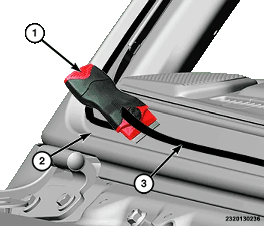

Jeep Gladiator New JT Gladiator Steering Issue TSB 08-074-20 (for "Improved Steering Feel") ault&X-Auth-Token=c578fef52b26404e8a3f37f4a7c588f
INSTALLATION

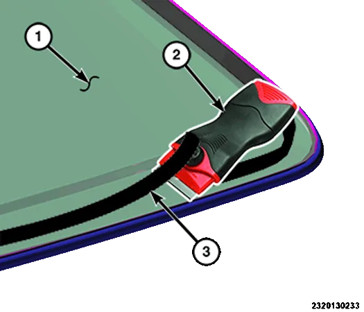

  1. If the windshield (1) is being reused, remove as much original urethane (3) as possible from the glass surface using a razor knife (2).
    NOTE:
    To prevent corrosion, do not damage paint on windshield frame when removing original urethane.
    NOTE:
    The windshield frame should be cleaned of most of its old urethane adhesive. A small amount of old urethane, approximately 1 mm in height should remain on the frame. Do not completely remove all old urethane from the frame, the paint finish and bonding strength will be adversely affected.
  2. Using a razor knife (1), level the original bead of urethane (3) on the windshield frame (2) to a thickness of approximately 1 mm (0.04 in.) and remove the loose adhesive.

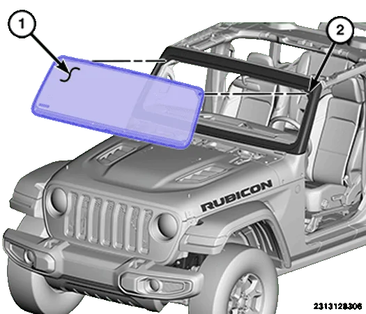

  3. Using an assistant, position the windshield (1) into the windshield opening and against the windshield frame (2).
  4. Verify the windshield lays evenly against the frame at the top, bottom and sides of the opening. If not, the frame must be formed to the shape of the windshield.

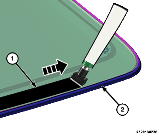

  7. Clean the inside of the windshield with an ammonia based glass cleaner and a lint-free cloth.
  8. Apply glass prep adhesion promoter 25 mm (1 in.) wide (1) around the perimeter of the windshield (2) and 5 mm (0.2 in.) from the edge of the glass and wipe dry with a clean lint-free cloth until no streaks are visible.
  9. Apply glass primer 25 mm (1 in.) wide (1) around the perimeter of the windshield (2) and 5 mm (0.2 in.) from the edge of the glass. Allow at least three minutes drying time.

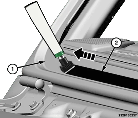

  12. Clean the windshield frame with an ammonia based glass cleaner and a lint-free cloth.
  13. Apply pinch weld primer 25 mm (1 in.) wide (2) around the windshield frame (1). Allow at least three minutes drying time.

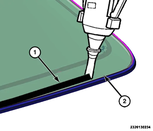

  16. Apply approximately a 7 mm (0.3 in.) wide and 13 mm (0.5 in.) tall bead of adhesive (1) with a triangular nozzle approximately 6 mm (0.230 in.) from the edge of the glass (2) starting at the bottom center of the windshield.
    NOTE:
    Make sure the bead of adhesive is placed on the primer fully.

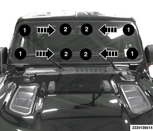

  22. Seat the windshield glass firmly starting at the top and the bottom A-pillars (1) and working inward to the center on the top and bottom until the standoff bottom out onto the frame. Hold in position until the glass feels solid and make sure glass is underflush around the entire frame.
  23. Slowly add pressure inboard and press the center of the glass (2) underflush as far as possible.

INSTALLATION
    NOTE:
    NOTE:
    NOTE:
