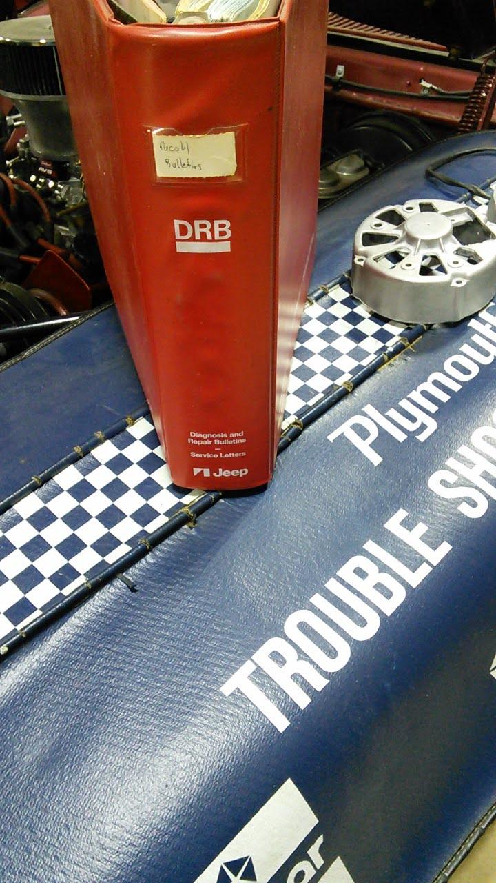

Yes. And for a while, maybe you remember they were called DRBs - Diagnose and Repair Bulletins. The factory was helping you diagnose and suggesting how to repair certain problems they had run into but not all dealerships may have.
Anyway, they are no indication of warranty or lack of. They are merely how to resolve issues.
Yeah, TSB's are not written for the end user customer, just the dealership service departments. They are not an admission of a problem or design flaw.
A few years ago, there was a somewhat famous Hyundai/KIA tsb that made the forum rounds that advised service techs if presented with a startup tick and determined a aftermarket oil filter was the cause, to change filter to the OEM and charge the customer for nonnwarranty coverage. End users thought that meant ALL aftermarket oil filters would void your warranty, when that was not the case because the TSB was not written for end user customers consumption.
