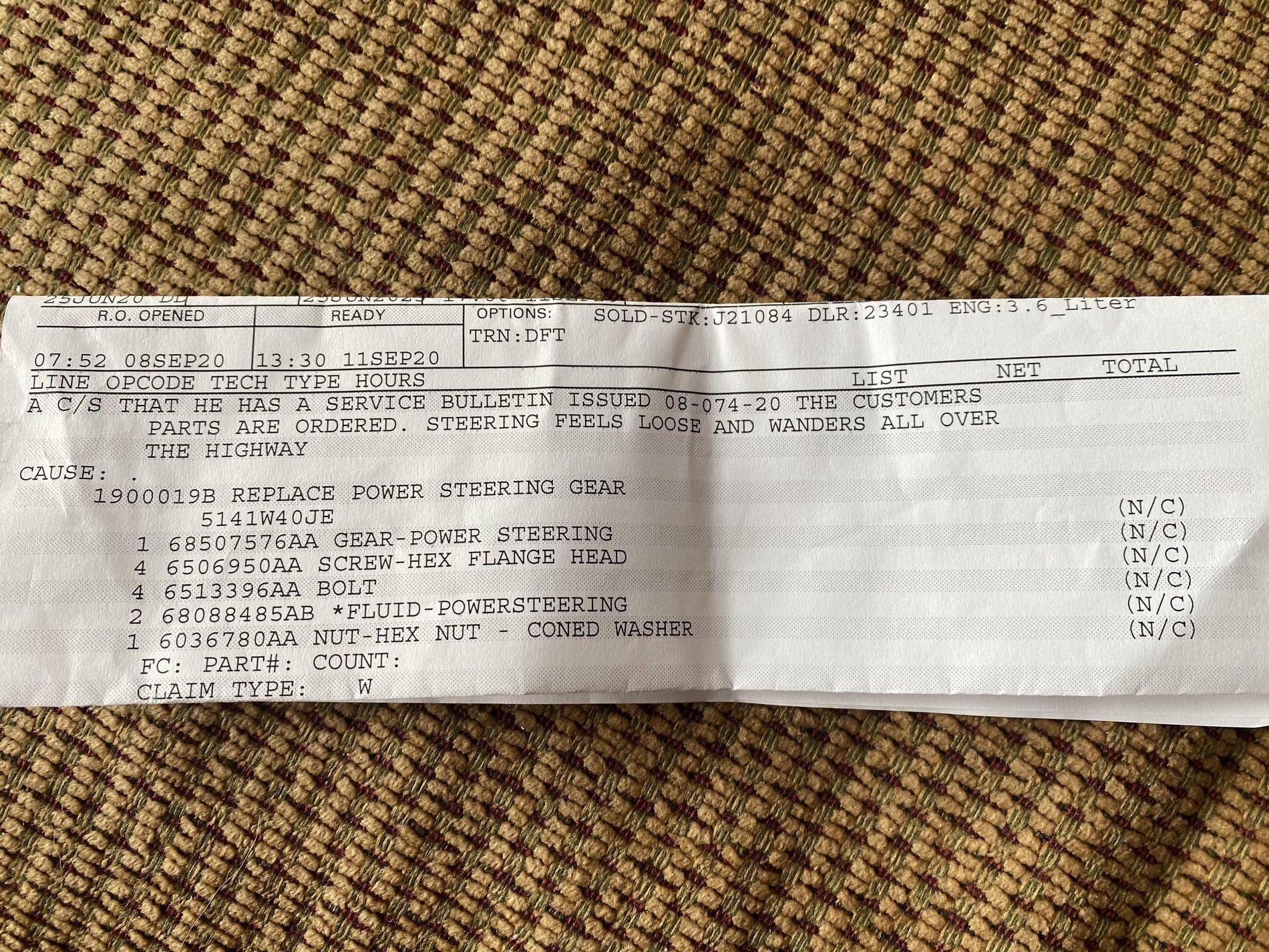

My dealer is convinced that the pitman nut is a one time use nut and must be replaced when the steering gear replacement is performed. This is what held up my truck from getting completed because the nut is not listed on the TSB and they didn’t have it in stock so they had to order it.

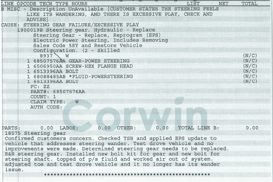

Jeep Gladiator New JT Gladiator Steering Issue TSB 08-074-20 (for "Improved Steering Feel") 2020-09-16 09_58_58-Pages from ID_09162020_Redacted.pdf - Adobe Acrobat Pro DC
I'd bet that is it supposed to be a one-time-use nut. Looking at it, yes. I'm surprised other dealers are re-using them.
These are not standard lock nuts.
(talking as a long-time mechanic myself, and having done many front suspension and steering jobs)
I've dealt with that type of fastener - and that matches one-time-use just looking at the new ones.
Your dealer is not the first to have said so, either.
The service manual, if you had access, likely says as much. Surprised they don't have any as it's required if replacing seals or the pitman arm itself. Should be a stocking item, IMO.
