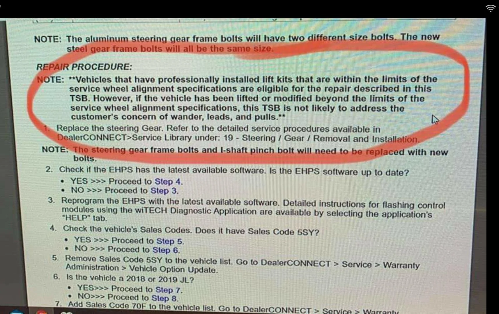

Just took the JT in for the dealer to inspect it; took 2 hours for them to confirm the issue. Replacement parts will be here in 10 days max!

Took mine in two weeks ago and the dealership agreed to order the parts. Well, I called to get an update today and they are saying the parts aren't expected to ship until end of September since they can only order every 14 days and there were a couple people ahead of me. Interesting since they weren't aware of the TSB when I brought it in originally.

I get mine back tommorow from having the tsb taking care of. They called today saying that it would be another day because of a code popping up regarding anti skid. It happened after the software update. Will post the results after I get it back.
Well I got my JT back from the dealer. TSB completed. I have to say that I can drive with one hand or a couple of fingers without constantly correcting. The steering wheel also returns to center after turns now. Pleased so far. Haven't gone on the highway yet.
I called my dealer about this issue. Was told I would have to leave it with them for a few days!! DAYS!!! How long does it take to diagnose a steering issue. Now I have to figure out what to do because I can’t not be without transportation for a few days!
That's bullshit! My initial appointment was scheduled for this last Monday morning. I skipped it due to a work meeting. I called Monday afternoon to reschedule and mentioned the TSB specifically and asked if they had the parts in stock. I was hoping to avoid multiple visits. The service advisor/manager was like '...well this would be an expensive repair and I don't have the parts in stock so it needs to be seen by a technician first". I questioned him a bit and said "...it states that if the customer states steering wander, to make the repair". Long story short, I took it in yesterday afternoon and waited at the dealer for about 90 minutes. Sure enough, he comes right in and says "...we checked everything, it's the steering issue you described". He also listed about the ~10 things they checked and mentioned they all checked out. I'd demand they provide you a loaner if they can't get their shi$ together.
