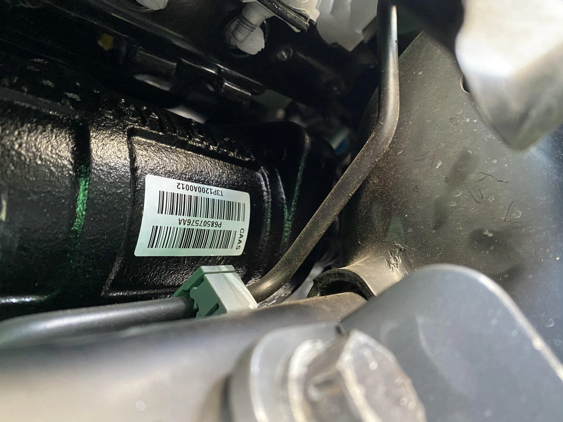

As already stated hjdca, the faulty gear is aluminum - a gray to silver/gray color. The good one is BLACK, cast steel and you will see a sticker with the PART NUMBER on it.
I'd bet a Big Mac yours has the old bad gear.

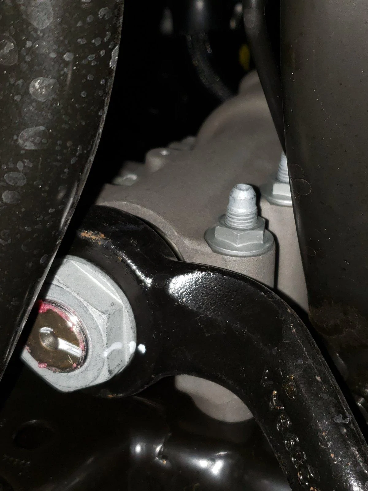

Alright, so this is aluminum steering gear with the "wander" issue, correct?
Man, I wish I had of read this crap before buying her this Mojave. I would have been crawling around in the dealer parking lot eyeballing steering gears.
Yup that’s the one. The new one is black and has the following part number:
Jeep Gladiator New JT Gladiator Steering Issue TSB 08-074-20 (for "Improved Steering Feel") 69324ABE-1187-424A-BC5C-C6609A0D4D64
That cast iron looking thing, looks heavier than the aluminum steering gear. Gonna have to put the wife on a diet to compensate for the weight change. :headbang:
That is the aluminum gear that needs to be replaced. Got mine done no real hassle. Can also tell by the nuts as the old gear doesnt have the threaded holes. New black gear won't use those nuts on the bolts.
