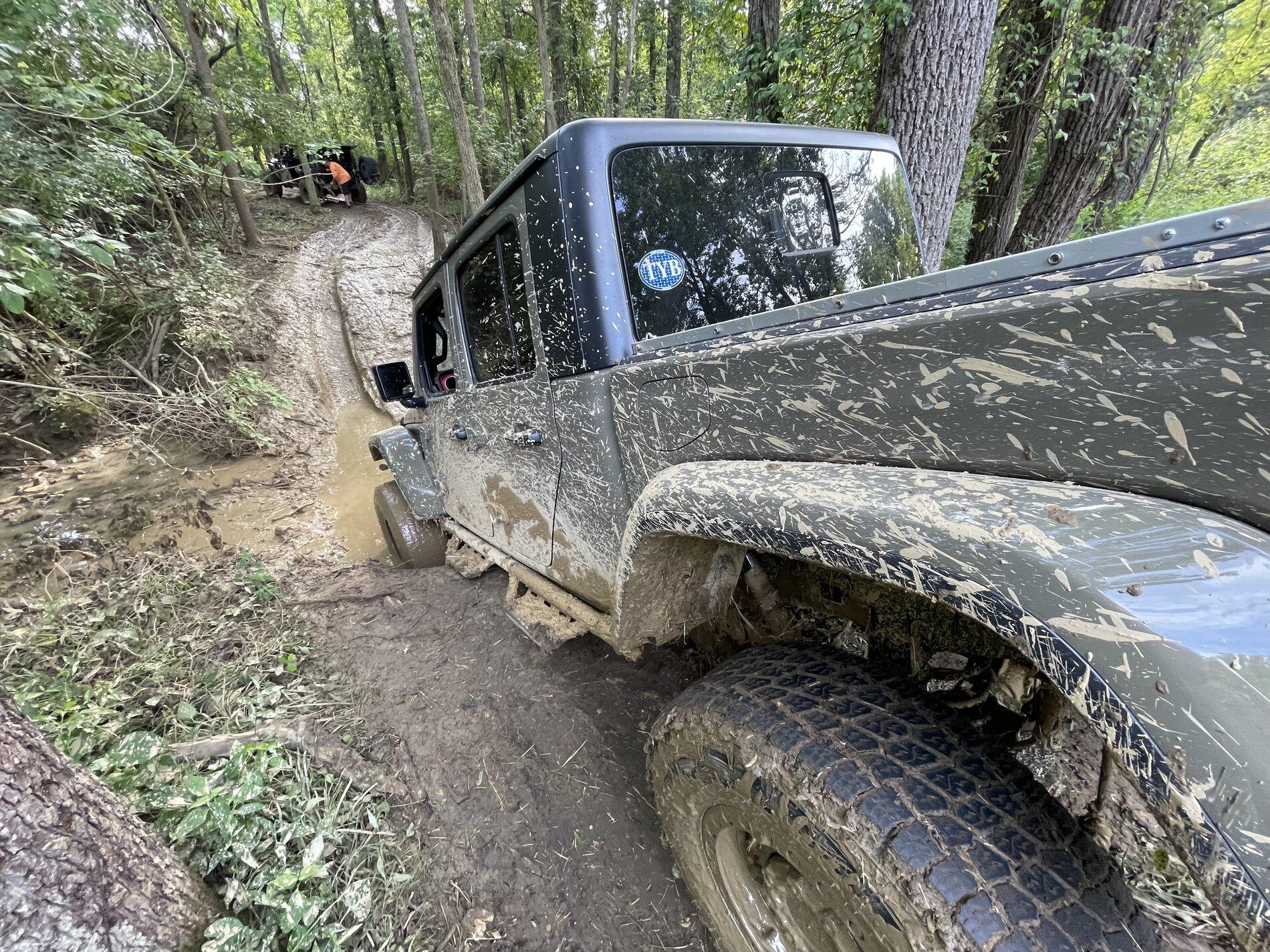

My overland with a very modest mod list just earned her first badge of honor last weekend and took on the hardest trails I could find on Drummond island, MI. Thick mud, deep water, some good size rock crawls, she kept up with a built JL Sport (35’s, lockers, etc.), a stock JLUR got stuck a few times, I didn’t), and didn’t skip a beat.
295/70r18 Falken Wildpeak AT3w
Rubicon Take off Shocks and Springs
Teraflex 1.5” leveling kit
Daystar 3/4” rear spacer
Rubicon take off rock sliders.
Factory Trac-Lok rear LSD.
it’ll go everywhere your power wagon went, and fit down some tighter trails better.

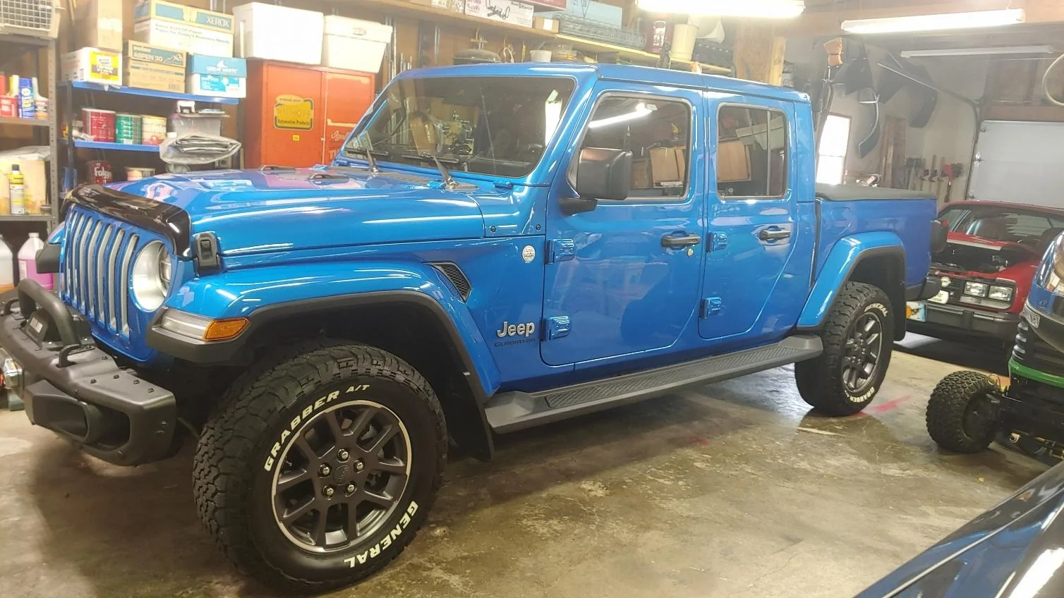

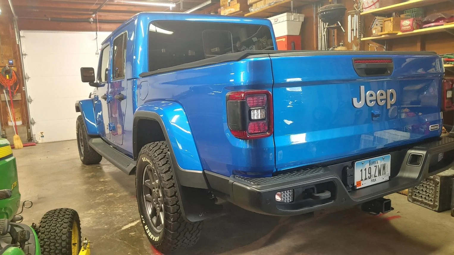

You bet. Mine is very different with A/T tires on it. I bought a set of Rubicon take-offs to see how things went and swapped back and forth for a while, then decided to make the change to A/Ts permanent and bought a set of General A/TX tires. What a difference! Wet roads, water standing on roads, snow, ice, totally different truck.
IMO the traction control now does a much better job with these tires. I'm no longer concerned about bad weather.

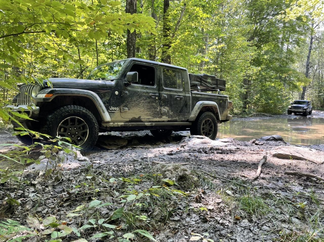

One thing that I don't think I've seen mentioned here is a winch. I put one on mine more for looks honestly but the very first time I took mine off-road I got high centered and needed it to get unstuck. I would maybe look at that before lockers if your going off road especially in solo situations. I have front and rear lockers on mine and they couldn't help me out of this situation.

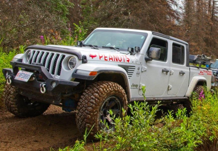

I ended up with the Overland trim just because i needed a replacement vehicle, and the dealers didn't have any rubicons. I drove it for the first year by changing the wheels and tires, 17" wheels 33" tires which was fine for what i did at first. 2nd year I started wheeling with the local Jeep crowd and swapped out to 35" tires MT's and regeared to 4.88's. I tow a rpod camper as well, so it helped. I could have lived with 3.73's otherwise. 8th gear on the highway was rare and needed to be flat with a tailwind.
Adding a winch was a must have; a couple situations, I got stuck while others with full-lockers were able to climb out of trouble. Also, I'm saving up for 3.5" suspension lift, over the 2.5" leveling lift i bought last year. I need the extra clearance on a couple trails i've done this summer. Eventually, i may add lockers when more options are available. I do not want to get air-lockers.
