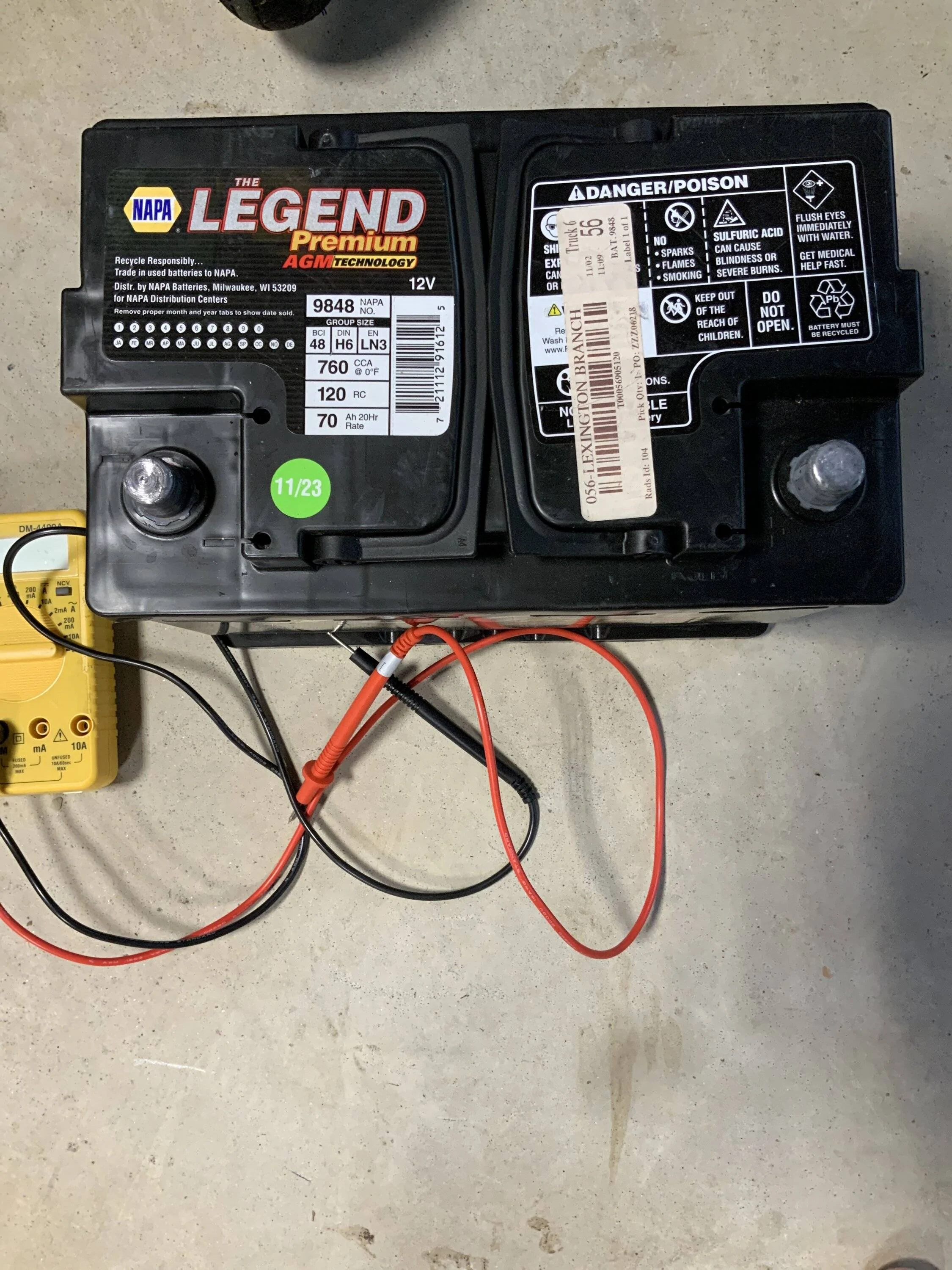

Nope, see image below.
Pretty sure I got the answer to my question this morning.…
Last night before I posted my question, I put it on the NOCO charger for .5 hours or so, took the voltage and it had gone up to 7.20v or somewhere in that range. I took the charger back off overnight. Just a moment ago, before taking this photo, I measured it again and the battery has already dropped to 6.6v.
Something definitely wrong with it.

11/23 on the sticker! Think that is well above low rate discharge huh? 6.6v this morning, down from a 7.2v small charge with the NOCO last night.

Except he said the code on the battery is something like November 2023.
That's a heck of a drop in 3 months. Sitting, unloaded, I'd expect 12.1 or so depending.
The full SoC voltage of an AGM battery is 12.7-12.8
As 2% drop per month, which would be closer to the high end, that's still over 12 volts after 3 months.
Agreed... something is definitely going on with that one. I didn't see the manufacturer date until after the post.. regardless same advice RETURN IT !
