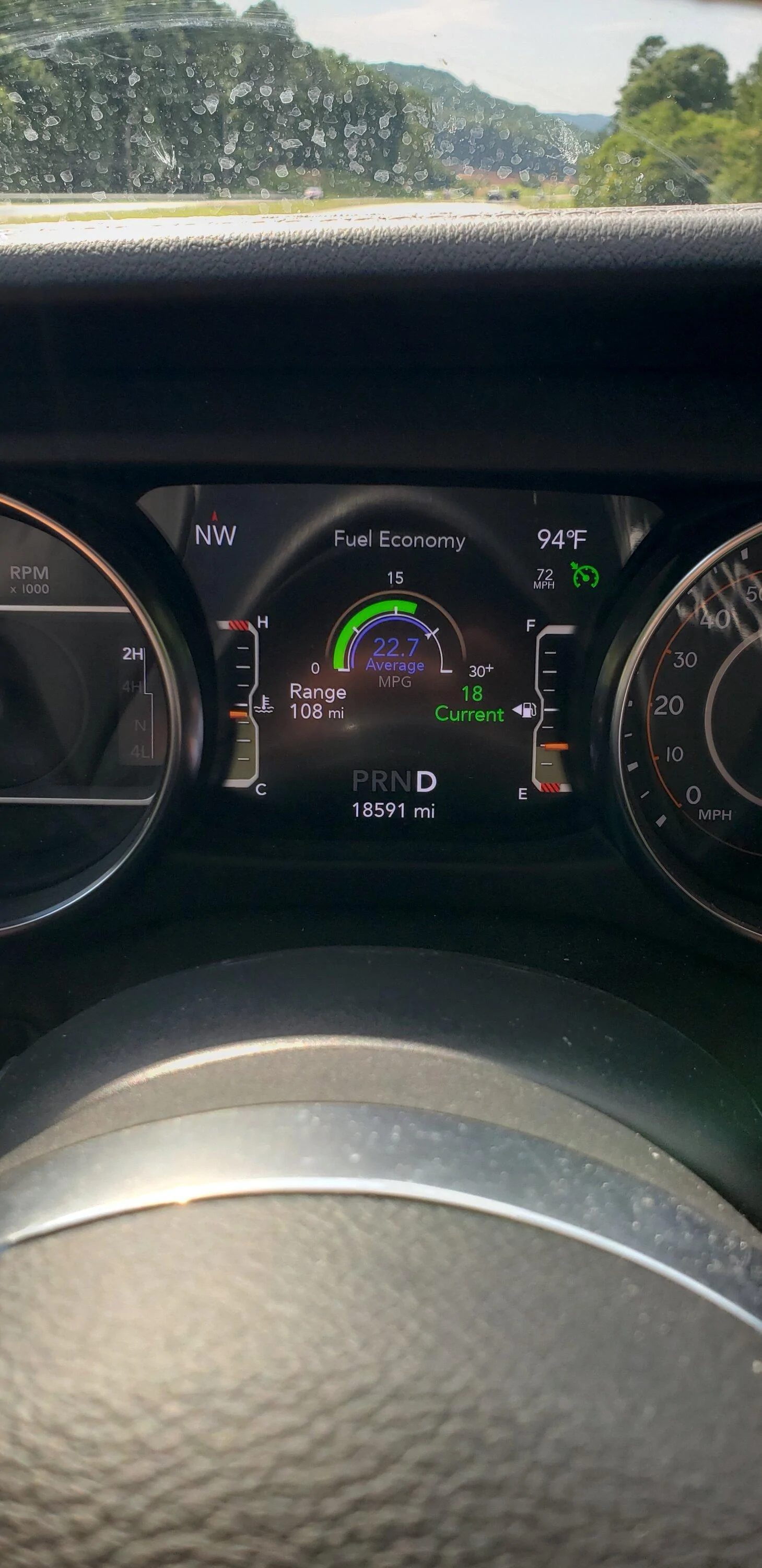

Not bad for a gasser on 37s

round trip from Al. to Fl.
Jeep Gladiator Not bad for a gasser on 37s 1663684333835

I think he was coasting downhill, reset the fuel economy estimator and then it landed on 22 mpg as he was coasting and he took the pic, as it reads now, he is not hitting the gas and coasting
Lol yes I was going downhill as that’s how you get back to Denver from the mountains, but I have never reset the fuel economy estimator since the day I bought my jeep.
Post a pick of the trip with the mileage and gas
This^^
