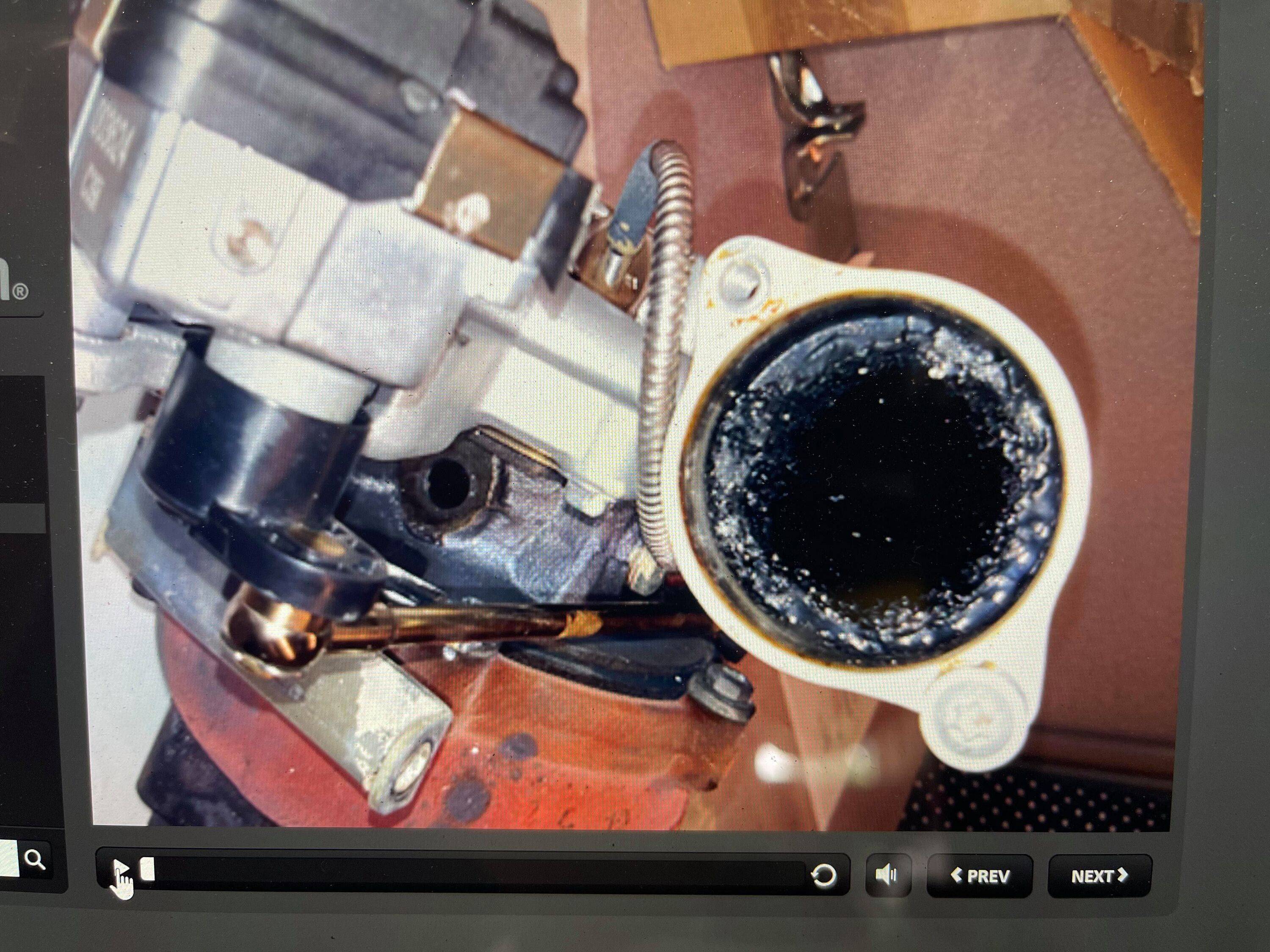

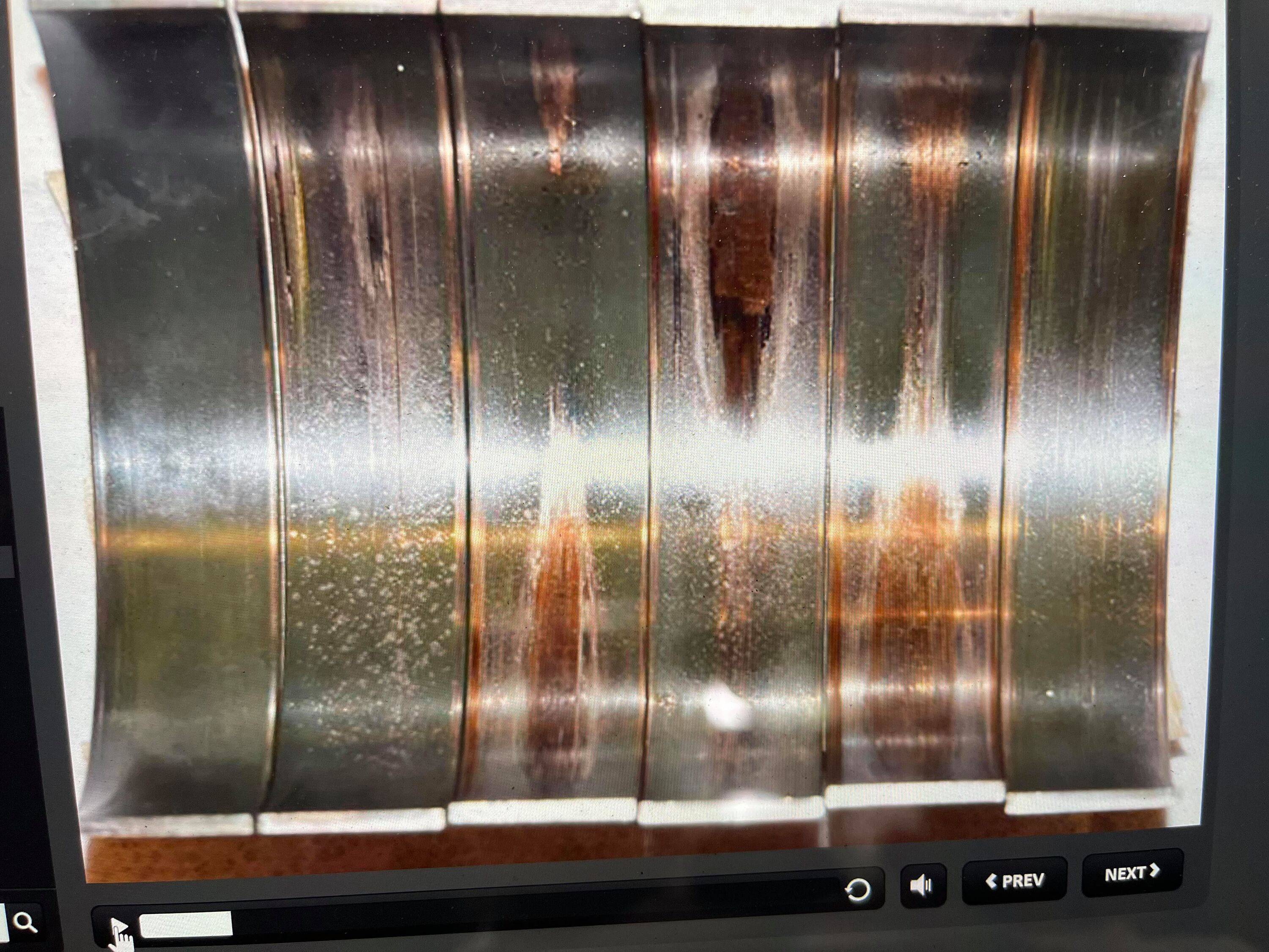

What about t6? I had great luck running that in other vehicles.
T6 is a good oil in the gen 2 engine. The Mastertech for FCA told dealers not to run T6 in the gen 3 engine and posted the following pictures in his presentation. These parts were pulled from one of their test mules running T6.
What do you run.
