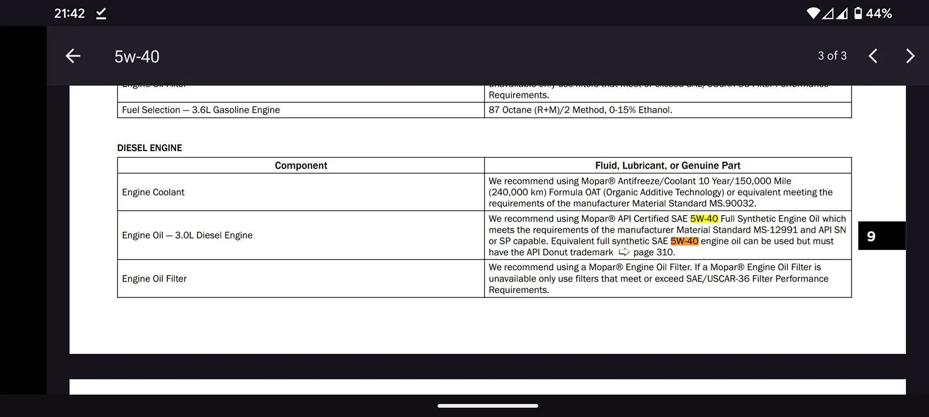

I hate when they change the manual... This is from my 2022. Looks like we're both right?
Yeah, it's a bit ridiculous. The constantly changing "recommendations" and "requirements" makes me just not worry about it too much. I've used full SAPS euro oils, a mid SAPS euro oil, and am now running a CK-4 oil that I'll probably stick with so long as UOA results come back good, and I won't have any anxiety about it since the manufacturer really doesn't seem to know what's "right" for this motor beyond just a full synthetic 5W-40 that is compatible with modern emissions

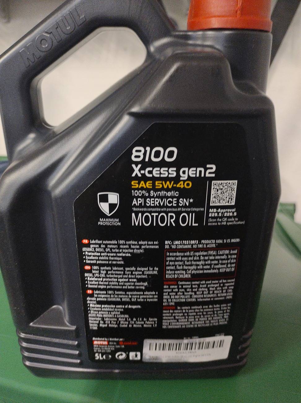

Where do you find the ash or saps content? This is what I've been using since the last oil change on Jeep wave program. I've had no issues so far in almost 60k miles.

Motul X-cess gen 2 is full SAPS, which is in the 1.2% - 1.6% range. You have to get out of the Chrysler MS-12991 spec if you want a low SAPS oil. I would recommend Amsoil AFL. It's 0.8%.
Well I've had no problems with it. I'll just keep using it.
You won't have problems until about 100,000 miles when you start noticing frequent regens. Trust me, we are seeing DPFs needing to be replaced in the 100,000 - 130,000-mile range with full SAPS oils.

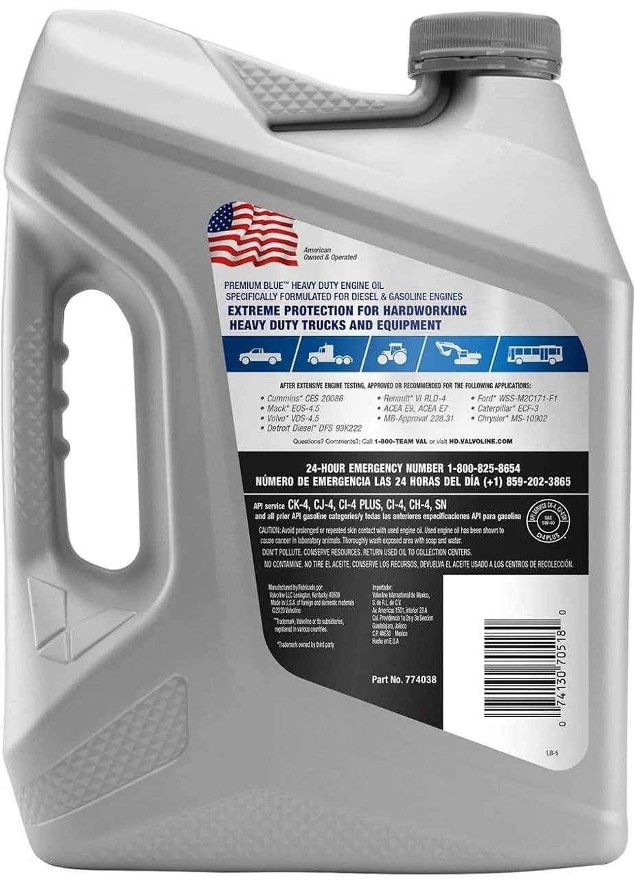

How do you know the SAPS level?
How about Valvoline Premium Blue 5w40?
