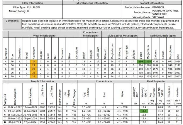

Viscosity and Flashpoint are still in spec which excessive fuel dilution would bring down.
Are you saying Blackstone under reports those parameters also in addition to fuel dilution?
The current sample almost out of spec if that is being reported accurately by Blackstone we don't know. but look at the other older ones. 11.16 & 10.68 cSt. Were those also STP?
The Moly, Boron, Calcium and Magnesium numbers would suggest those were a different oil.
Yes I noticed and suspected that. The 4th one almost looks like the 1st STP one but still a little different. The problem is with known wrong numbers from Blackstone, are they all the same oils lol? Either was, I would not use any of them when you see the numbers from Amsoil MS, Molygen or HPL.
I'm using Redline Euro 5w-40 and it will take 3 years at least to see a trend. I have not seen any samples with this oil anywhere.
I found one virgin sample on BITOG of it and about the only difference was the virgin cSt 40c 100c viscosity was 13.1 vs. the 12.22 of the sample in question here.

I found one virgin sample on BITOG of it and about the only difference was the virgin cSt 40c viscosity was 13.1 vs. the 12.22 of the sample in question here.
The one from 2015? I wounder if they changed anything since then? The last update on the product data sheets was in 2023. I'll do my 1st UOA next year.
