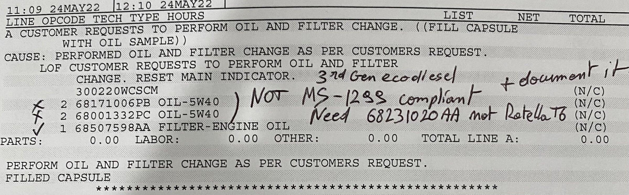

I might have bought the wrong pennzoil?
Jeep Gladiator Official EcoDiesel Oil and Filter Recommendations 20220512_090005
Jeep Gladiator Official EcoDiesel Oil and Filter Recommendations 20220512_085959
Jeep Gladiator Official EcoDiesel Oil and Filter Recommendations 20220512_085951

Local Advance Auto carries it.

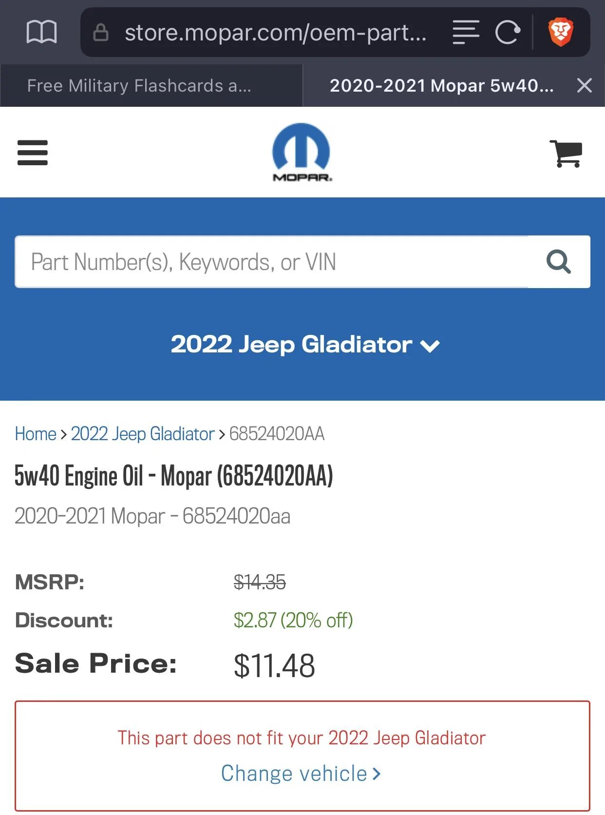

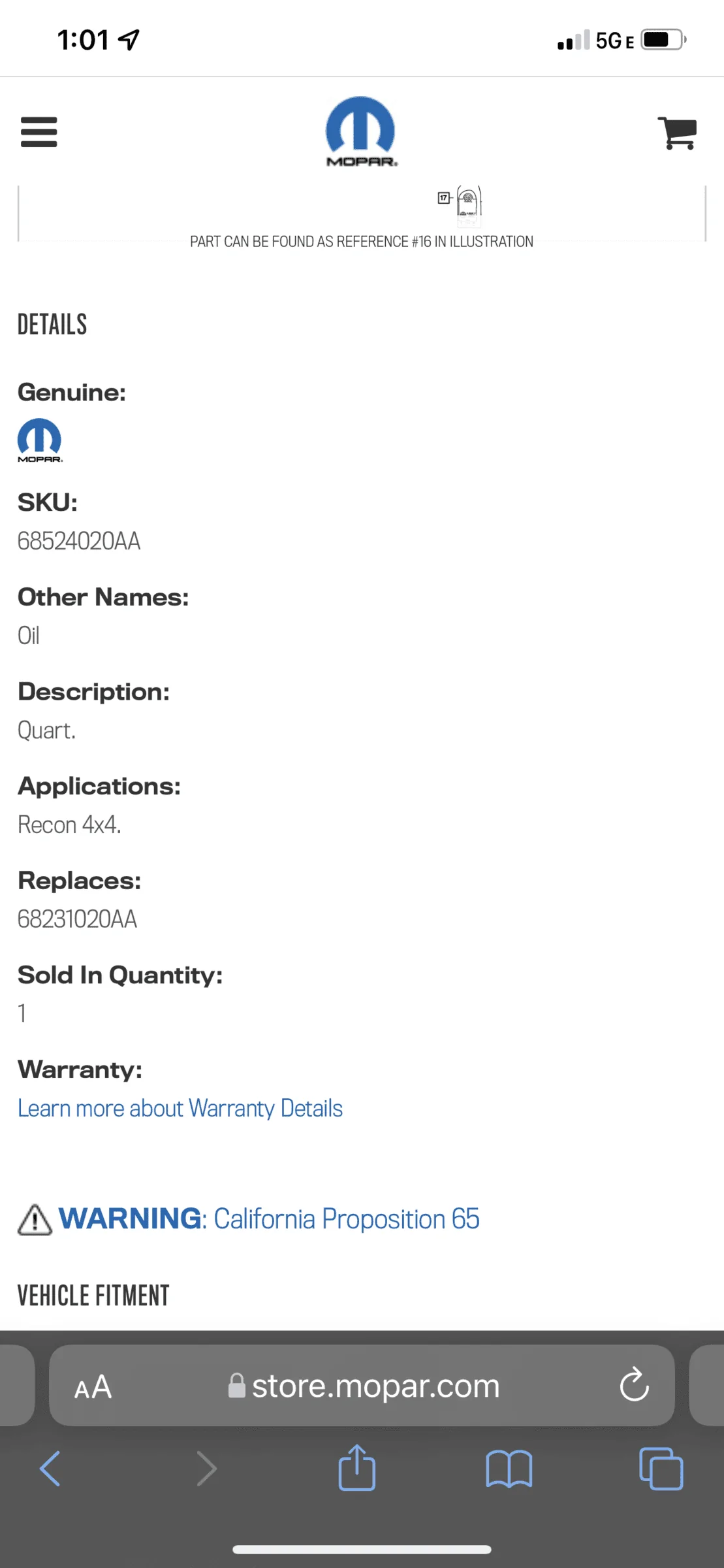

If that's the case maybe @biodiesel, could you update the first post with the new part #?
I updated the front page with "Mopar 68524020AA 5W-40 replaces 68231020AA". Thanks for letting me know.
