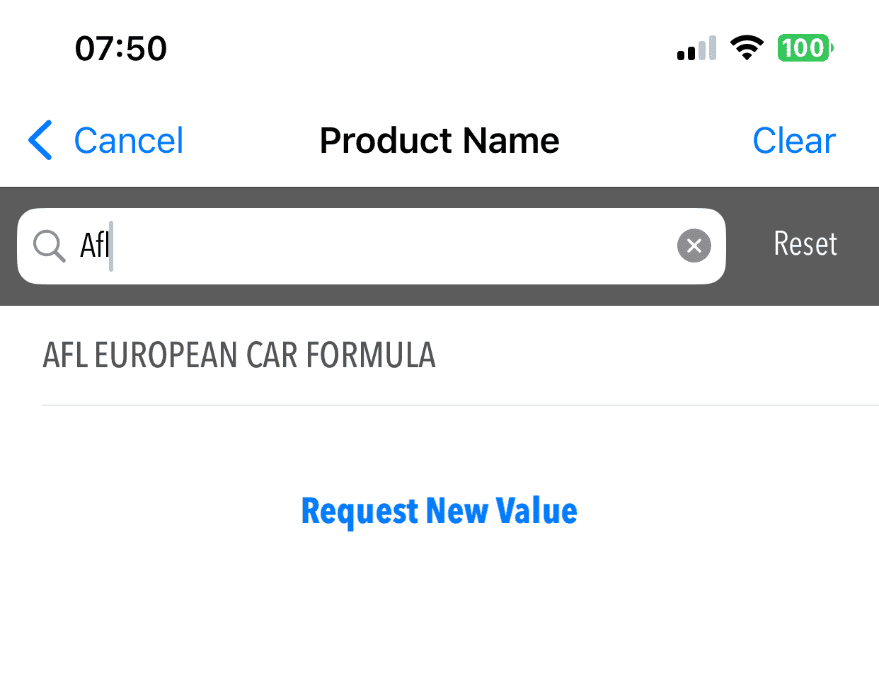

AFLQT-EU just means its the Quart (QT) version of the AFL oil family and I can find this on the app, it's just inconsistent with the “FS European Motor Oil” or whatever and I was expecting to find “MS European Motor Oil” but instead they have this bellow, does that sounds right? Should I use this?
Yep AME, SVO, EFM is the product code, then QT, 1G, TP would be the size of the container.
ParatusExpeditions
Mar 18, 2022
442
378
CA
22 JT Rubicon EcoDiesel
Nice, I just verified for my understanding so their FS line is product code EFM, and their MS line is AFL.
Now back to eoilreport thing, they have 3 entries in their database:
  1. EFM Europeean Car Formula
  2. AFL European Car formula
  3. FS SYN Motor oil
I'm not sure what 3 is for but it got me confused I needed a 4. MS SYN Motor oil.
All make sense now.
So you're using this one yourself
https://www.amsoil.com/p/amsoil-5w-40-fs-100-synthetic-european-motor-oil-efm/
Not this one?
https://www.amsoil.com/p/amsoil-5w-40-ms-100-synthetic-european-motor-oil-afl/

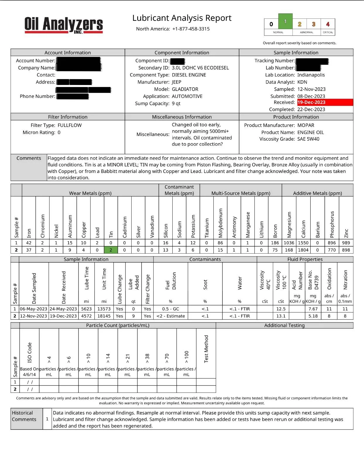

Received my report; I sent the oil in a bit too early I think. I will try 6-7k next.
I was running Mopar oil so far, and switched to Amsoil MS for the last two changes.
Is sample 2 with Mopar or Amsoil?
