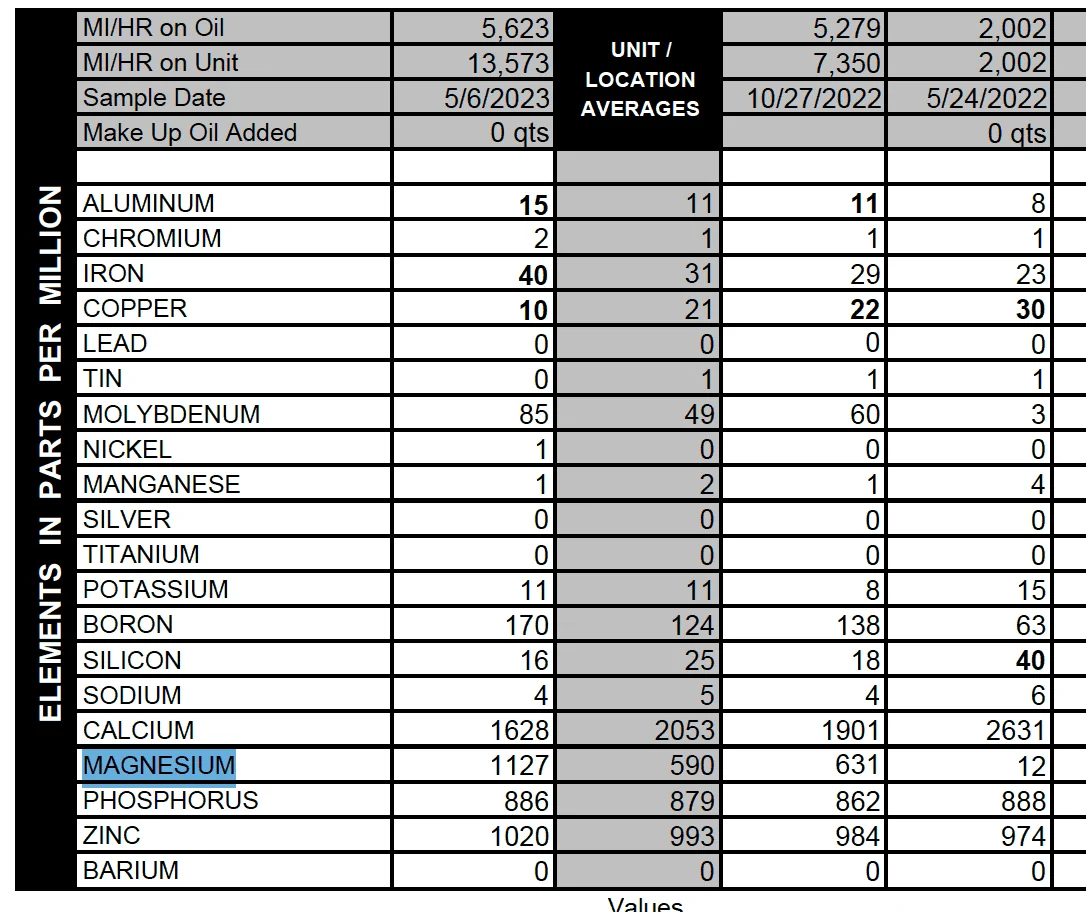

Both (1 and 2 here) are Amsoil. The two first were Mopar not visible on here, I did have the analysis done through Blackstone labs and now switched to Horizon. I did a very early change at 2.5k after purchase I think the 7.5k and so on
How did Mag and Boron change so much? It looks like a different oil? Was it 2 different types of Amsoil?
I'm not sure, maybe slightly contaminated at collection since I got it from the collection pan and not while it was flowing down. But if anything I would have expected more (Boron & Magnesium), not less. So I don't think that's it.
Bellow are the first 3 oil changes that I done on Black stone Lab. The first column is sample 3 on blackstone is sample 1 one Amsoil so the numbers are close and match. Magnesium has been building up, maybe due to engine breaking in? I don't think there are much data out there for us to read an oil report with certitude because numbers can come from many different scenarios, neither we know the alloy composition of all parts in this engine so it's all about guessing game. They did not flag it either.
It's unfortunate the Horizon/Amsoil report does not show the average for a particular unit (JTRD).

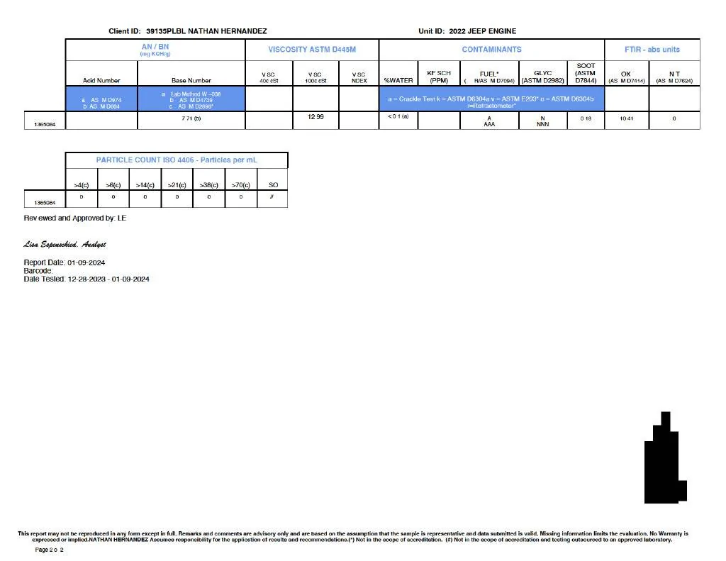

Just sent in an oil sample for the Amsoil FS. Running the Hot Shot's Secret 5W-40 and Stiction Eliminator now, will do a sample analysis of that when it's time to change again.
Really curious how their oil does seeing as they have good fuel additives.

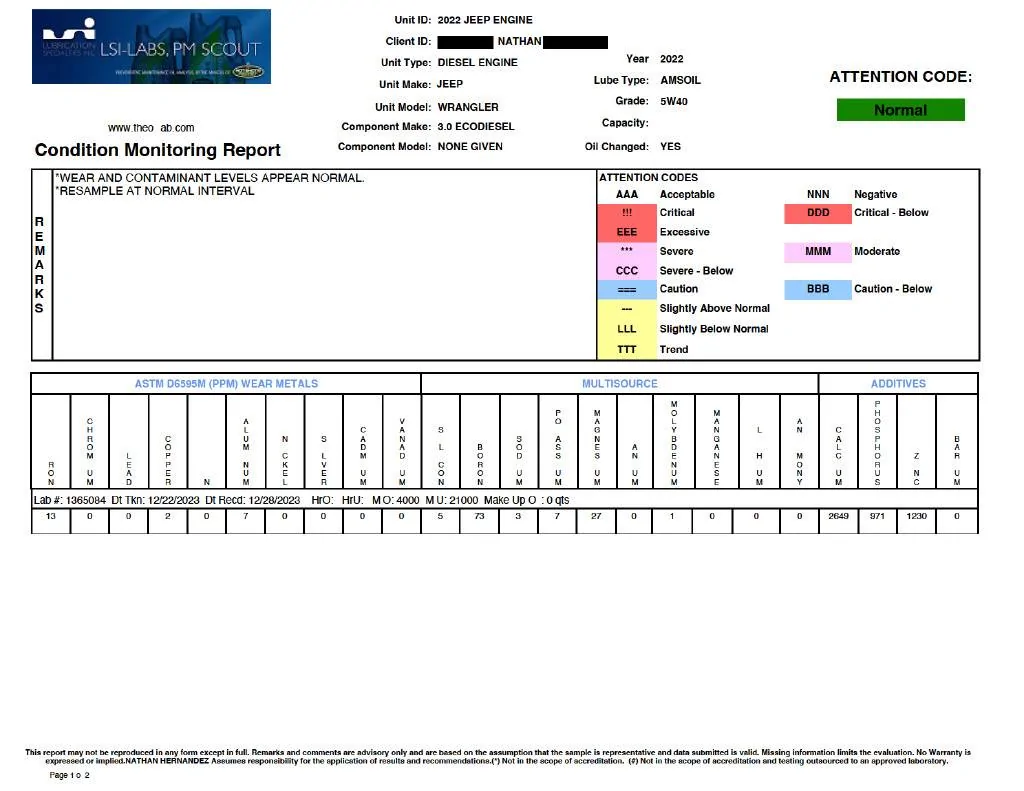

Just got results back for the Amsoil 5W-40 FS Euro. Roughly 21k on the Jeep and 4k on this oil interval. I'm not the best at interpreting these things, but it looks like the Amsoil FS performed pretty solid. Granted, it was only a 4k oil change interval, but with mixed driving of highways and stop-and-go. Will post the Hot Shots Secret 5W-40 MS Euro + Stiction Eliminator results at the next oil change.
Looks like that oil would easily make it 9-10k miles.

Definitely can go longer than what I put it through here. 9-10k might be possible with a ton of highway miles, but I personally wouldn't push it that far. From what I understand from other posted oil analysis results, the EcoDiesel tends to change the oil viscosity to 5W-30 after approximately 6.5k - 7.5k miles or so, depending on the driving habits of the owner. I tend to be more conservative, and since I'm keeping mine for the long haul, I'm doing 5k oil changes going forward.
