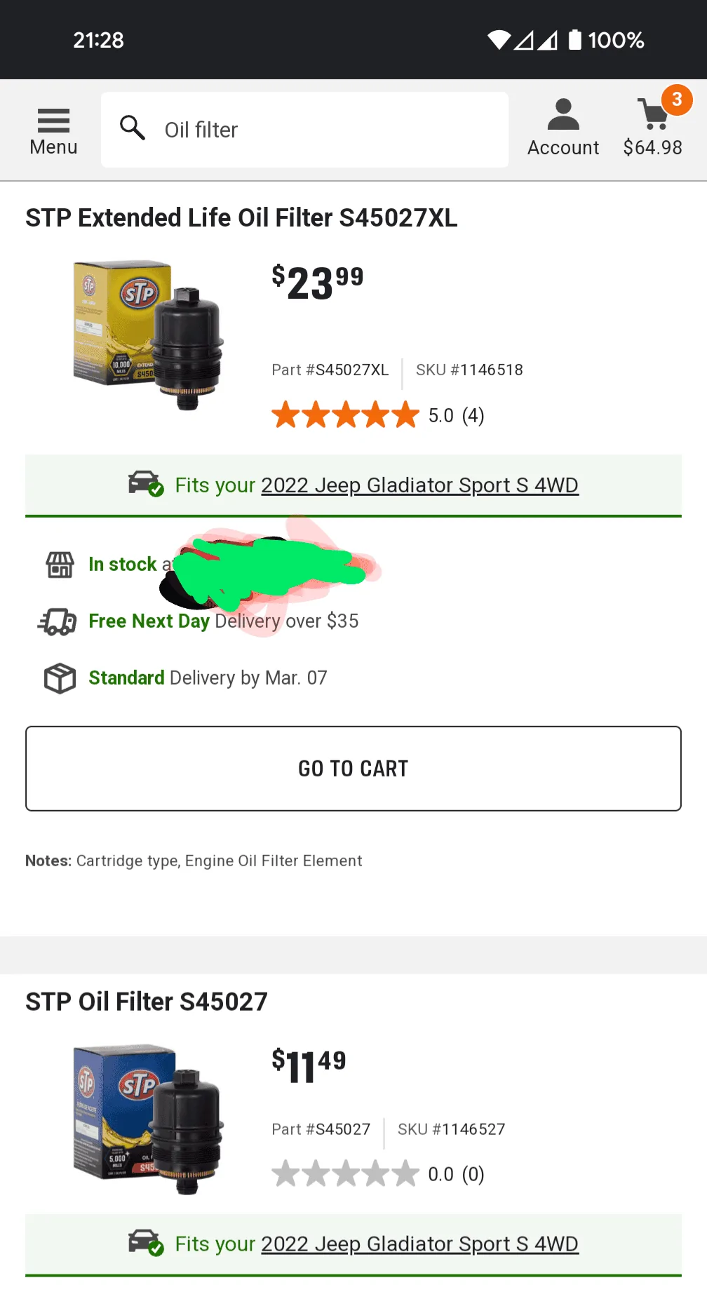

Oil filter options for those that have a local store. I've been running them for 2 oci no pressure issues no leaks.
Jeep Gladiator Official EcoDiesel Oil and Filter Recommendations Screenshot_20240305-212835

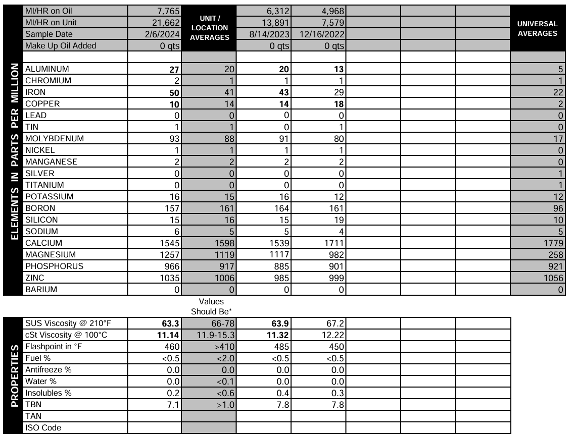

I don't live on the forum and just got my PCM back from GDE to read all this worry about fuel dilution and wear metals.
I have been sending my oil off to Black Stone with the 3 most recent changes. And I've been running the Quaker State. I've also been seeing high wear metals.
I'll be changing to the AFL MS Amsoil.
To reiterate, these results are all on stock tune. Quite a bit of idling in cold ass Minnesota as well, I'll be cutting down on that.
To do the math, most recent oil change went long, and was 6.44 ppm iron, 3.48 ppm aluminum
Quaker State doesn't holdup very well in the Gen III EcoDiesel beyond 5,000-mile intervals and your UOA reports show that.
Amsoil AFL MS is a good oil, though.

I have an honest question: What happens if you send your oil out to the lab and its abnormal? If you've used the proper oil type, filter, and interval what are you really going to change?
It seems like a waste of money to me, if a bearing is eating itself its not going to stop because you change to quaker state or stp filter. I just dont understand the process? I could very well be wrong, please educate me.
If the results are bad are you going to tell your engine to stop doing that! Its a confusing waste of money imo.
Let me start off by sharing what we've learned due to oil samples being collected. For one, we know that high aluminum wear is due to tuning. OE tuning in the Ram increases aluminum compared to factory tuning in the Jeep. We know the 3rd gen engine is really hard on oil, therefore owners now know to shorten oil change intervals or change to an oil that holds up better to shear. Due to a large number of data collected, we now know which oils hold up better in the Ram or Jeep application.
Going back to your question, the purpose for monitoring the condition of the engine is so that owners can make adjustments before premature failures occur. For example, we discovered that the early GDE tune was causing fuel dilution, which significantly increased engine wear. Owners took action and stopped running the tune and GDE was notified of the issue. GDE later revised the tune to help minimize the fuel dilution problem.
Some EcoDiesel owners have been able to prevent engine failures by discovering fuel dilution due to a fuel injector failure. Others have discovered a head gasket leak before it became a complete engine failure.
Taking oil samples is like pulling blood to send off to a lab for analysis. It's a way to diagnose possible issues so that people can take prevention measures.

Hi, I'm new here and just want to better understand the oil situation, since the dealer robbed me once. I've been using pennzoil euro and oem filters.
I just got my diesel and am also very interested in which Oil is the best for these engines as well.
Amsoil AFL MS is the best oil I've seen for the Gen 3 EcoDiesel.
